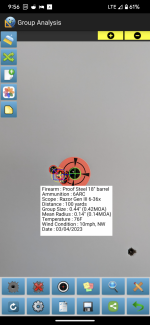

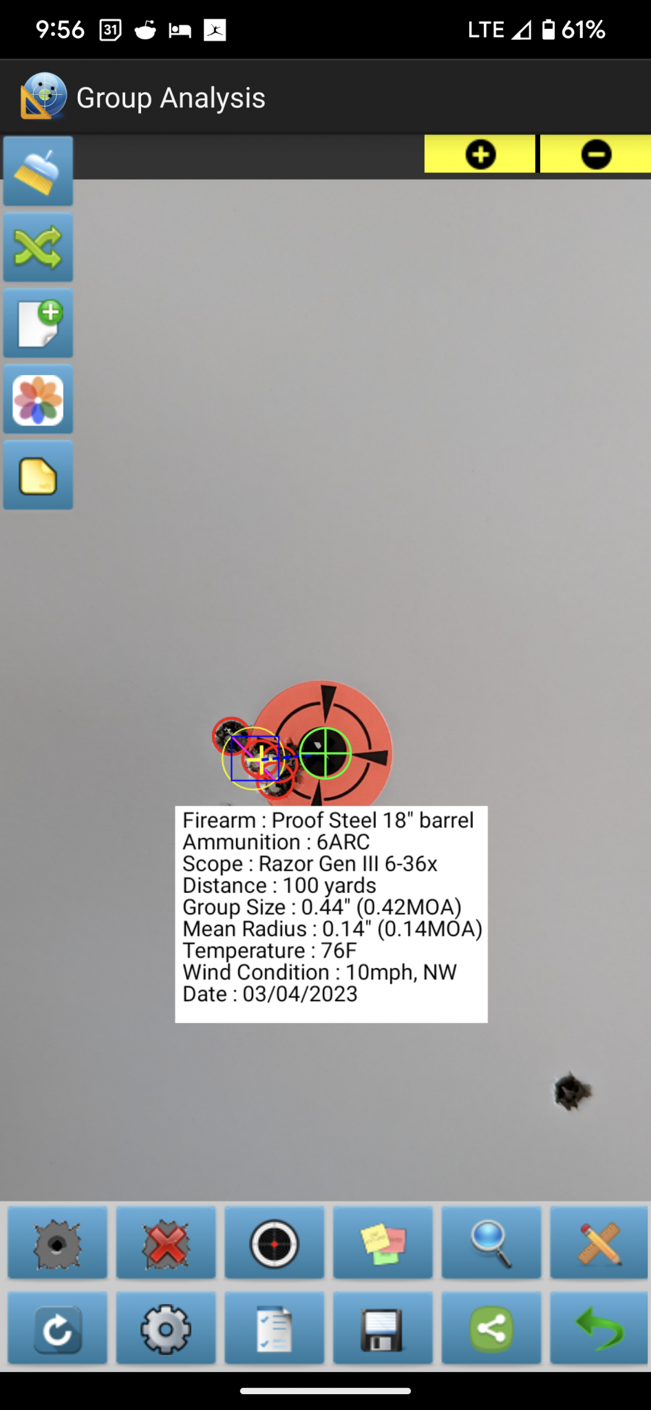

I run a 18” proof. I put a few down it. That’s how my stainless proof 6 arc shoots rounds 21-25. I am moving that to my DMR roll and getting a 22” bartlien to be my fun long range gun. I love this round. I got 1k 6.5 grendel starline brass to convert.
