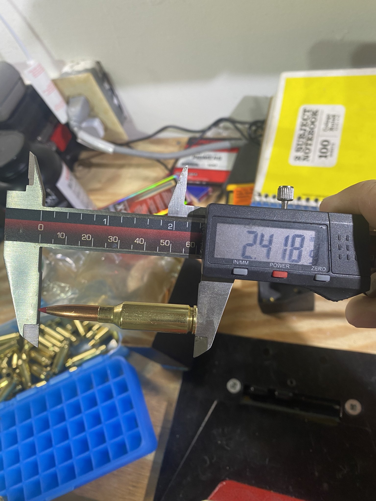

I've been struggling with accuracy out of this barrel with both factory and hand loads. Quit on the project twice on a count of this. Decided to revisit one more time.
Comparing my freebore to others online I have a problem/question. Using a hornady tool, for example 103 eld -x coal to the grooves is 2.445. Insanely longer than anyone I've seen online. Loaded at mag length, I means they're jumping almost .200. Obviously the shorter V-max and Berger hunting bullets are jumping even farther considering they're loaded shorter to begin with.
I have confirmed that a 103x seated at 2.420 chambers without touching the lands. So it is t error in measuring.
Any thoughts or has anyone else seen this in their faxon barrel?
