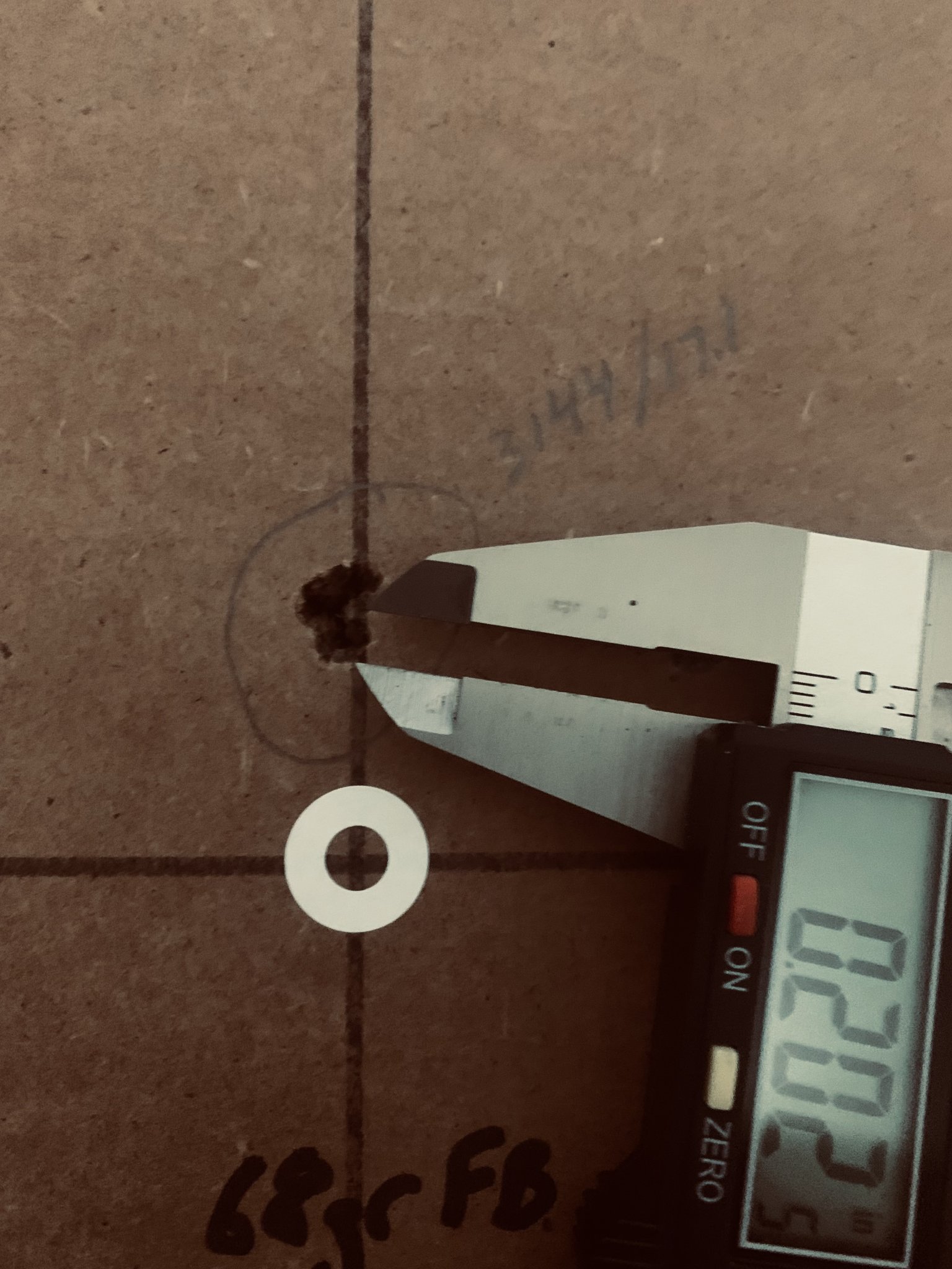

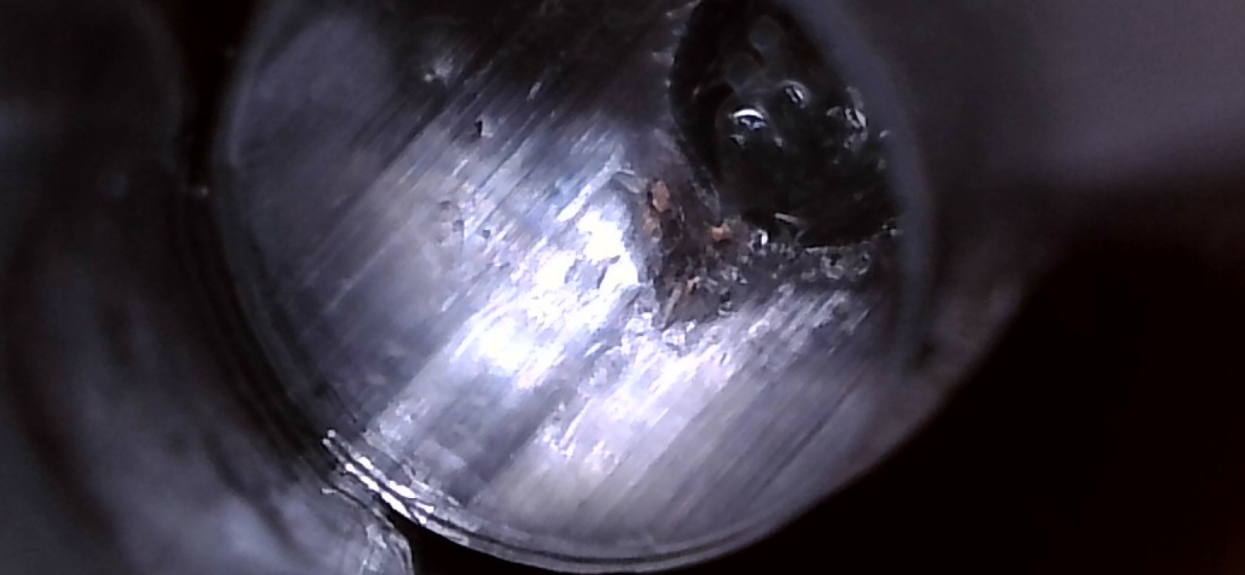

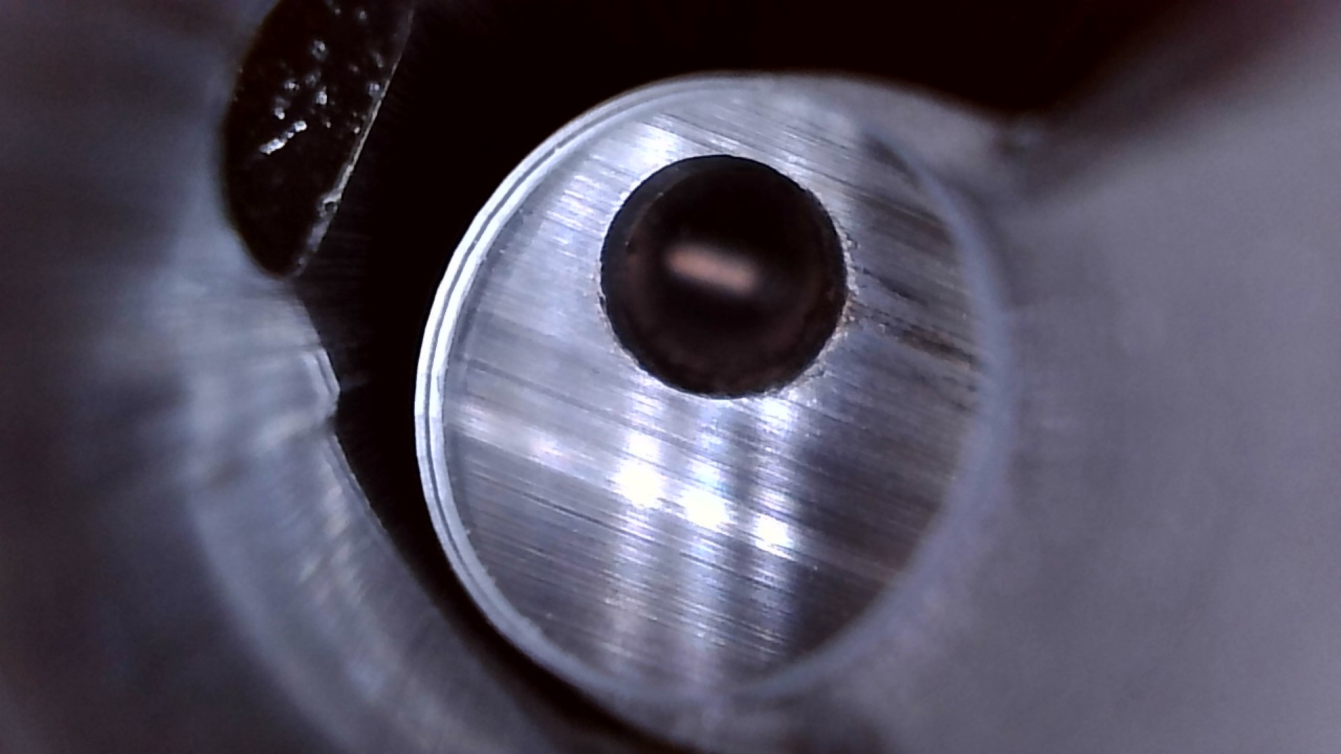

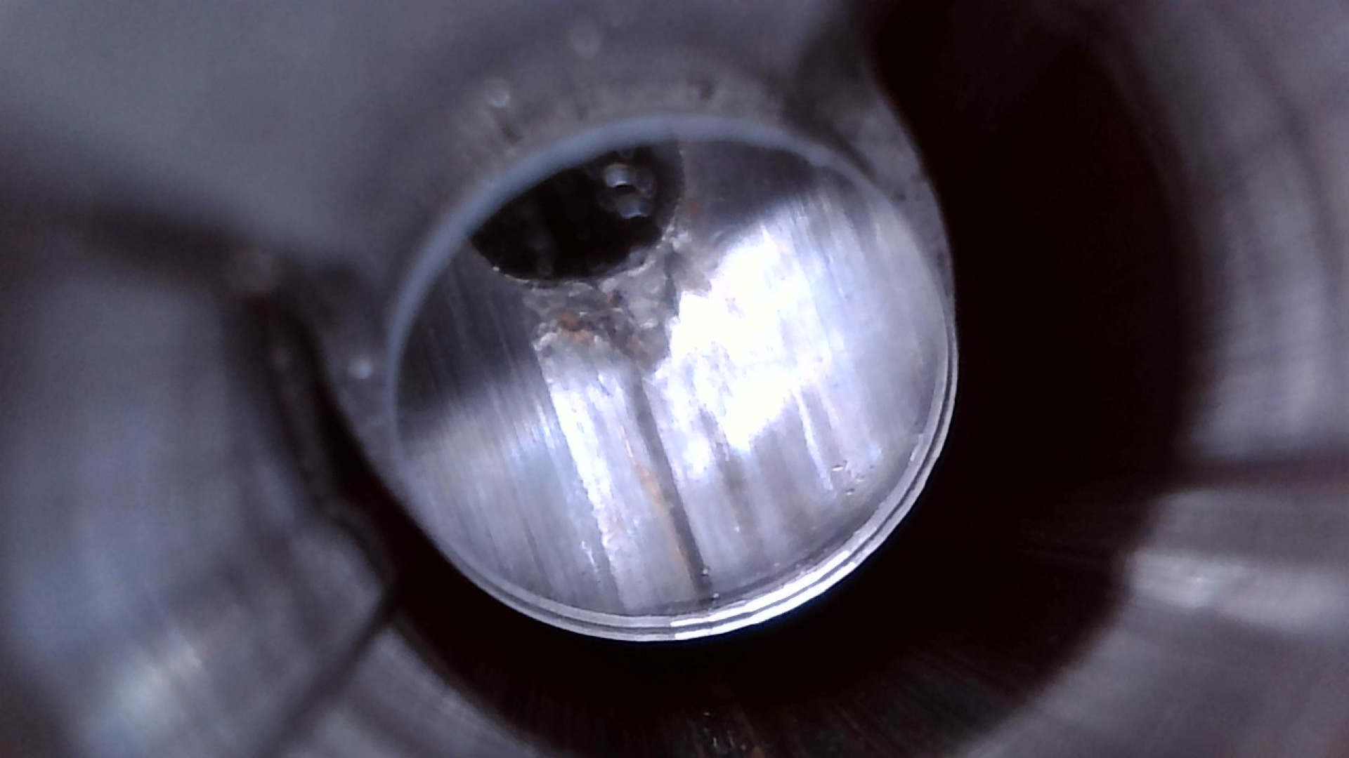

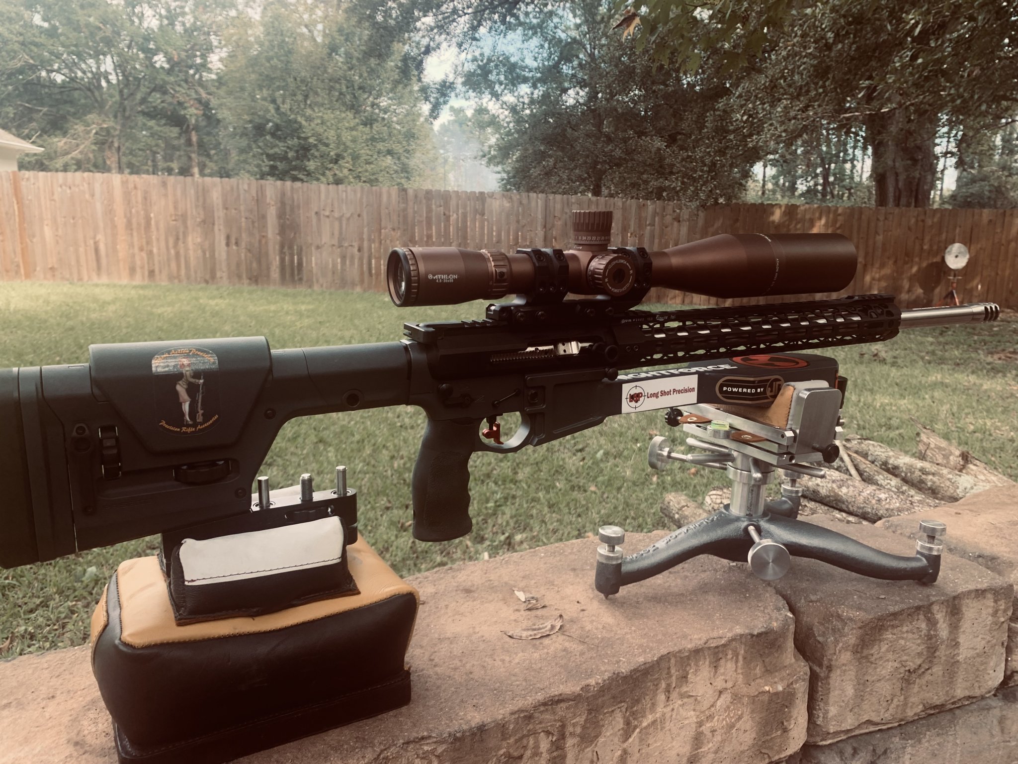

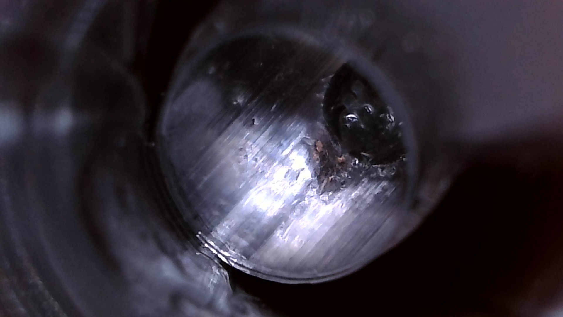

I have a 22” Bartlein 6mm ARC AR. It is a rifle +2 gas system. I purchased the barrel and bolt from Precision Machine in WV. I have about 400 rnds through the barrel and get mediocre accuracy. The port fell on a land and it’s giving serious erosion issues. I believe that it is so bad that I am getting bullet deformation. I post here to have some experts give their opinions, maybe I don’t have an issue, please help me decide. I chose 6ARC for a precision auto loader build due to its resemblance to my 6BRN and PPC cartridges. I will post a picture of the build and some development targets shot at 100m. And some borescope photos. I appreciate you gentlemen and your knowledge. Thanks for your time.

Judging by the lack of copper buildup, at the gas port, I don't know if the bullets are deforming.
And those groups seem pretty danged good to me, especially given the various charge weights , powders and bullets.
I would carry on.
Reactions: matt33 and Jsp556

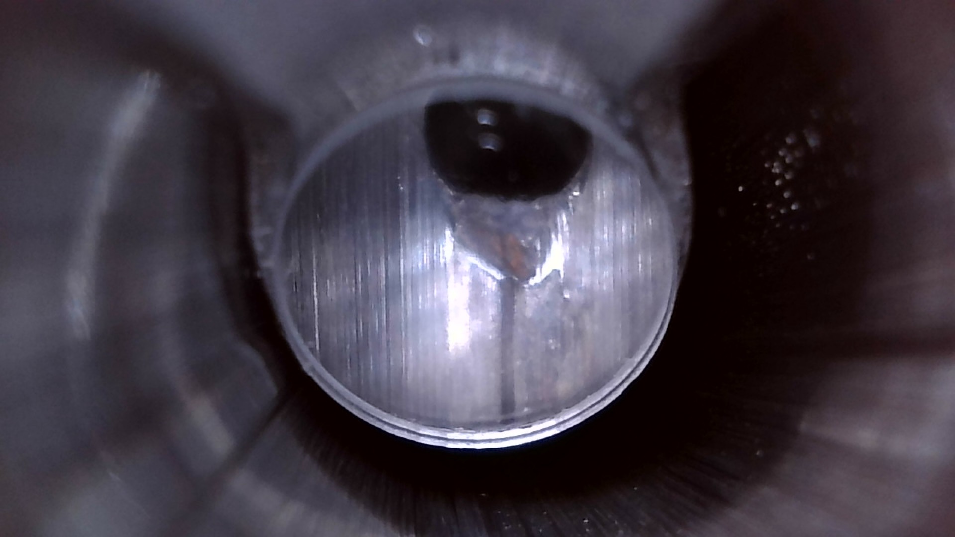

That port doesn't look horrendous. It does look like it has carbon and copper in it. I'd probably scrub it out a little better and then patch the whole barrel with a light abrasive paste, focusing on the port area. The groups look good. What do they look like after 20 or 30 rounds? Do the groups wander when hot or fouled?
There's nothing wrong with your Gas Port, it just looks bad because it's on the dead center of a land. Keep shooting the barrel and it will eventually break in making a smooth transition.

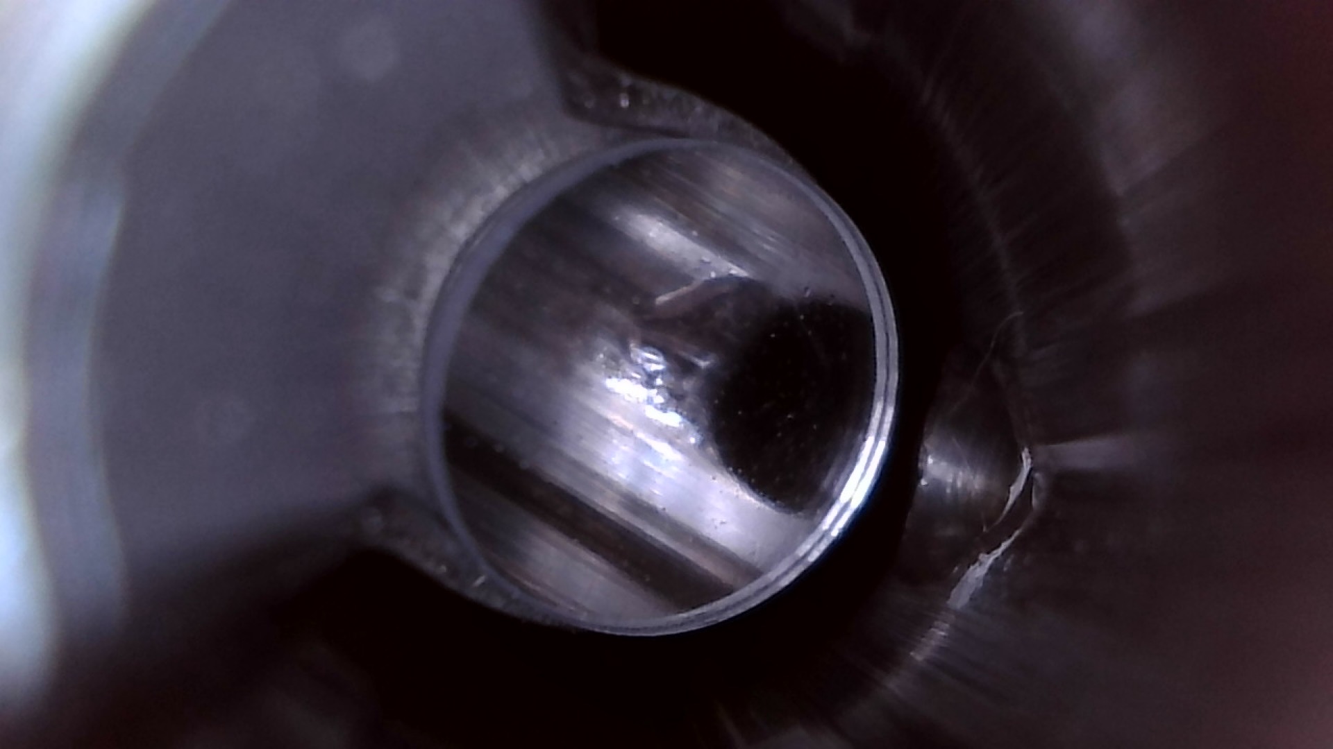

But this is also the reason I only use 4 Groove Bartlein Blanks, it's so much easier to put the port in the center of a Groove.

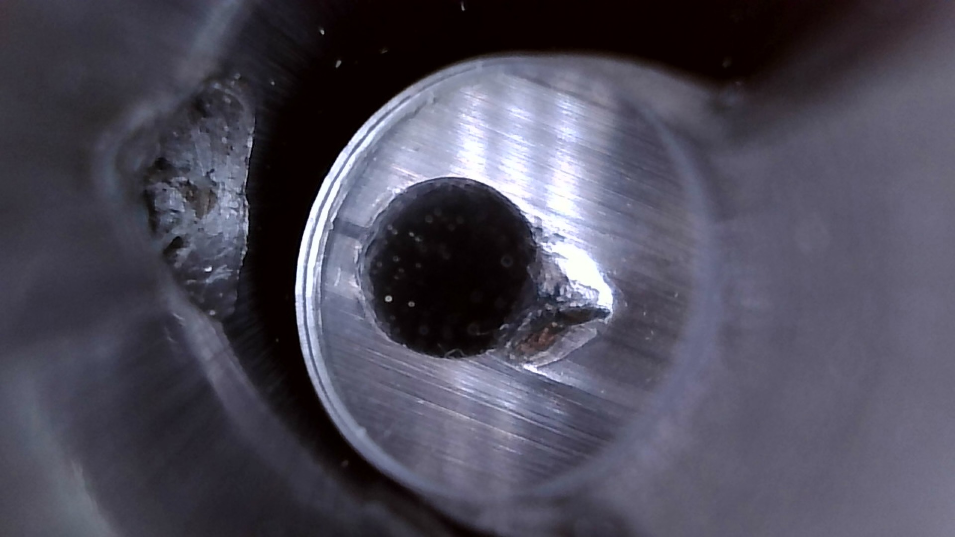

It looks like it started out like a large burr from from drilling the gas port.
Like the one shown.
It Broke off leaving a ugly spot on the edge of the gas port.
It has been lapped in that area and appears someone tried to deal with it causing it break off.
Doesn't appear to be a big deal at this time.
One can drill it out larger dia with a new sharp drill and cutting oil, as I did with this barrel's gas port, cutting off the burrs first, without trying to champher them off as one edge appears.
Then lapp, so as not to break off the small burrs.
Then add an adjustable gas block, to deal with the larger diameter gas port.

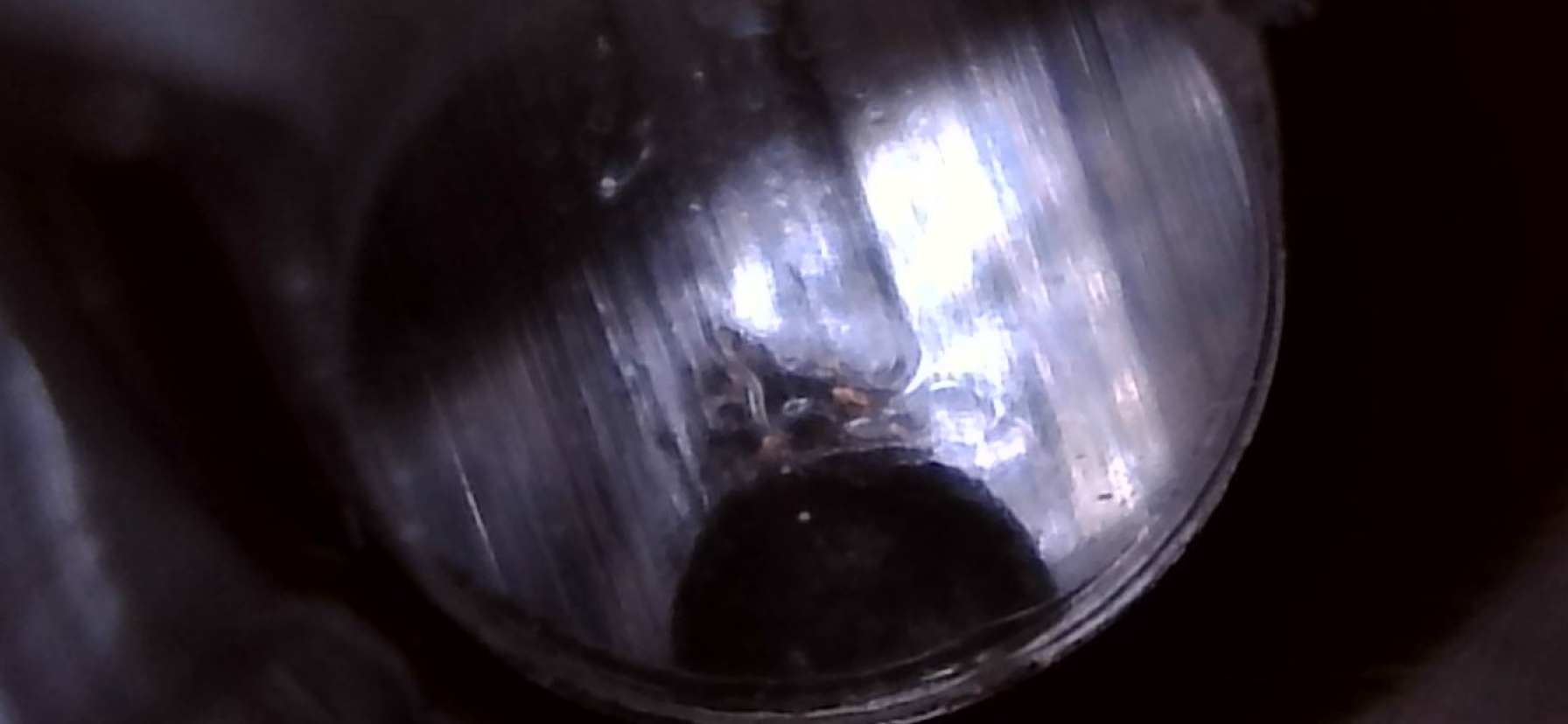

Thanks for your advice. I have addressed most of those issues and continue to test new powder/bullet combinations. I seriously addressed the barrel nut/handguard pressure by welding a bag rider to the lower receiver. The upper is lapped and thermo fit. I appreciate your input.
Sir, I shoot some pretty long strings and don’t see poi wandering. I am worried about one area in particular and will certainly some abrasive on the port. It appears the land is rolling up towards the muzzle, creating a lip. Thanks for your advice.
Yes sir, I will continue shooting it. It’s a 4 groove Bartien, also. I guess the shop that finished this blank wasn’t concerned with that detail. I have the same barrel in 6.5Gren from them that is in the groove, I was expecting that for this barrel too.
Like the one shown.
Sir, thank you for listing the options. My concern is the land rolling up into the bore. I was hoping it would bevel itself with firing. Now I want to try to lap it out with abrasives. Possible?

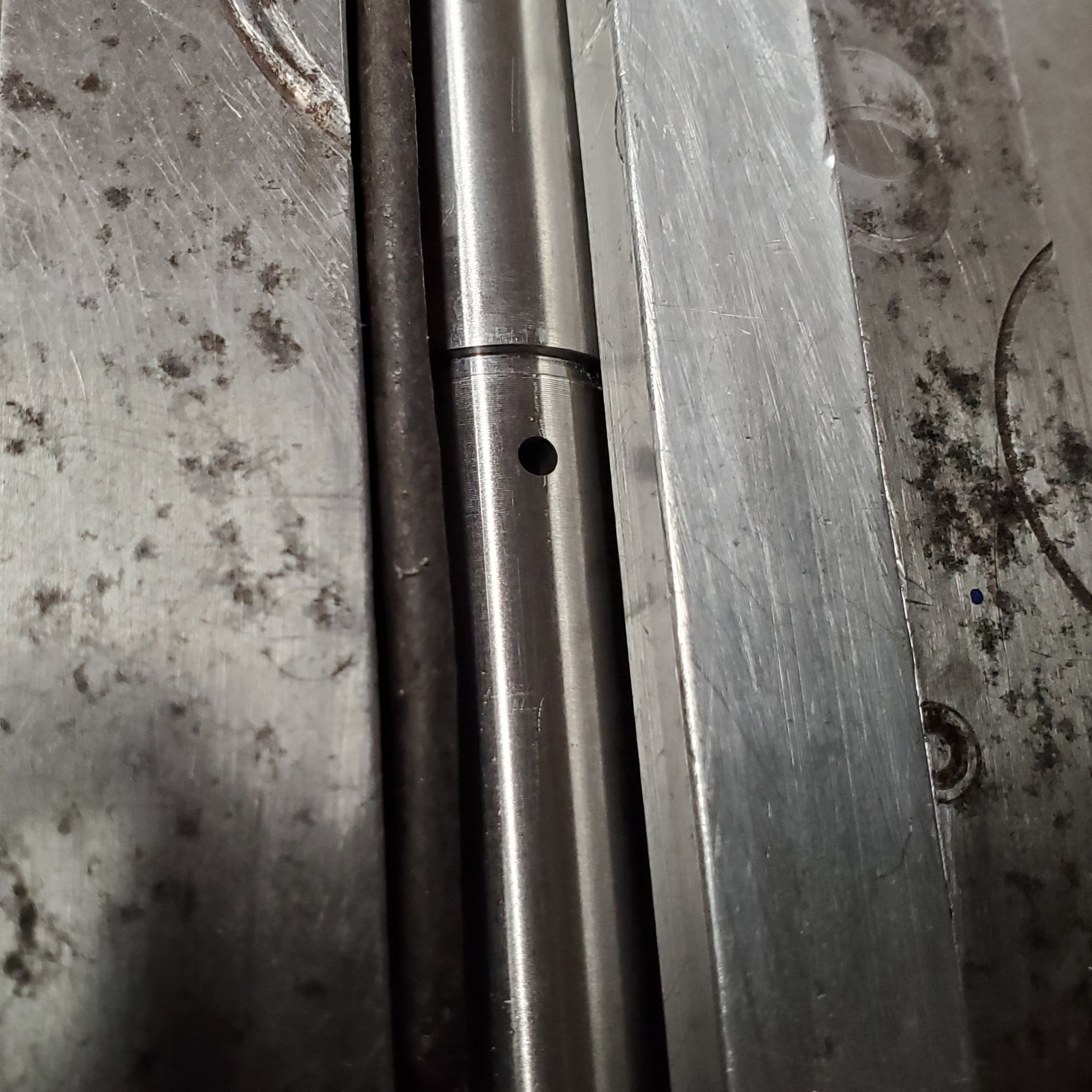

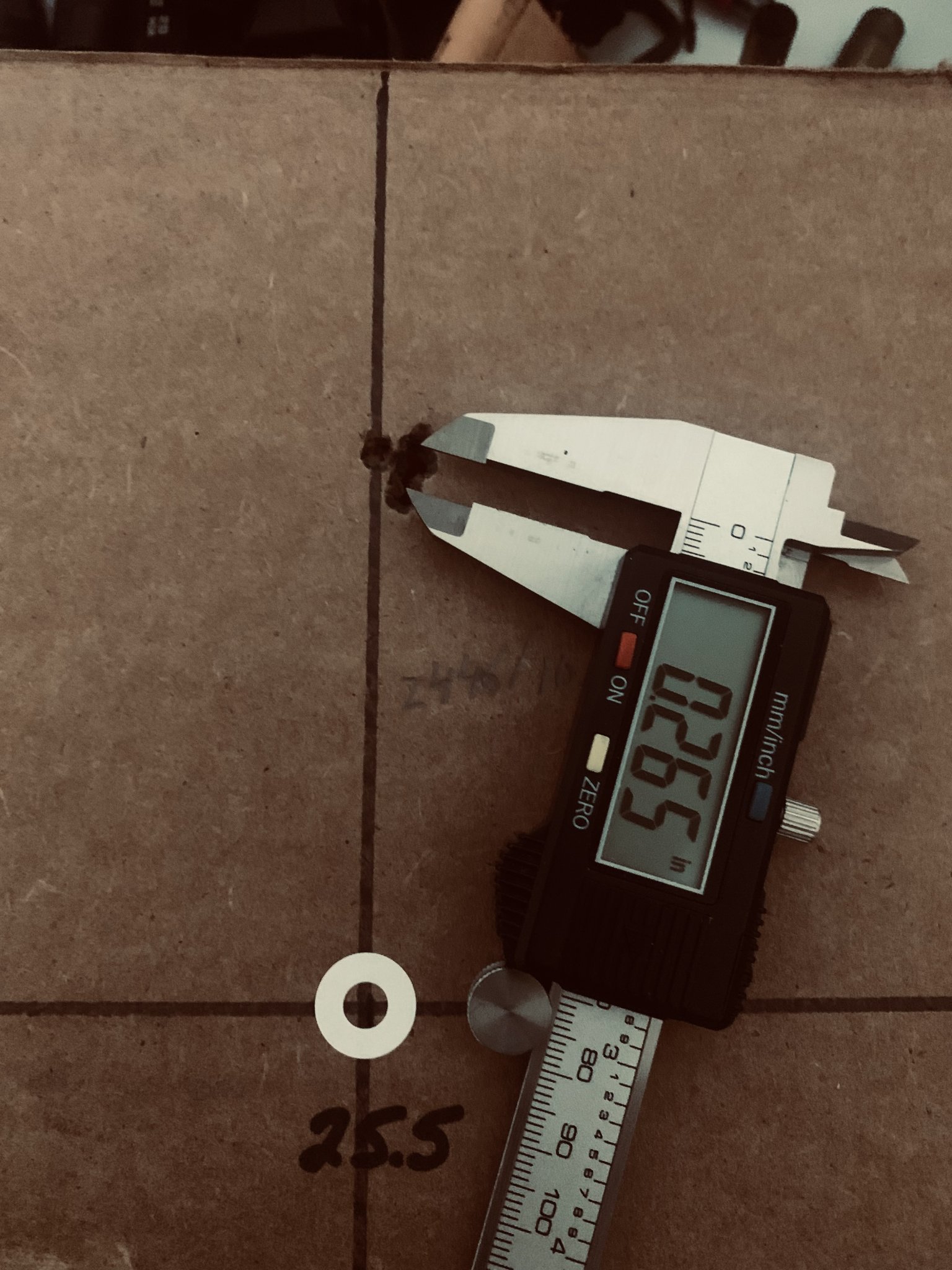

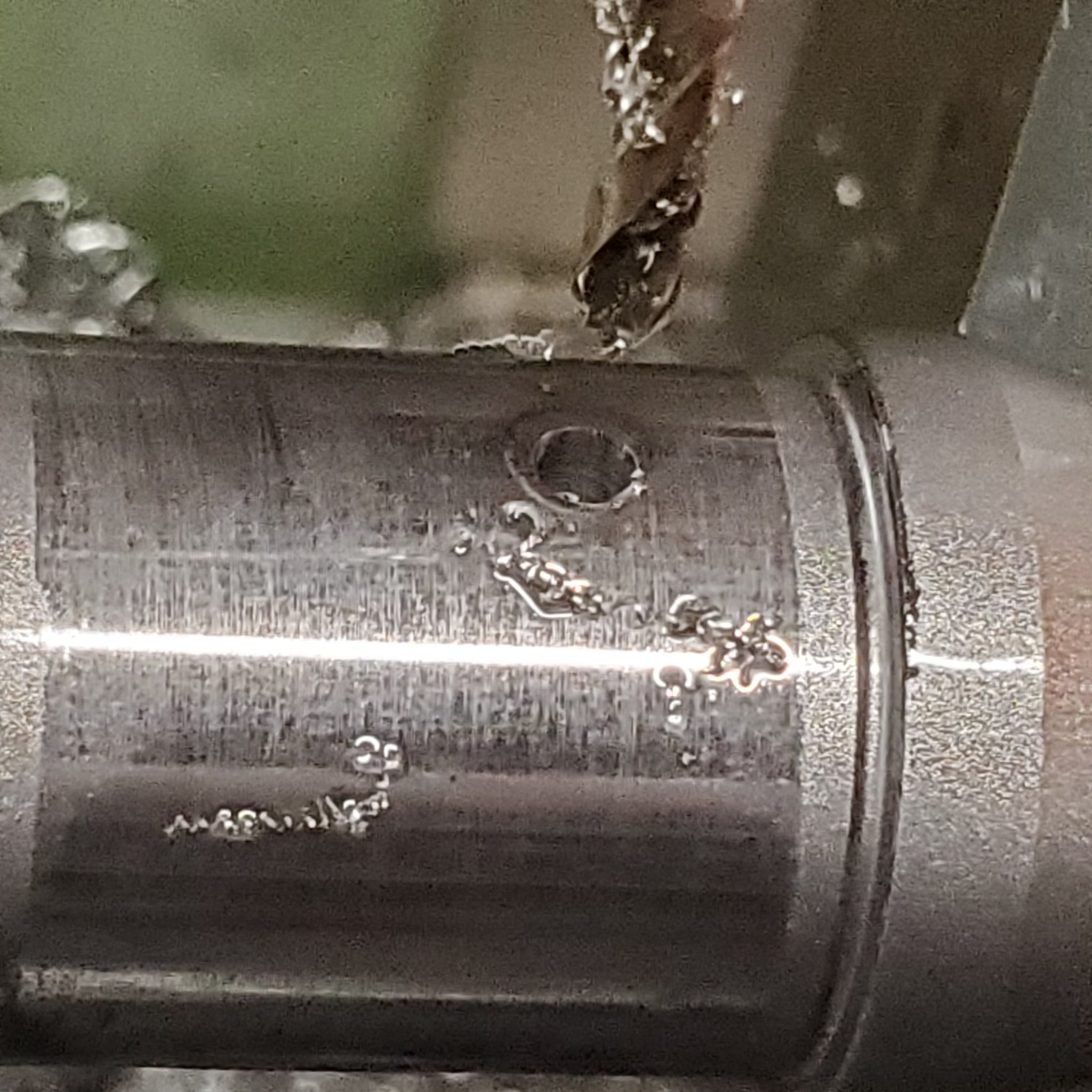

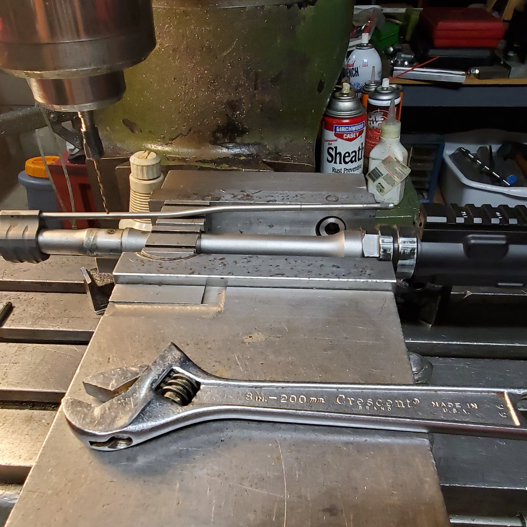

What I do is use number drills to find out the size of the gas port, or gauge pin.
Say its .089 #43 drill. Then redrill with .0935 #42 this cuts the stubborn area and leaves a fine burr on can easily lapp.
It looks like this set up in mill for drilling, use dark heavy cutting oil at moderate speed slow feed and a new sharp quality HS drill. Then lapp. This works. Adjustable gas block can be added if necessary.
Also can be filled and redrilled but that should not be necessary.
The gas port location on the rifling form is a non issue, the bullet has already taken the rifling form sealing the bore. If it's half bore half lands its just as good as if it were centered in the bore groove or land. The physics doesn't care...as long as its smooth.
The gas port location on the rifling form is a non issue, the bullet has already taken the rifling form sealing the bore. If it's half bore half lands it’s just as good as if it were centered in the bore groove or land. The physics doesn't care...as long as it’s

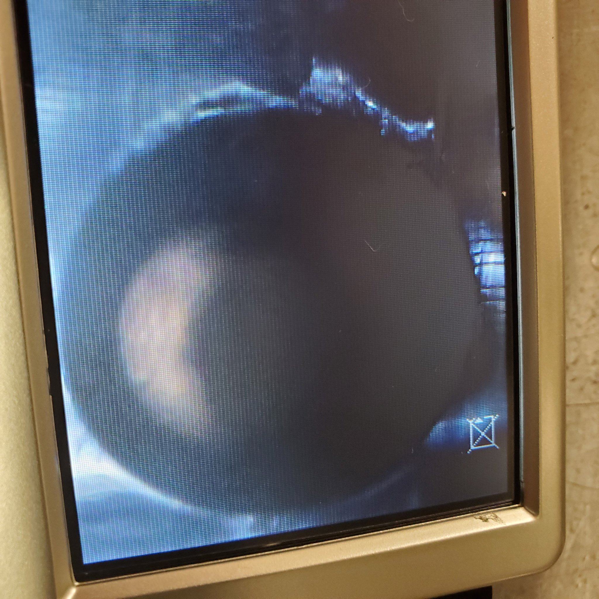

I looked at all my gas gun ports, .308,458,.300s, 5.56s, 6.5 gren. I don’t scope them regularly like I do with this 6ARC. This 6ARC is by far the ugliest. Any idea of the root cause?
The cause is a dull drill, too fast on the drill feed, swages metal as it breaks through into the rifles bore. I bore scope every gas port, and lapp the area before ever firing a shot.
take the mirror off the bore scope and take a couple pics from each side. That will show if the edge is rolled up. I don't think it is. I had a WOA barrel that had a way worse erosion in 40rds than that. It was double the size. Mine would grab a patch as you pushed it through the bore t the port. That was why I scoped it. Then it went from shooting 1/2 inch groups to 1.5
groups. They gave me my money back after I shipped the my upper for them to test and look over. All they said was it did not shoot like they like.
Yes, lapp it. The gas port has small burrs around the edge...I lapp them all.
This is an example of smaller burrs and more typical of what one would expect.
New to this - how do you lap this area?
You need to know how bad the burrs on the gas port are.
Bore scope it out.
If its bad, I set up and drill the gas port to the next largest size, with a new quality, sharp drill with dark heavy cutting oil.
This removes the heavy burrs.
Next you lapp.
I use a fixture that fits over the barrel extension centers the rod in the bore and can not flex, and has a stop nstalled & adjusted, to limit bore travel so ya don't exit.
The barrel is held in aluminum jaw, with V block, in a Bridgeport milling machine vise.
The type of lapp depends on what you have left to remove...polish off tiny burrs, or something more aggressive.

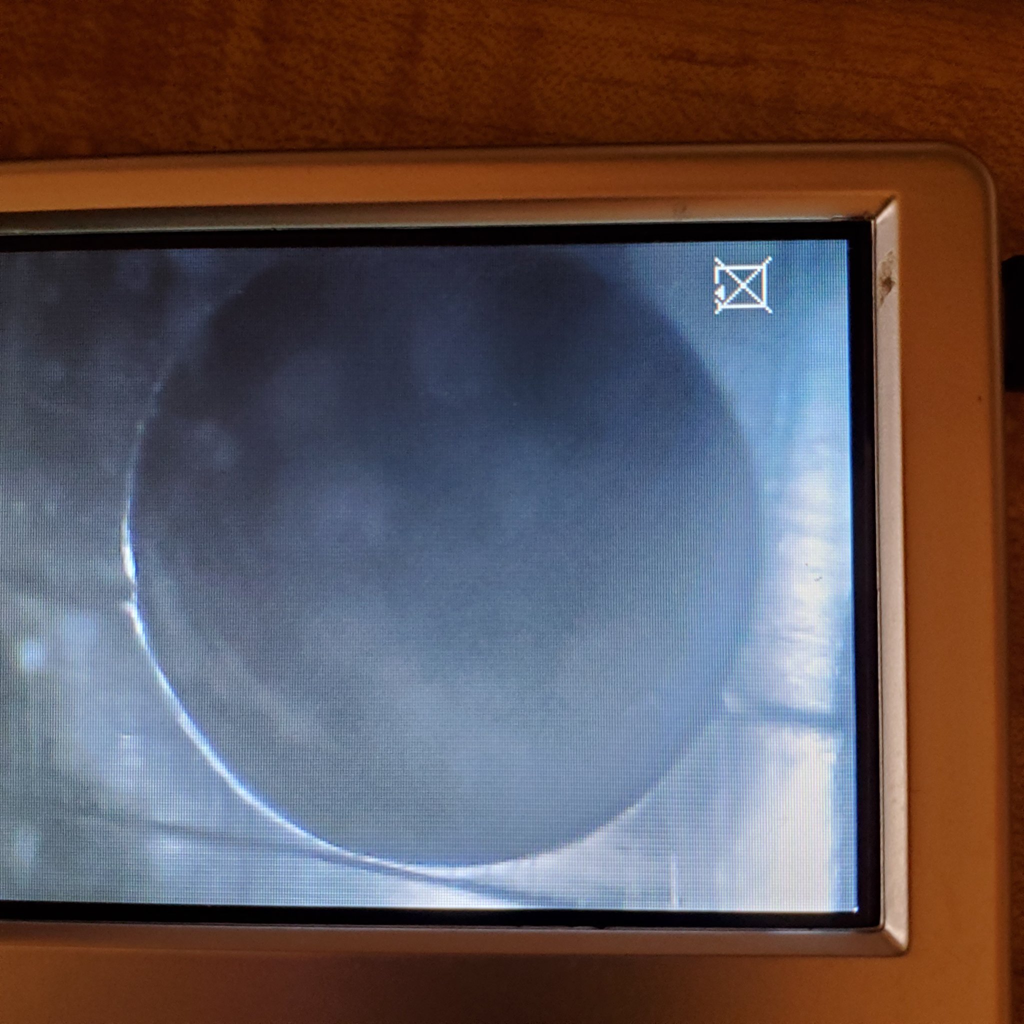

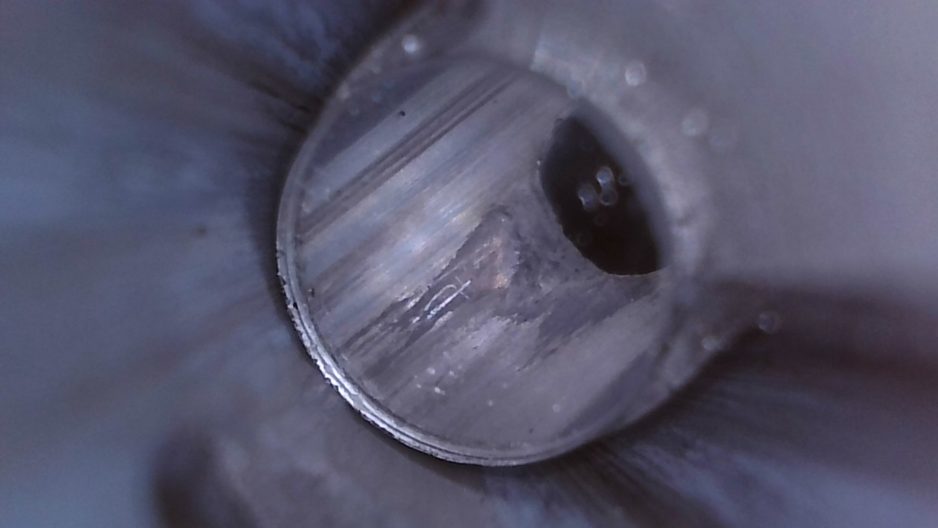

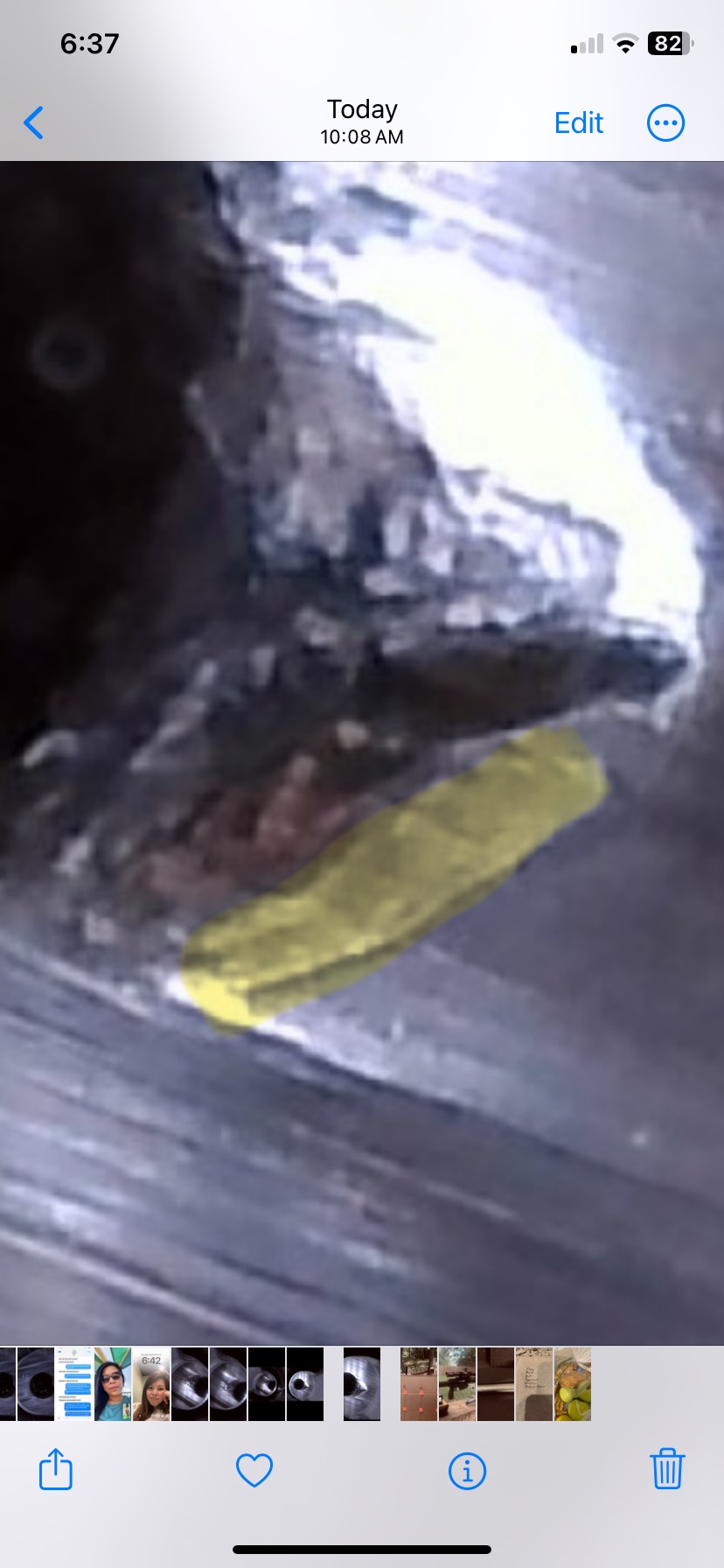

I took a new batch of loads to the range today. Shot about 50 rounds. I am not pleased with the groups, not bad but I didn’t put a 22” Bartlein on to get mediocre accuracy.
I put a bore scope in my barrel when I got home and again after I cleaned it.

Honestly, I’m about to rebarrel this rifle. I will order a barrel from a shop that guarantees the port in a flat. I appreciate those who told me to be happy and shoot but that detail is always in my head. It’s like having a car that is running 11 second times but was built to break in the 10s. This gun is shooting .5-.8s and I want .2-.4s.
I tried to scope it without the mirror as you suggested. My cheap scope doesn’t work well like that. Horrible photo quality. I think that the presence of copper in the port indicates bullet jacket deformation. I took a couple more photos. Lmk what you think. Thanks

don't lap it anymore. Just shoot it. You already went too far. It should have cleaned up just by shooting it.
I just finished lapping my new 338 Spectre barrel yesterday.
Ya need to learn to do it correctly.
It does not matter if the gas port is located in the lands or grooves or in-between, but being deburred is important.
No burrs....
First determine how bad it is.
May have to cut swaged up and heavy burrs off with a sharp drill, with cutting oil.
A lapp won't cut it, but make things worse.
Build a ficture for lapping and guiding the rod so it can not flex.
a stop is fixed to the rod to keep it from exiting the barrel muzzle, the tightest place in the bore of your barrel.
Super tight Kroil patch, smack it in with a gloved hand.
Add silicon carbide lapping compound through the gas port hole in the up position, add oil too. Work this area of the gas port.
Then the whole barrel but the muzzle, less energeticly and finish with Bore Bright or Iosso paste getting the gas port area special attention, then through the whole barrel. Blow with compressed air the residue left in the gas port flush and blow again.
Clean your barrel. Done
You should have already polished the feed ramps prior, with a cleaning patch in the chamber so ya don’t get fine stuff ya don't want in the chamber.
