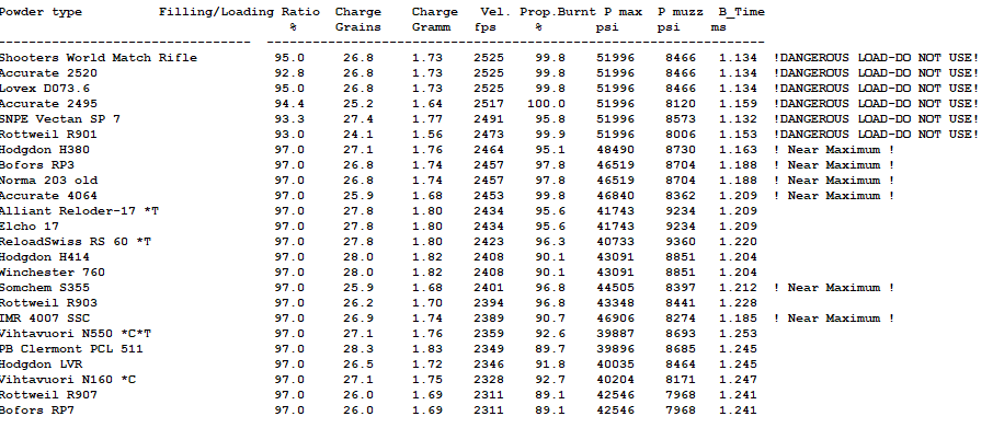

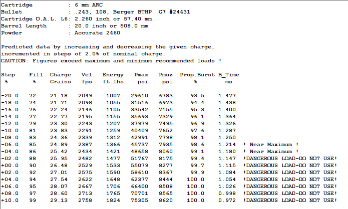

Quickload predicts that AA2460 is too fast for that bullet. Look at the fill %'s. You really want to aim to be in the 90s somewhere. The 80s is not good and the 70s is dangerous. AA2460 in a 6mm ARC is better suited to bullets in the 60-70gr range (which isn't ideal for that cartridge).
Using a 97% fill rate, here you can see some better options for 108gr bullets like AA4064 or RL17
