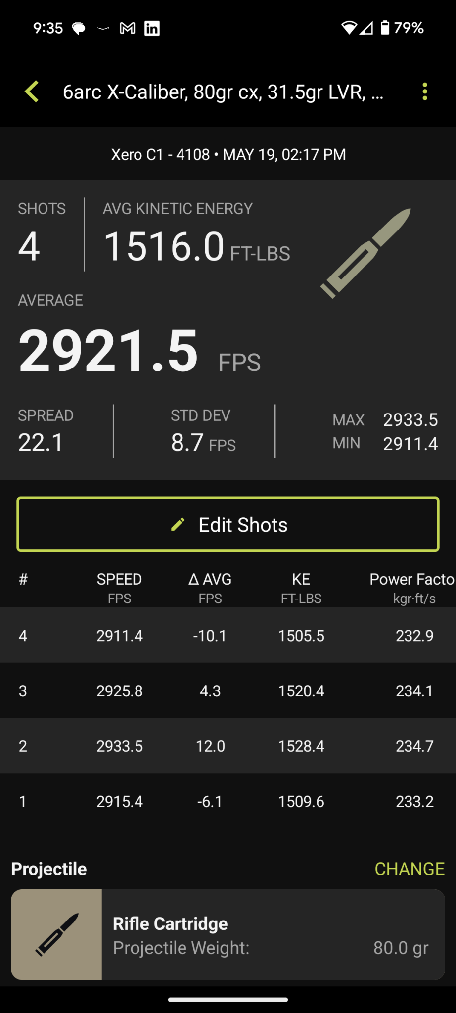

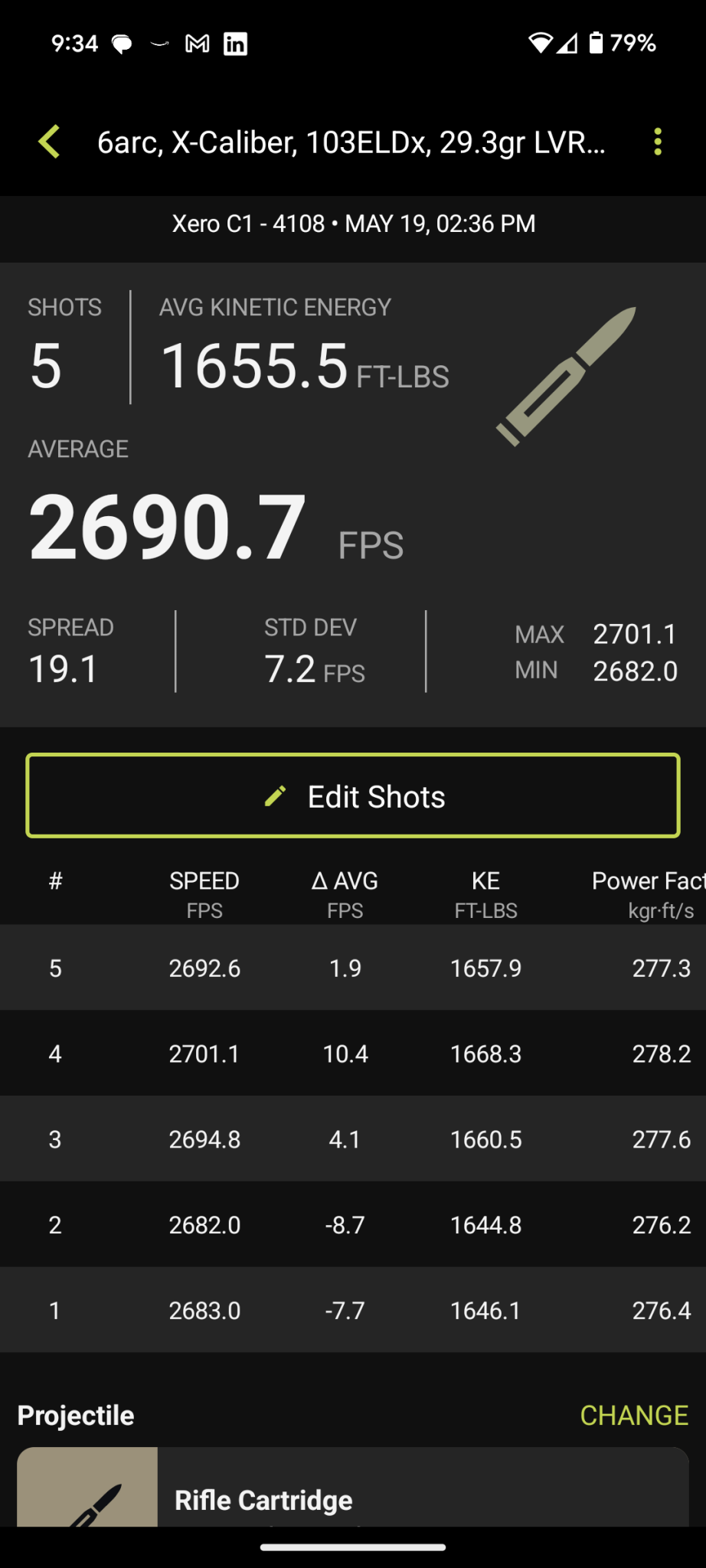

LEVERevolution (LVR) is probably the best optimized powder for the cartridge, giving the best balance of velocity/pressure. It’s dirty AF though, especially suppressed, but that’s a small price to pay for performance.
CFE223 is also in the same zone though not quite as popular.
I’ve tested a lot of different powders for 6ARC shooting 95s to 110s and LVR basically works best across the board. If you wanted to choose a powder that was also good for .308WIN, for example, Varget and TAC are decent options. I didn’t get great performance out of them, but not bad. N540 kind of surprised me how well it shoots, though velocities were about 100fps slower out of a 16.5” barrel.

For my ARCs, I really like LVR, it's usually available, gives top velocities with the 80gr and up bullets I've used, and excellent accuracy. It isn't temp stable, but I haven't had major issues from that yet. I have burned some Staball Match in the ARC and it does well too, gives up some velocity to LVR though, which I guess is to be expected since it's in the faster Varget burn rate range.
LVR in my hunting loads loads for my LW 18" hunting ARC: (that ~29.3gr load range has has worked very well with several different bullets 100gr to 108gr, seems to be a sweet spot)
