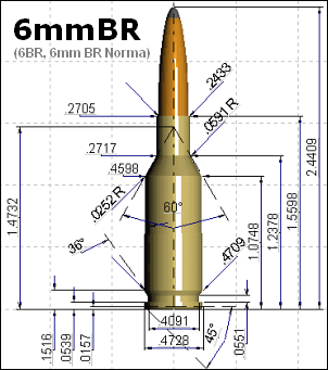

I’m fire forming 6 br Lapua brass to 6 bra. I’m using varget. What weight should I use to fire form? I was told 28-29. Is 28 to light?
Also does anyone have a diagram for 6 bra? I could only find 6 br online.
I’m looking for something like this but in 6 bra
View attachment 7893794I’m fire forming 6 br Lapua brass to 6 bra. I’m using varget. What weight should I use to fire form? I was told 28-29. Is 28 to light?
I use 29 of H4850, so you can go higher than 28 of Varget. 29-30 would be fine. As to the case diagram, everything is the same except the shoulder-body junction, which is higher up on the BRA due to the shallower shoulder angle. The length, neck-shoulder dimension, etc. is all the same.
EDIT: Assuming 105 gr bullet or so.
