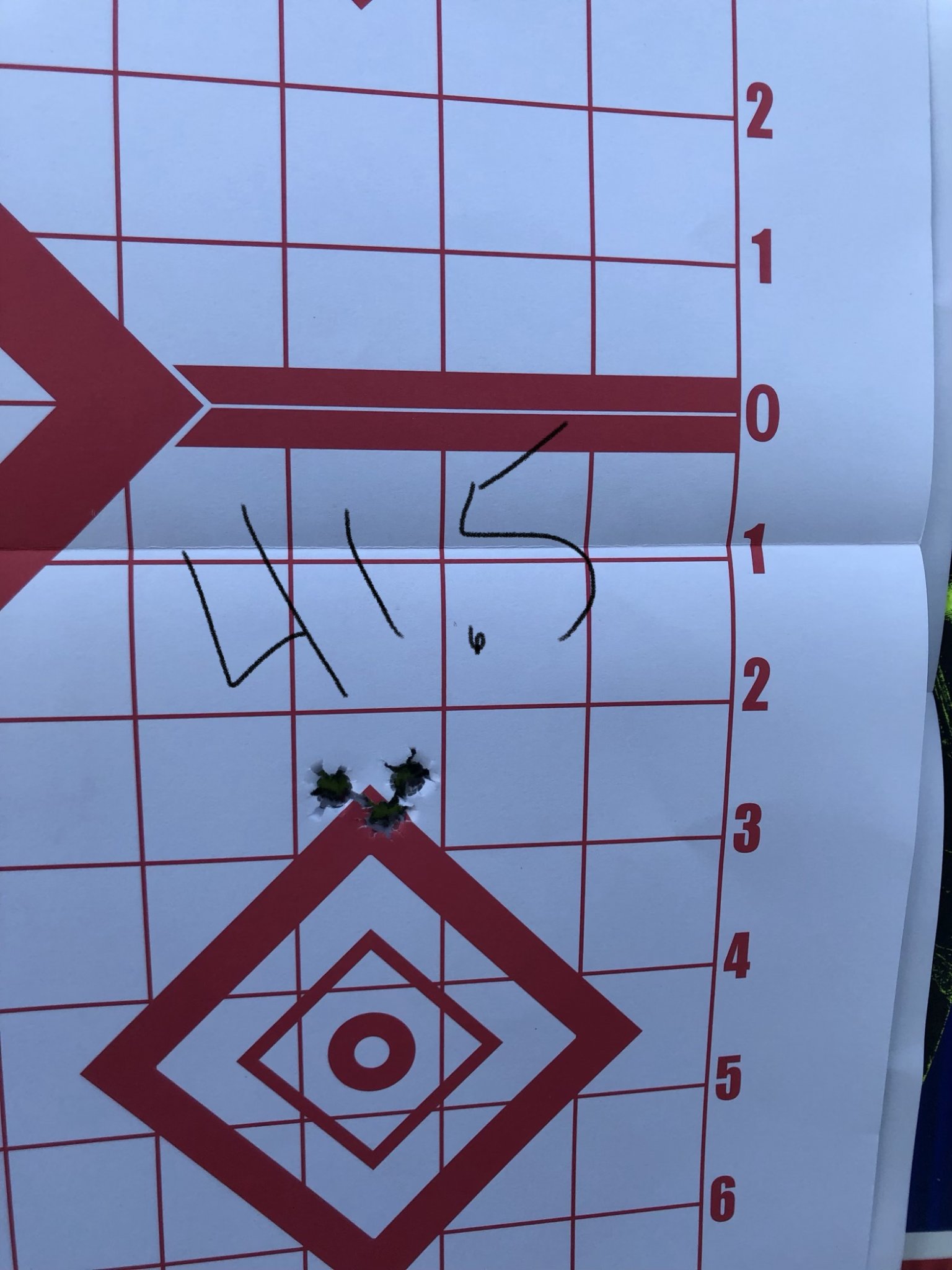

lapua brass necked down.
40.5 H4350 2.215BTO
2990 FPS
26” rock creek 7.5twist
300yrd group 5shots
This is a prefit barrel spun up by PVA. 150FB

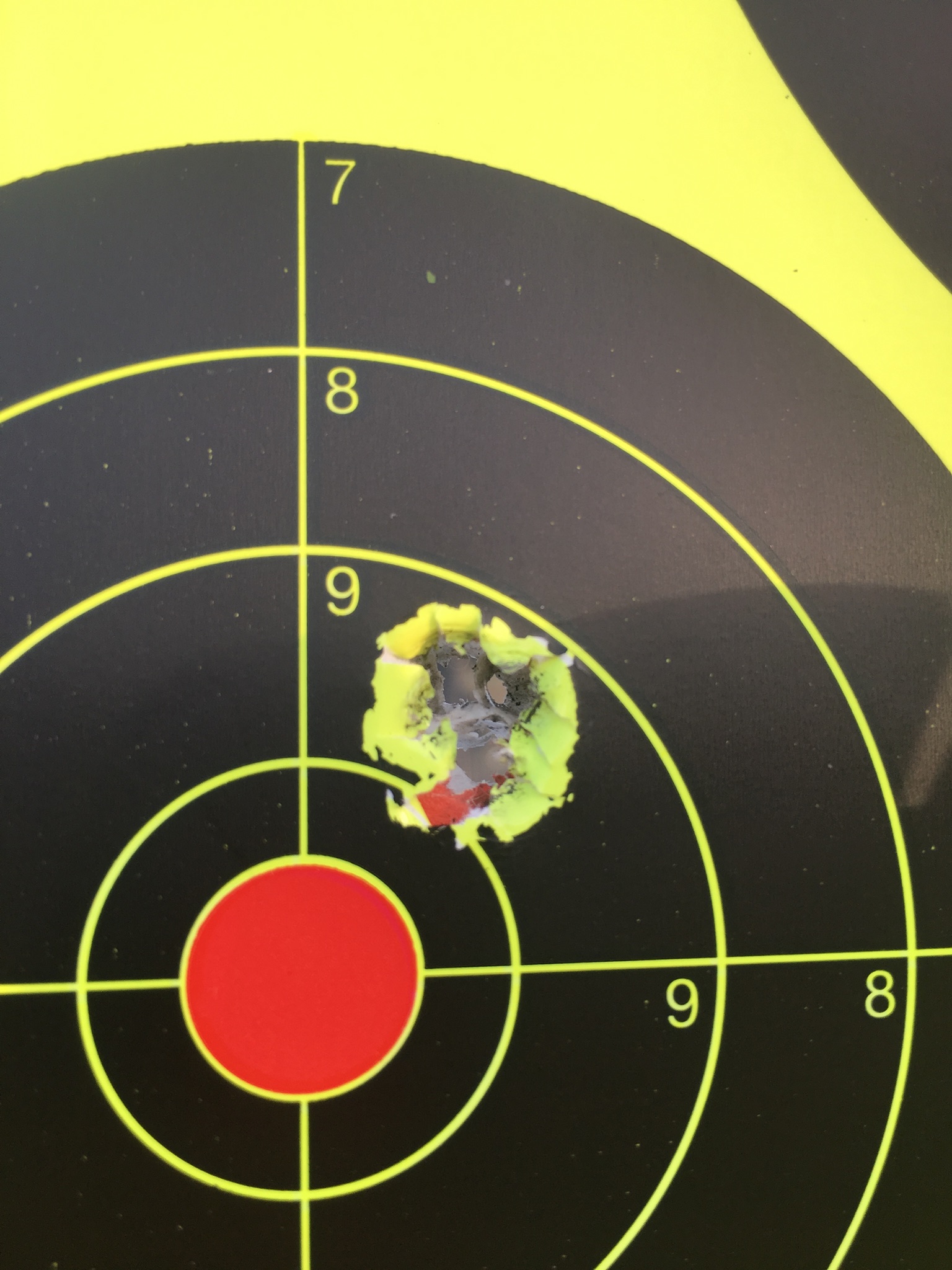

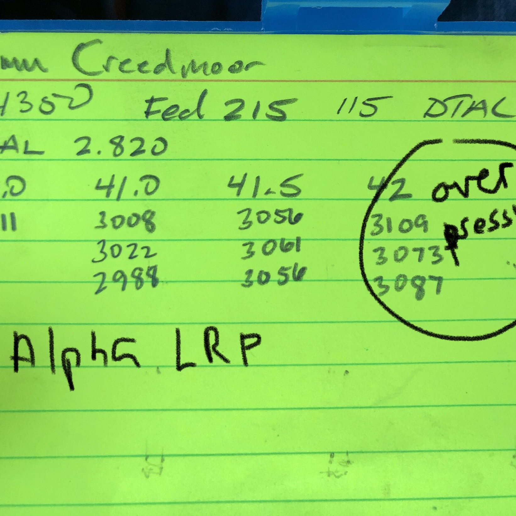

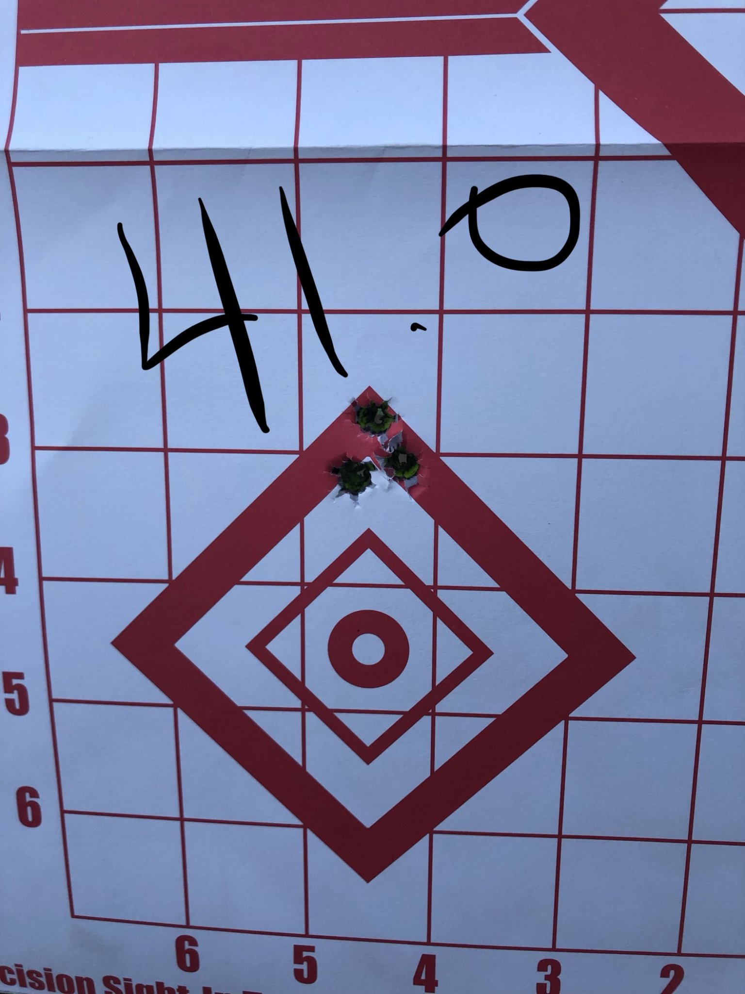

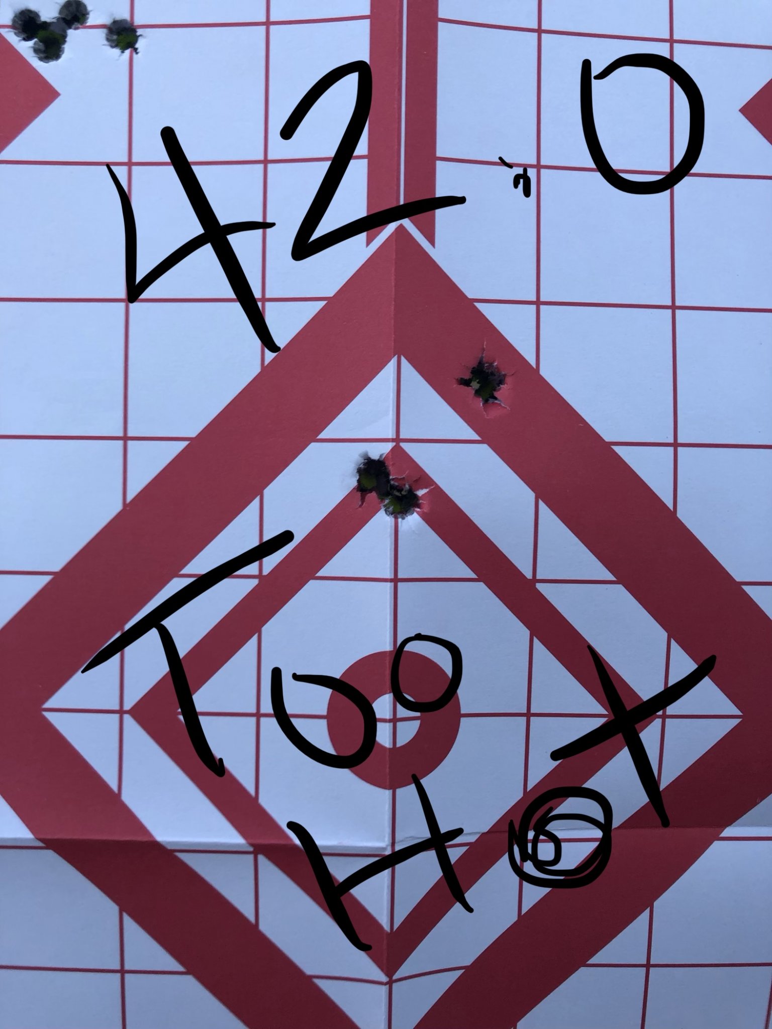

1:7.5 5R bartlien 26”
Alpha LRP H4350
Fed 215
Dtac seated to 2.820 OAL
