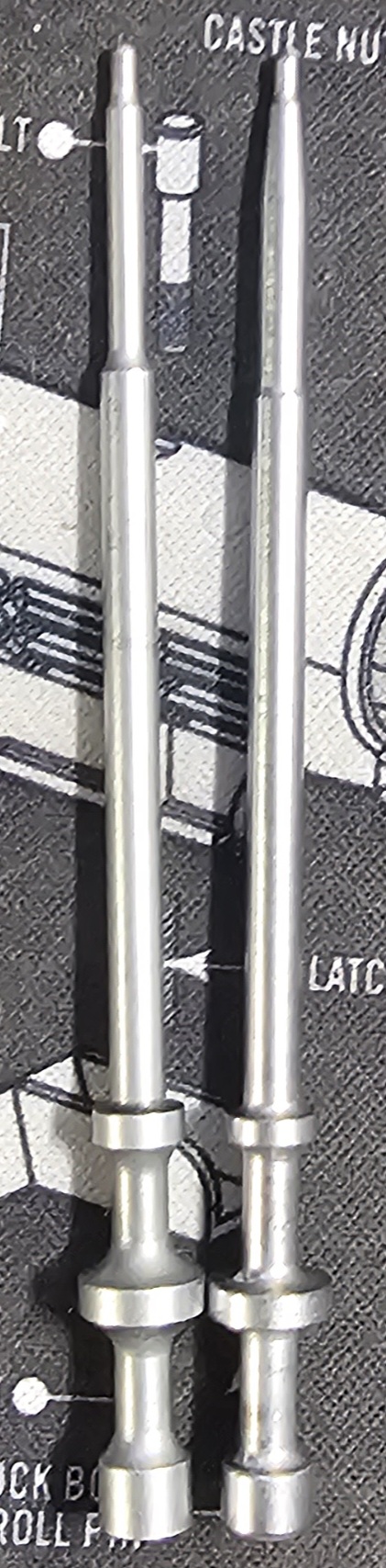

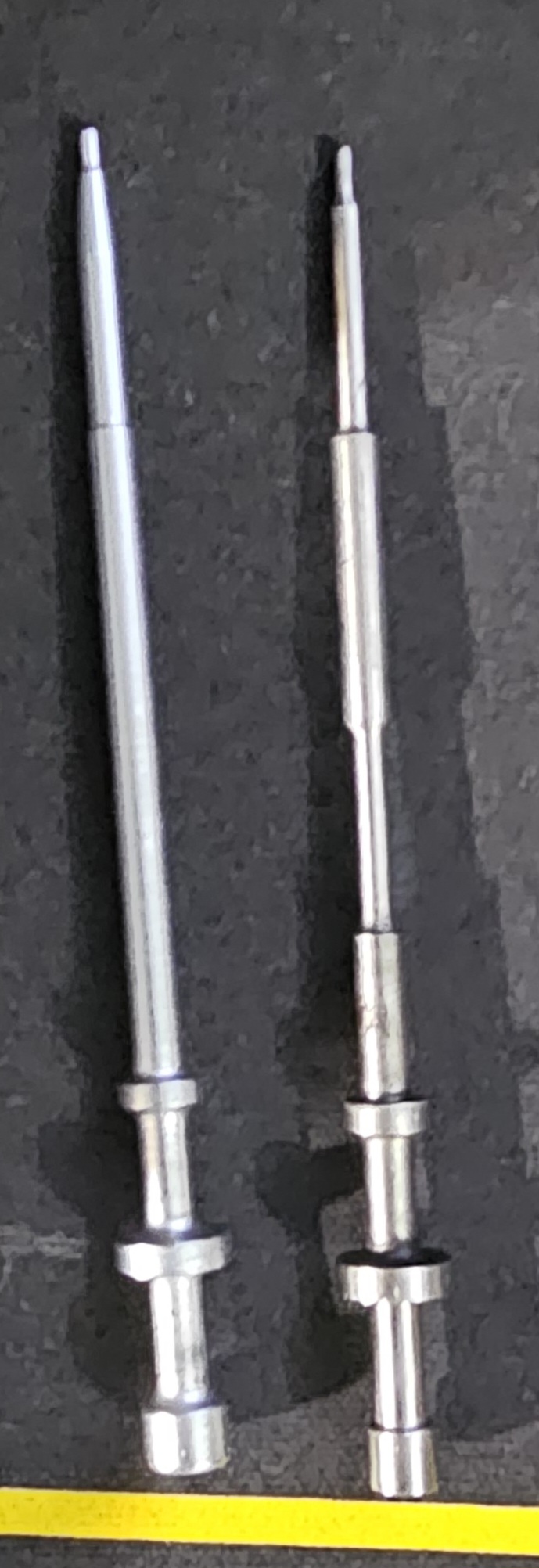

    Here's the difference between the hp and non pins.
    L) non
    R) hp
    The non WILL NOT fit into a non hp bolt due to the angle. KAK uses hp pins (at least in their magnum bolts) and be aware from other sites that state hp firing pins as every one I've ordered from ISN'T a hp pin. HP pin per bolt compatibility is check your bolt and old pin, but aero precision DOES use these pins in their bolts and bcg's (at least the last 6 I've bought). Brownells site is WRONG on their so-called hp pin sales according to reviews. Even JP's can be misleading. JP hp pin on R and other hp pin on L. L pin is used by a few other mfgrs.

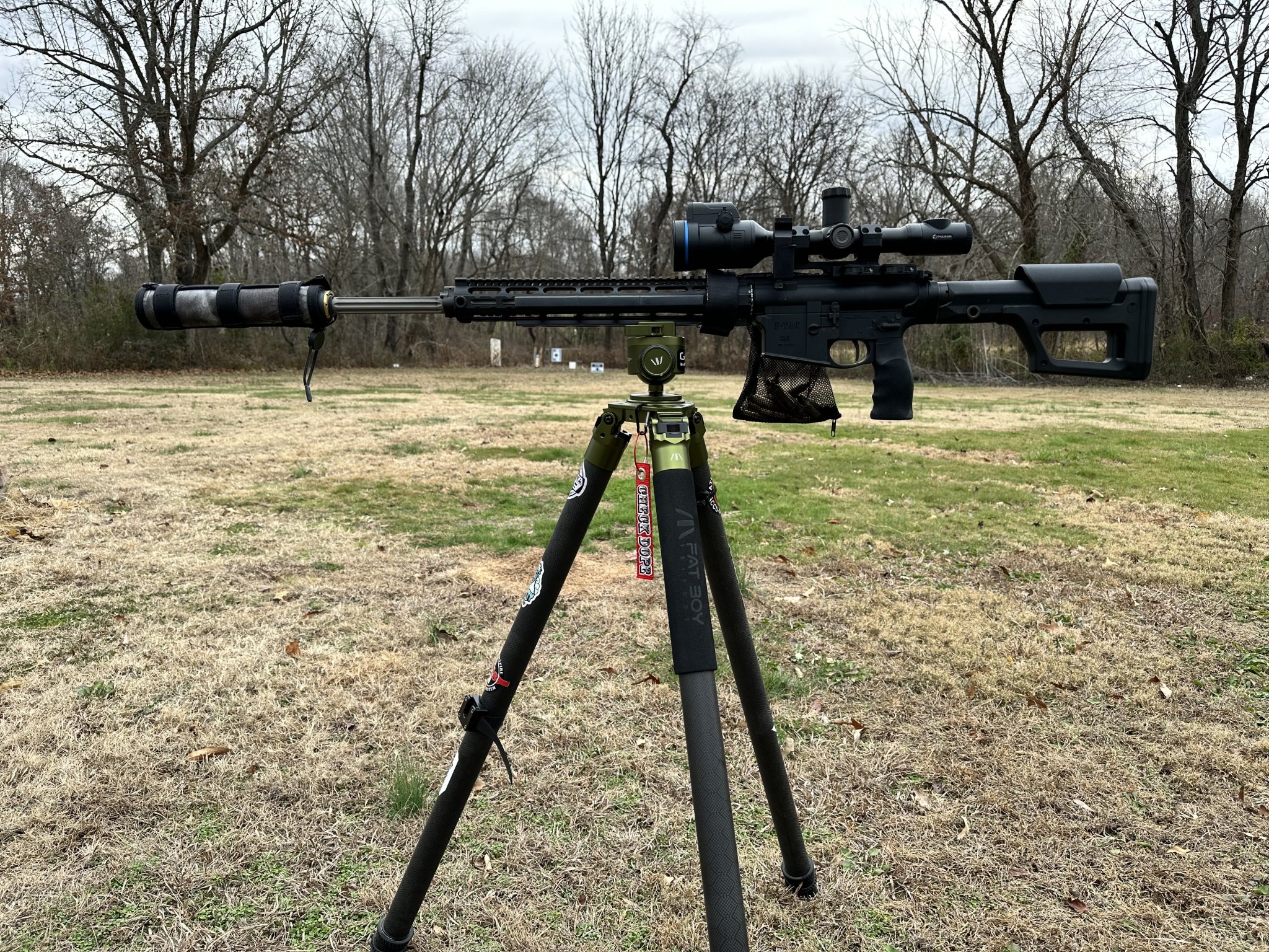

    Build is now complete and running beautifully. Brass does not come out Bolt Gun clean but it's not nasty as the ground either. It absolutely hammers with Factory 103 ELDX. Recoil is very mild and a dream to shoot. I did shoot it with both BCG's I have a both of them were flawless. All in all I am 100% pleased I made the swap. Coyote Rig is now complete. Time to work on a 75g V-Max load.
    PSA Upper & Lower
    Timney Trigger
    KAK Industries K Series buffer tube kit w/ 5.3 oz buffer
    Rainer Arms 22' 6 Creed Barrel +2 Gas
    Superlative Arms bleed off gas block
    MagPul PRS Lite
    Ergo Straight grip
    Midwest Industries 15" Slim forearm
    PTP Master Chief suppressor and Rauch Precision suppressor cover
    Pulsar Thermion DUO 50 optic. * Love the day time and thermal options of this optic *
