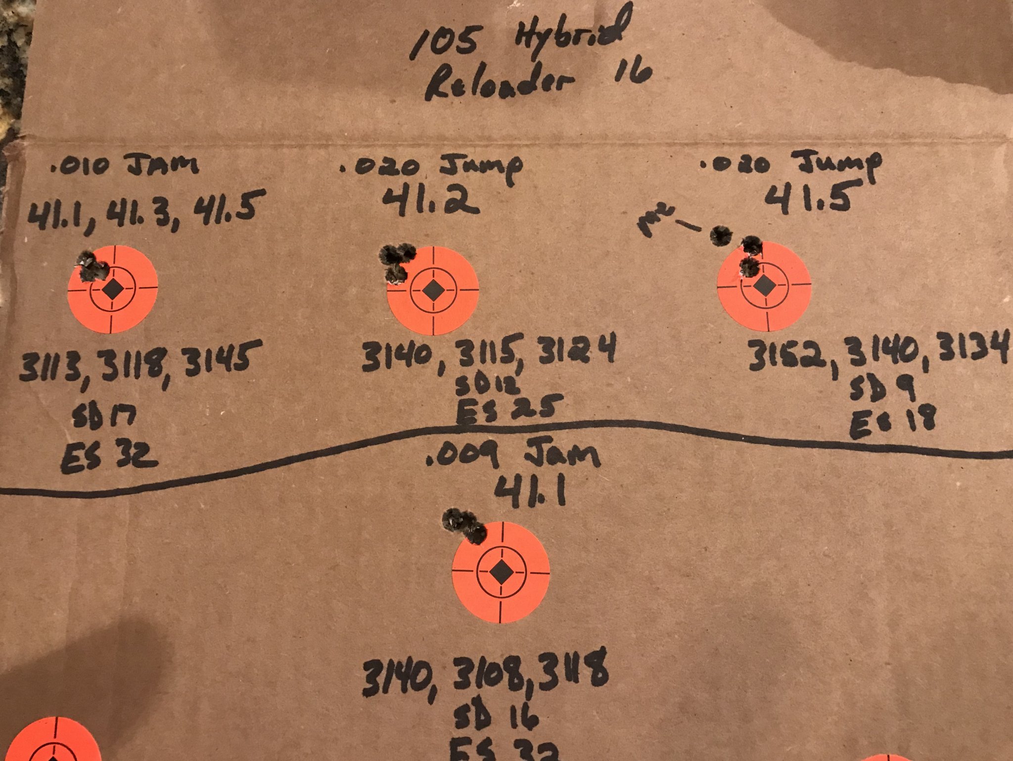

Wanted to get some help from you guys. Shot these last night, started out wanting to find max for my setup (that's why I jammed .010). After shooting the first 3 I changed a few things up. I only have tonight to load ammo, I'm leaving tomorrow for our property that has 300 yard range and would like to try and get as much info as I can to narrow down a good load. Should I shoot a couple of ladder tests? If so what powder range should I start and end at? Should I use the chronograph (magnaspeed)? By the way I have not found pressure signs yet. Thanks. These were shot at 100 Yards. I have a brother in law competition every Thanksgiving at 500 yards for smallest 5 shot group. I know a lot of you don't do that but a plastic crown is at stake and I hate loosing it to them!
6 creedmoor
trigger tech diamond-8oz
26 inch pva 7.5 shouldered barrel
origin action
virgin lapua small primer brass
reloader 16
cci br4 primers
berger hybrid 105
First, how many rounds total down the barrel?
Why are you jamming the bullets?
Your kind of all over the place.
You should have at least 80+ rounds down the barrel or it will keep speeding up
and you won't find a good node.
Only change one thing at a time.
Start at .020 off and do the ladder test at .020 off the whole time.
Start at 40.0 and go up to 41.5 ( since you've been their ) in .2 powder increments
You should see a"flat spot" in the fps.
Or load 3 each of the powder weights, and see how they group. (don't attach the Magnetospeed)
40.0, 40.2, 40.4, 40.6 etc. to 41.5
Last night made a total of 85 rounds. I only jammed because I was trying to find max(hard bolt lift etc.) to see how high I could go, then I would know max charge. I never thought it would shoot like that with them jammed, I prefer to not jam because I do some hunting with this setup also. The top left was my max charge target, I just stopped at 41.5. I'm sure I could go higher, just didn't want to push my luck.

running same load, hornady brass, same bullet as you just shot some today and 41.2gr of RL16 running 3170-3180 fps. .020 jump. once i got above about 200 rds speed went from 3100 to 3170.
That's a hell of a jump in speed. 3100 at 41.2 and Hornady brass is fast also.
