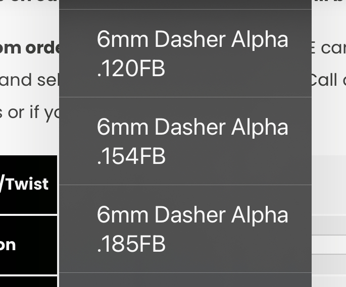

Speaking of TS Customs. He offers these 3 choices for chamber
Any recommendations or pros / cons for the different freebore options
The dasher has obviously been around for a long time and there are many different reamers out there. Most PRS shooters don't want to turn necks and they also want to shoot high BC bullets.
The ideal PRS reamer for dasher would be for a "no turn neck" so you can simply load and shoot. It should also have generous freebore to allow long 110-115 grain bullets to be seated above the case neck junction yet also allow plenty of jump. Some bullets like the 110 Atip like .050 or more jump.
The Alpha munitions reamer with .185 freebore is a great choice for PRS. It has a generous .274 neck and was designed with input from some of the top shooters. I have a barrel from Stuteville cut with this reamer and it is my preferred choice.
That being said, a ton of matches have been won with a ~.135 freebore. For long range I can't think of any benefit of a really short freebore. (like .120 or less)
If you look at the trend of new cartridges (6 creed, 6.5 creed. 6.5 prc etc...) they all have longer freebore then what we would have seen 20+ years ago.
Regarding length, I like the free velocity of the 28" and it also balances better on my rifle. But 25-28" is pretty standard and comes down to personal preference.
