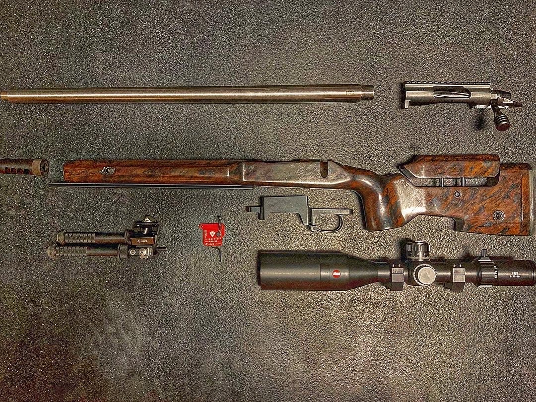

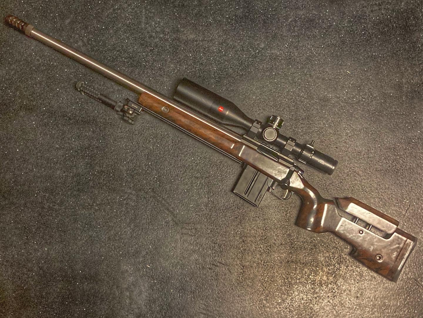

6 Dasher Build
Jeremiah Johnson
Oct 19, 2019
211
113
Texas
First bolt action I have put together myself. With the easier than I expected. Just had to find the parts. Built this with the intent of getting into PRS and learning how to shoot better for hunting. Now I just need to figure out how to do this reloading thing. Hope to do a ladder test this week from 32-33grains if Varget.
Build List:
Impact 737 Action
Foundation Genesis 2 Stock
Proof Research 1/7.5 Dasher Prefit Barrel
Hawkins Bottom Metal
Trigger Tech Diamond Trigger
Area 419 Hellfire Brake
Leica PRS 5-30x56 Scope
B&T Atlas Bipod
I have a Nightforce Atacr 7-35 MilXT on order for this rifle, but took the Leica of my big game rifle until it comes in.
Going to use:
Alpha Munitions 6 Dasher Brass
Berger Hybrid 105s
Varget
BR4 Primers
Reactions: TwistedOneinSeven

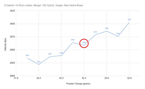

Thanks for the tips... It looks like everyone is saying go low. I had taken some of the load data from the following. All were around 32.5 grains of Varget. I will start in the 31s and work my way up.
32.5gr is/was pretty standard with Lapua 6BR brass
Alpha tends to run less, but 32.5 might be more than fine in your rifle (it is in mine with Peterson brass)
also FClass guys run long barrels and freebore typically which is why its not uncommon to see them above 3,000fps
finally, nodes like that graph are stupid/don't exist.
shoot a ladder to find pressure and desired speed/charge. play with seating depth if you want
