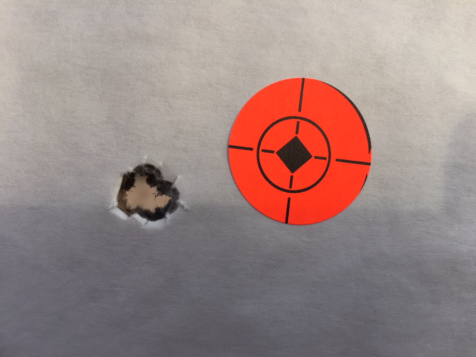

With 31 gr of Varget I was getting flattened primers when fire forming hydroformed brass so I backed off the charge. I am not jamming but running about .005 off the lands. I did experience very good accuracy while fire forming but experienced better groups with fire formed brass.
5 Shot group at 100 with fire formed brass 33 gr of Varget behind 105 Bergers.
