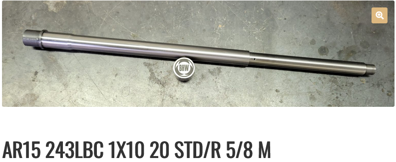

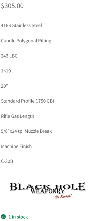

Based on the limited info I'd just buy this and build it. Should come ported correctly out of the gate, but I'd still recommend an adjustable gas block.
I have one of their Polygonal 6.8 SPC2 barrels & it shoots well.
https://truesportingarmsllc.com/product/ar15-243lbc-1x10-20-std-r-5-8-m/

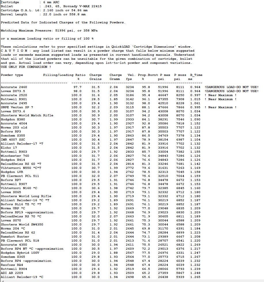

I would lean more toward cfe223 for light bullets. I loaded up some 65 vmax with a light charge of 8208 and slight jam to blow the shoulder forward in some of my brass. 2959fps 28.5 grains Starline grendel brass.
