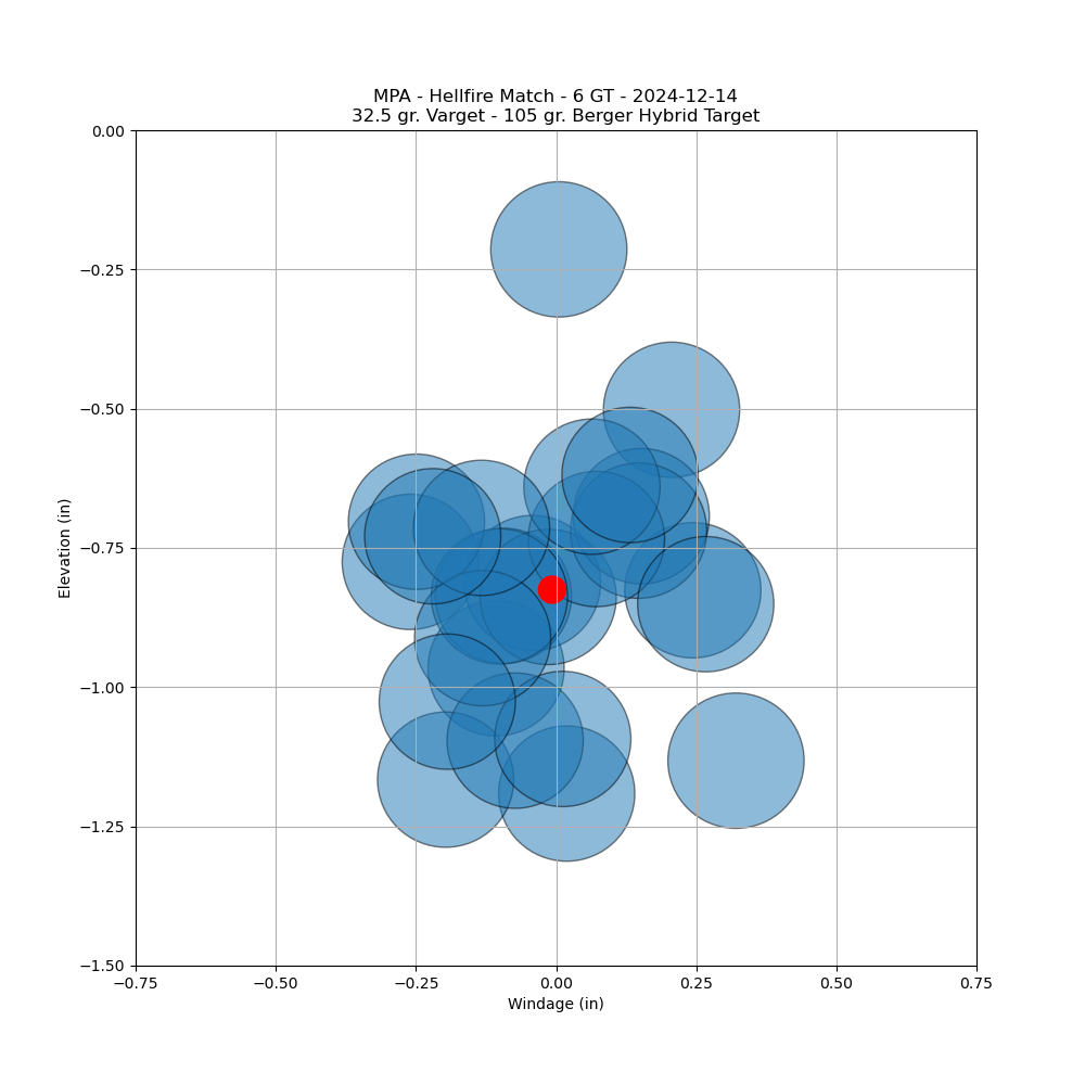

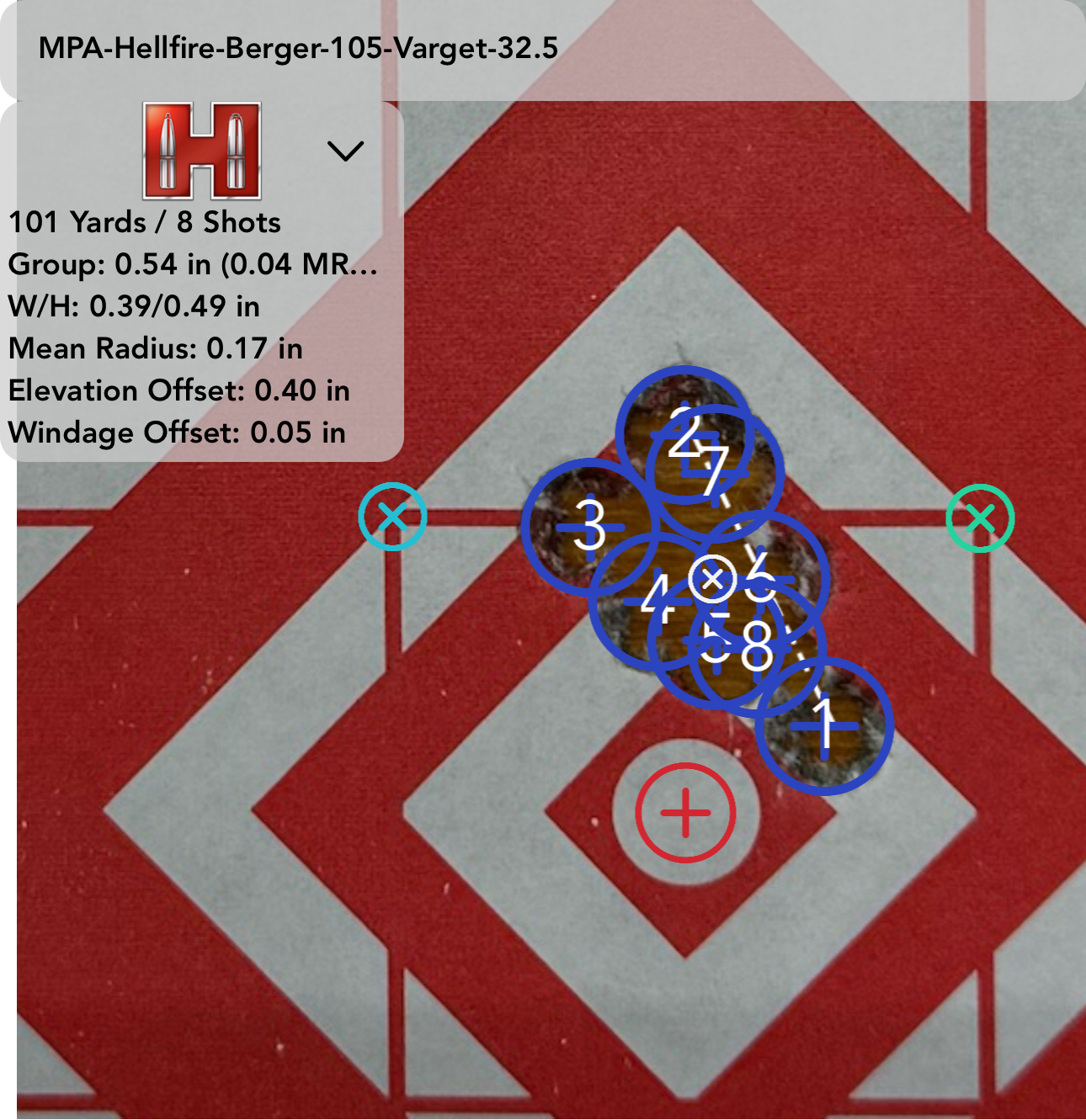

Looking for some advice/thoughts on this load. Broke in a new barrel this weekend. Groups were great, SD not so much. Most of the details below. I included photos of the composite group and the 8 shot group. Not sure what happened with the literal flier, might have been me, might not have.
I'm not sure if I should just chalk this up to barrel break/cold weather or not. Not going to lie, I was expecting a lower SD with how well it was grouping. The 5x5 groups were the 32nd to 56th shots through the new bore. I shot another 17 shots of a different load after the 5x5 group, then the 8 shot group, so shots 74-81.
Oh, and btw, I was getting pressure signs with the suppressor (OCL Polonium); heavy bolt lift and some ejector swipe. Here is the break-down of the suppressor groups. From my limited research, I guess this is a thing where some suppressors will cause pressure signs with an otherwise normal load. I have a Silencerco Omega to try out next time.
Shot a 5 shot group (great group - 0.3 MOA no pressure signs)
Shot a 5 shot group and had pressure signs, group was terrible, worst of the day
Cleaned chamber/barrel
Shot 5 shot group pressure sings went away, good group 0.5 MOA
Shot 2 more, pressure came back, sadly took the suppressor off and put it away
Shot 8 more shots no pressure signs with brake
Right now, I'm leaning to loading another 50 of the exact same load and retesting (with brake and Omega suppressor). I don't live close to the range and with the family I don't get many days at the range, so I try to bring a lot of ammo for thorough testing/practice, even if it means using more components than I need to.
5x5 and 1x8 groups for a total of 33 shots
Avg. Velocity: 2829 fps
Velocity SD: 12.7 fps
Case: Virgin Alpha
Primer: CCI 450 OEM
Powder: 32.5 gr. Varget
Bullet: Berger 105 Hybrid Target
Distance to lands: ~0.055
COAL: ~2.535
Barrel: Proof 6 GT 7.5 Twist (pretty sure Proof has the .120 FB)
Muzzle Device: 6mm Hellfire Match
Range: 101 yards
Ambient Temp: 37 degrees Fahrenheit
Chronograph: Garmin Xero mounted to ARCA
All loads weighed on A&D FX120i
