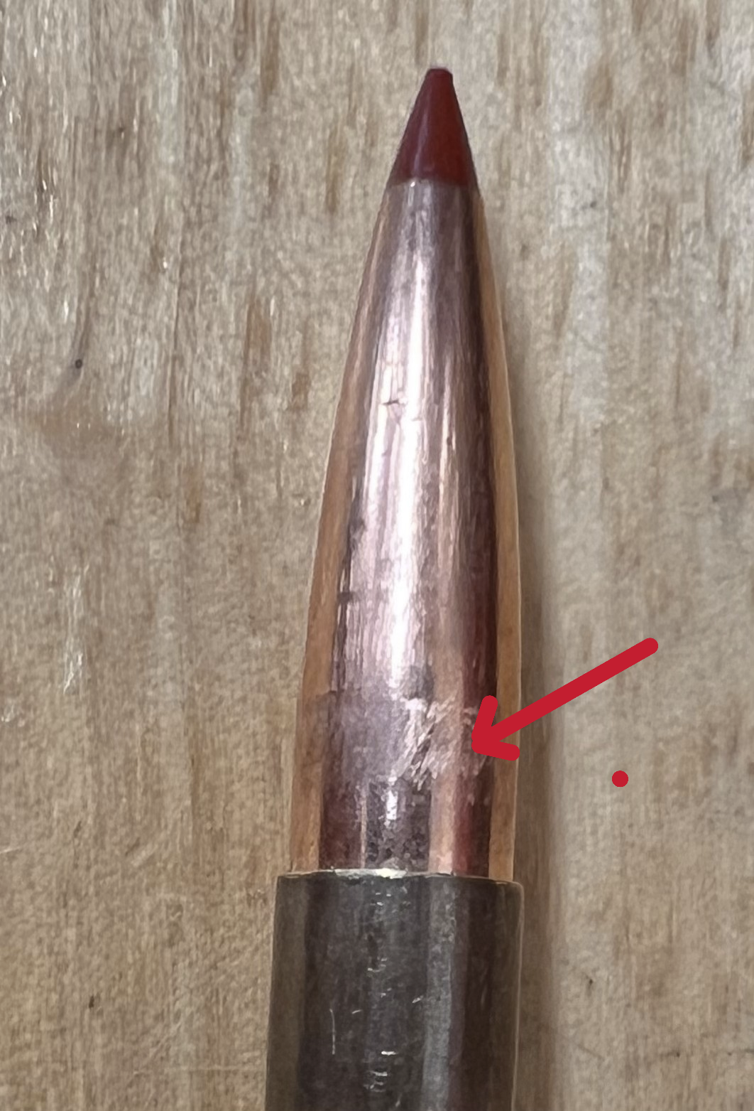

    Just built a rifle in 6 GT. Shoots lights out with the new Hornady factory ammo but I'm having hard bolt close on some rounds. I did some diagnostics and the bullet is in the lands. Have the pics.
    This pic is a round that I closed on three times. I'm not the only one. More examples on the Facebook 6GT thread. Zero issues on extraction.
