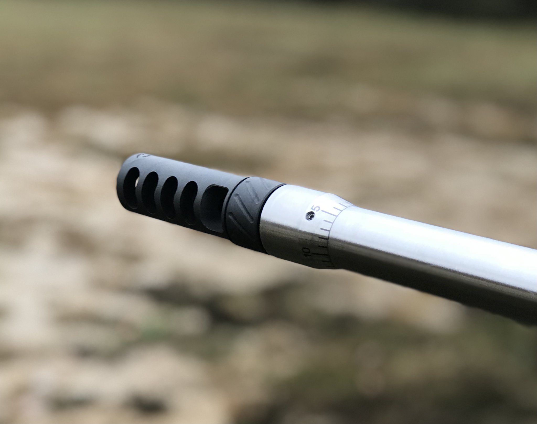

I have this brake:
I am considering screwing it onto my new 6 mm BR barrel, because I cannot buy APA bastard in Europe. It's difficult to buy here a brake for a .900-1" diameter barrel. I am afraid that in order to put VG6 on my 1" barrel, I will have to shave down the diameter pretty drastically to 15mm more less. Do you think that could pose a threat to accuracy?

I don't know about your local rules, but I know international fullbore rules (that also govern intl F class) do not allow muzzle brakes.
I'm not the first one to tell you that but you seem to ignore everyone who does.
Do you care to play by the rules?
@308pirate and @smoothy8500 your questions (doubts) are legitimate. Indeed, in I.C.F.R.A. rules muzzle brakes are prohibited. However, there are several local F-class matches that allow that e.g.
This is where I am heading right now. Once I win several of those, I will move to proper ICFRA compliant matches where brakes are prohibited (and I will then deinstall mine). I hope the above addressed your doubts.
You still make no sense. If your goal is to compete in ICFRA-sanctioned matches, why do you want to start now with a brake knowing that you won't be able to use it later?
Do you have some sort of physical infirmity that requires the use of a muzzle brake on that bone-crushing 6BR that weighs probably north of 8 kg?

@308pirate thank you for your honest and direct remarks like "you still make no sense". I just don't like recoil, even if it's a mildrecoil, so if there are matches outthere where I am allowed to compete using a muzzle brake I would like to take this path.
Most of the BR guy's are running a HV contour and 28 inches with a tuner. (no brake)
They would run what wins.
As for F class, a brake is not allowed for score. At some ranges, you are put at one end
if you run a brake.
A 28 inch HV contour in a 6br or variant in a front rest with bag, doesn't kick
enough to get a brake unless you've had some shoulder surgery and worried about that.
With a brake, it's a pop gun.
You could have a blended muzzle thread done, so you could run it without a brake and
see how it felt with a smooth looking end. If you needed less kick, then screw one on.
