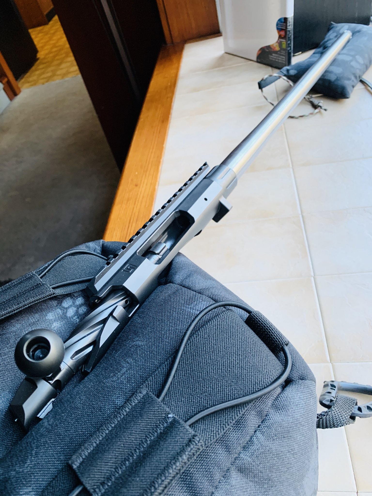

    I just received my Ultimatum Deadline barreled action this week. Initial impressions are awesome! It is a well designed product. Love the idea of interchangeable bolt face and pre-fit with a barrel nut.
    Reactions: Cheyenne Bodie
