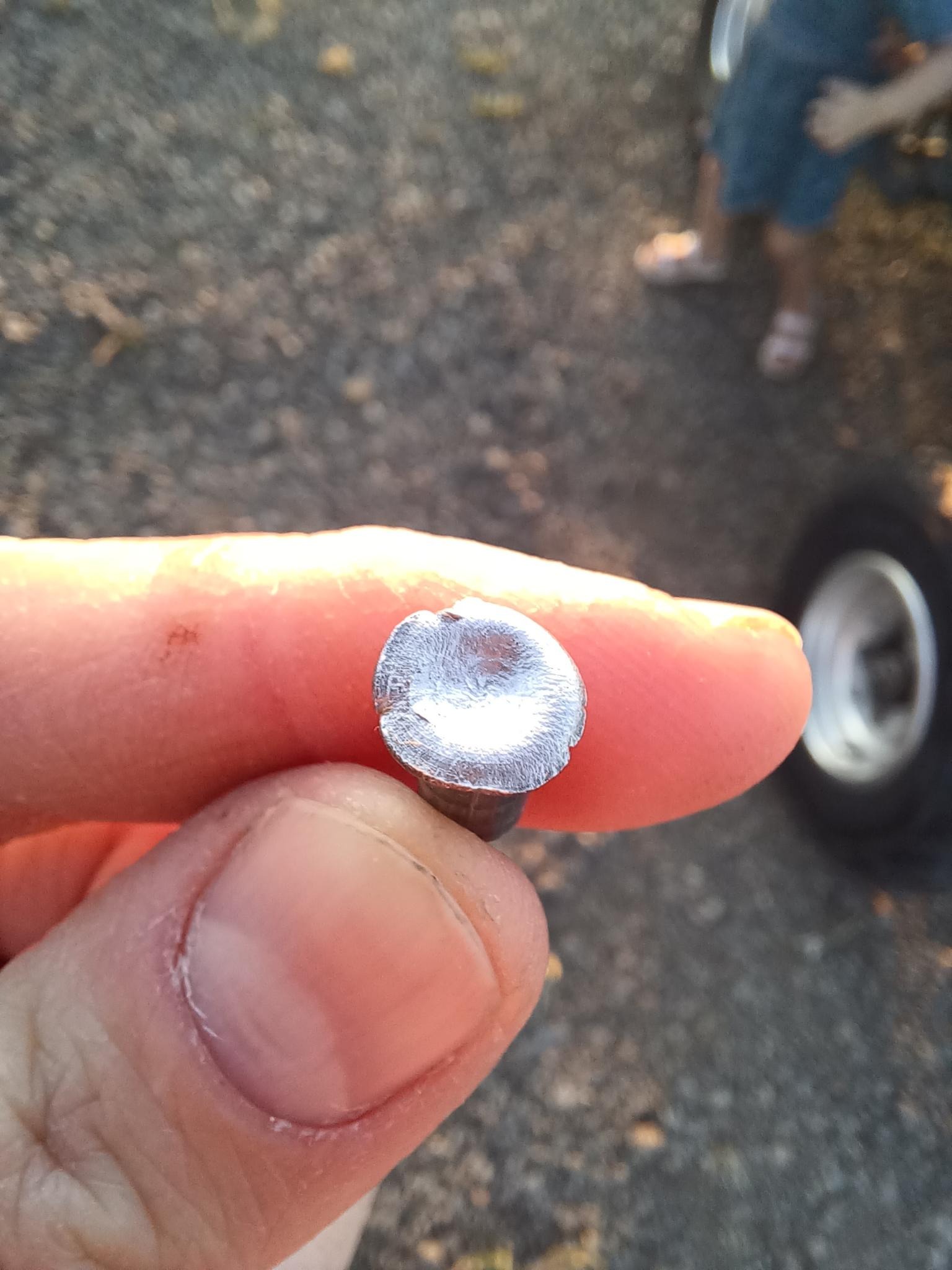

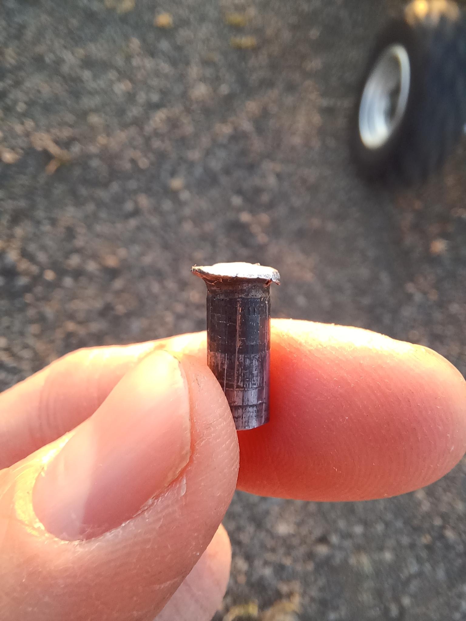

More testing for those who are interested.
The expensive stuff:
https://borebuddy.com/wp-content/uploads/2023/04/Targets-04-26-202304262023.pdf
And some 60gr SS weight sorted and some hollow pointed with the Waltz die:
https://borebuddy.com/wp-content/uploads/2023/04/Targets-04-27-202304272023.pdf
Vertical stringing is still an issue, but sorting seems to have helped. The HP die also helps, as it bumps diameter by 0.001-0.002".
Targets marked "780" are control groups with an old Marlin Model 780 that shoots well for a factory rifle and has sent a lot of varmints to the afterlife.
Hollow pointed with the waltz die.
