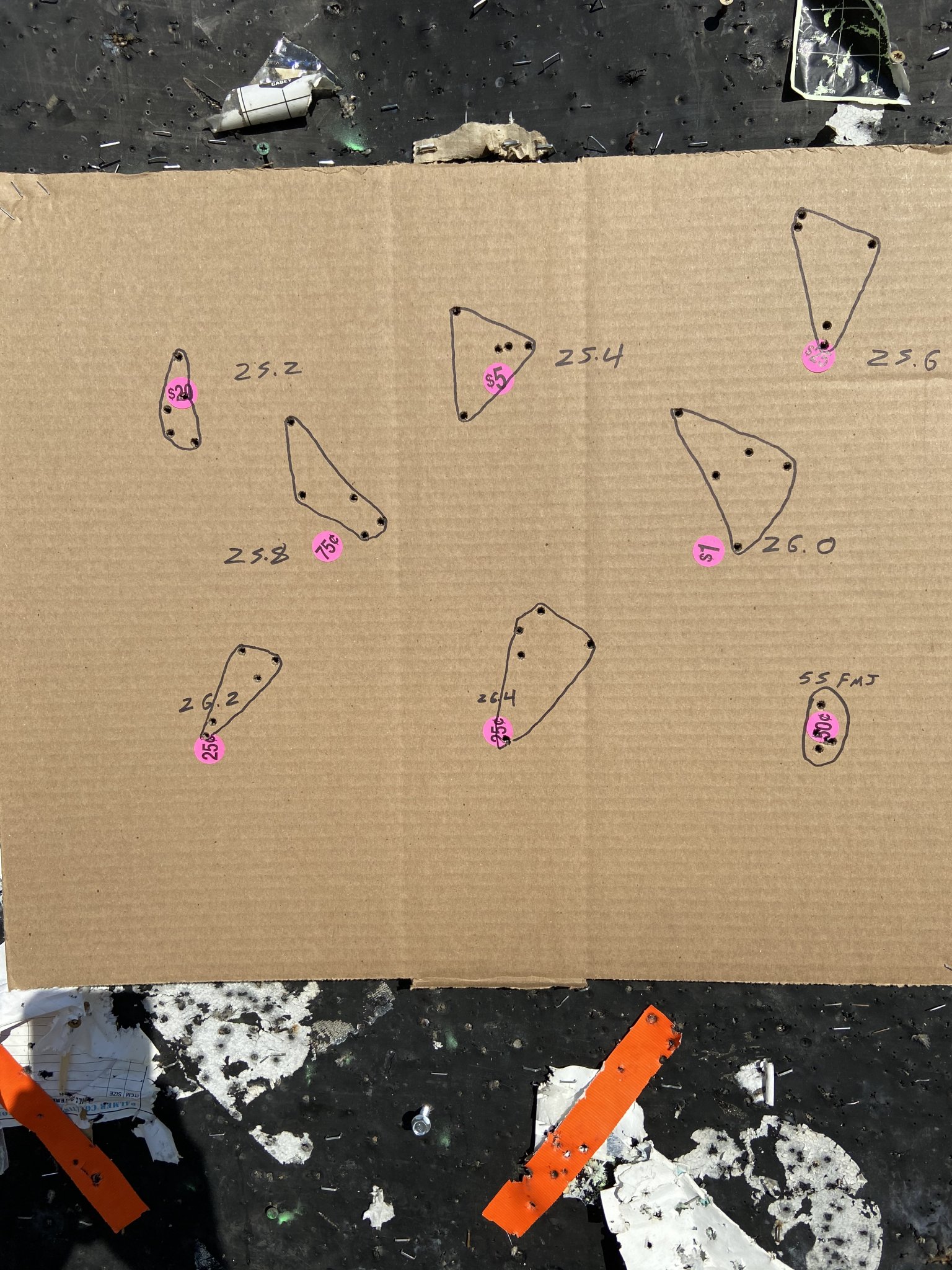

I’m trying to attach a picture from my phone of the last time I went out.
Bottom right is 55gr American eagle
These were all shot round robin.
