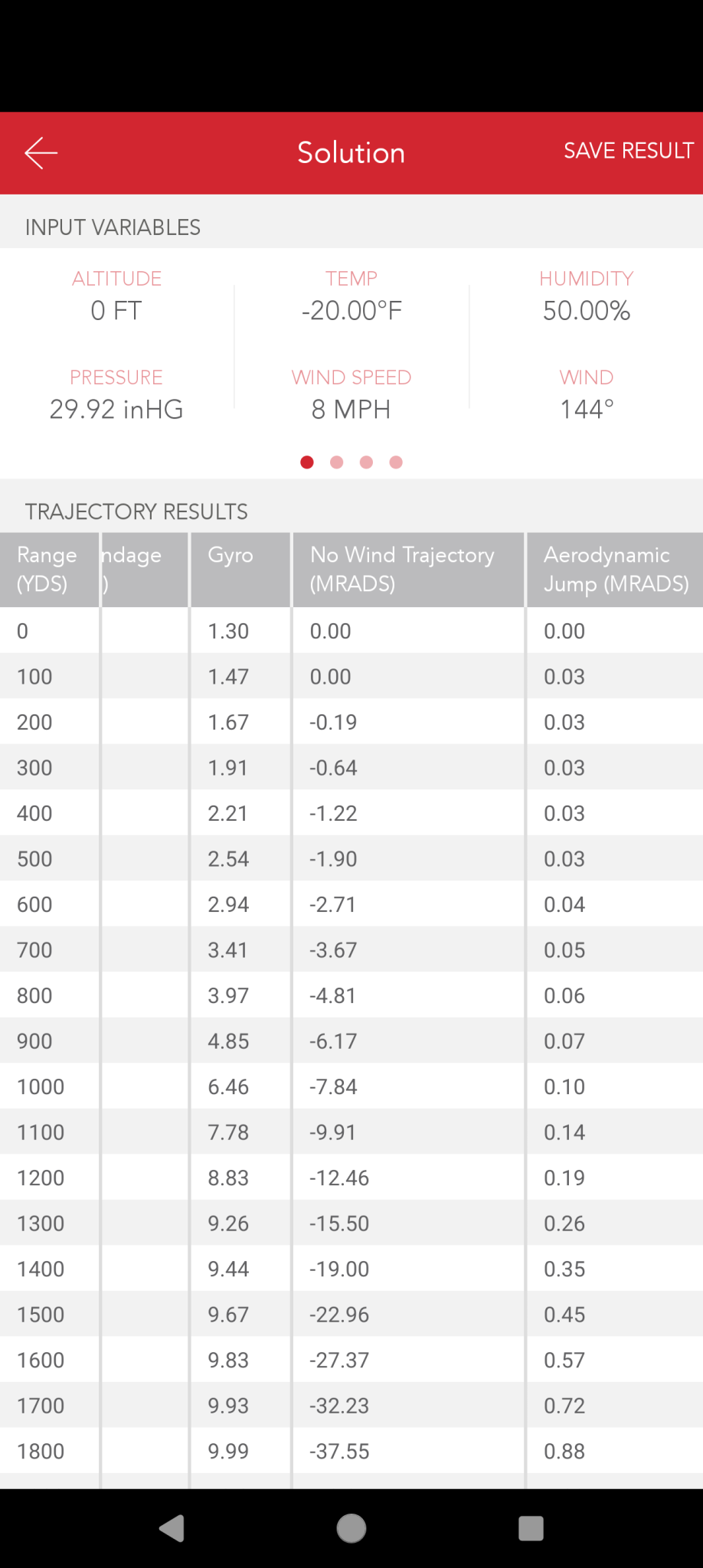

If you have any gyro stability questions on a bullet that's in the 4DoF library, use 4DoF data table to get the SG #'s. It will be the most accurate stability calculator easily/freely available as it uses the physical/mass properties of the specific bullet in its calculations.
Should be fine at 1.3. Will have some AoA related drag but will likely still group fine. This was a 62gr at 3450 in a 1:8" twist.
