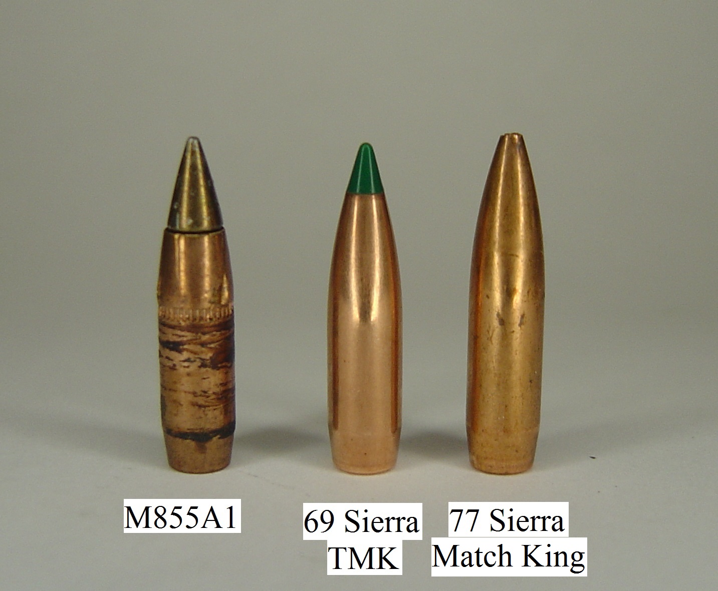

I loaded 69TMKs for my ROTC cadets to shoot during the summer vacation season when they didn't have access to M855A1. It shoots straighter than GI ammo (out of an M4A1), but not as good as 77 MatchKings.
M855A1 bullets and 69TMKs are just as long as 77 Match Kings, but lighter.
