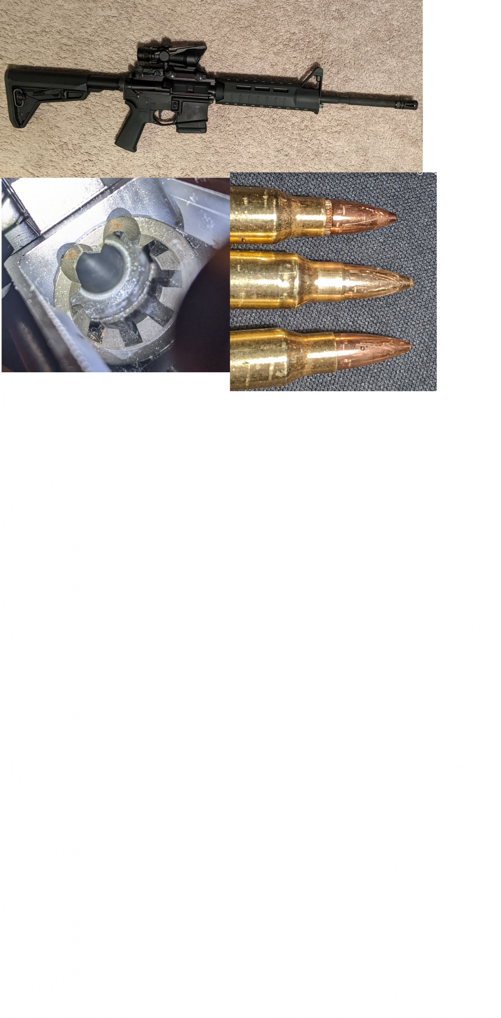

I think I figured out some of the issue on setback
Its the feed ramp on my newer LE 6920. It has a sharp edge someplace because it leaves a long scratch on the bullets. This is not an issue with typical NATA 5.56 ammo 55gr they have bullets with a canicular they don't budge.
Feed ramps can have burrs that are so severe the cause failure the feed because the friction of the burr is more than the action/buffer can overcome so it just stops with a round 1/2 way in.
I don't have those issues but to produce a full length scratch on the bullet it will produce more friction that say a feed ram that was polished smooth no sharp edges.
While its true my rounds do grow in lenght from 2.252 to 2.258" The setbacks when they occur are more severe from 2.252" to 2.20" I tested my 55gr bullets and they do not move.
At least with new starline brass the 69gr smooth projectiles from Sierra and RMR bullets will have a tendancy to move some, either with kinetic hammer effect or worse feed ramp sharpness causing some set back
I think if I can smooth out the feed ramp so it does not scratch the ammo it will fix set back. Wonder if that is a warranty issue?

This is what I'm dealing with, one of my three LE 6920 seems to scratch up the rounds a bit more. It feeds fine just mars up the bullets and seems to set back some of the non canicular 69gr bullets. The 55gr bullets don't move at all but they have a canicular crimp ring.
I know your asking about loading. But the link I'm gonna add will have some info in what to do, to smooth out the ramps to not gouge your projectiles like that.
