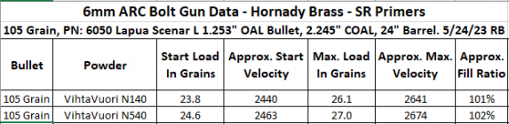

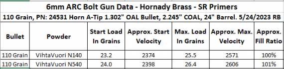

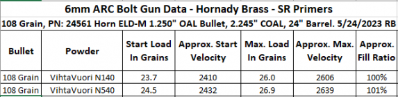

    The following data came from VitaVuori. VV Powders are relatively cheap right now.
    You may want to inquire with them about load data for the lighter bullets you mention.
