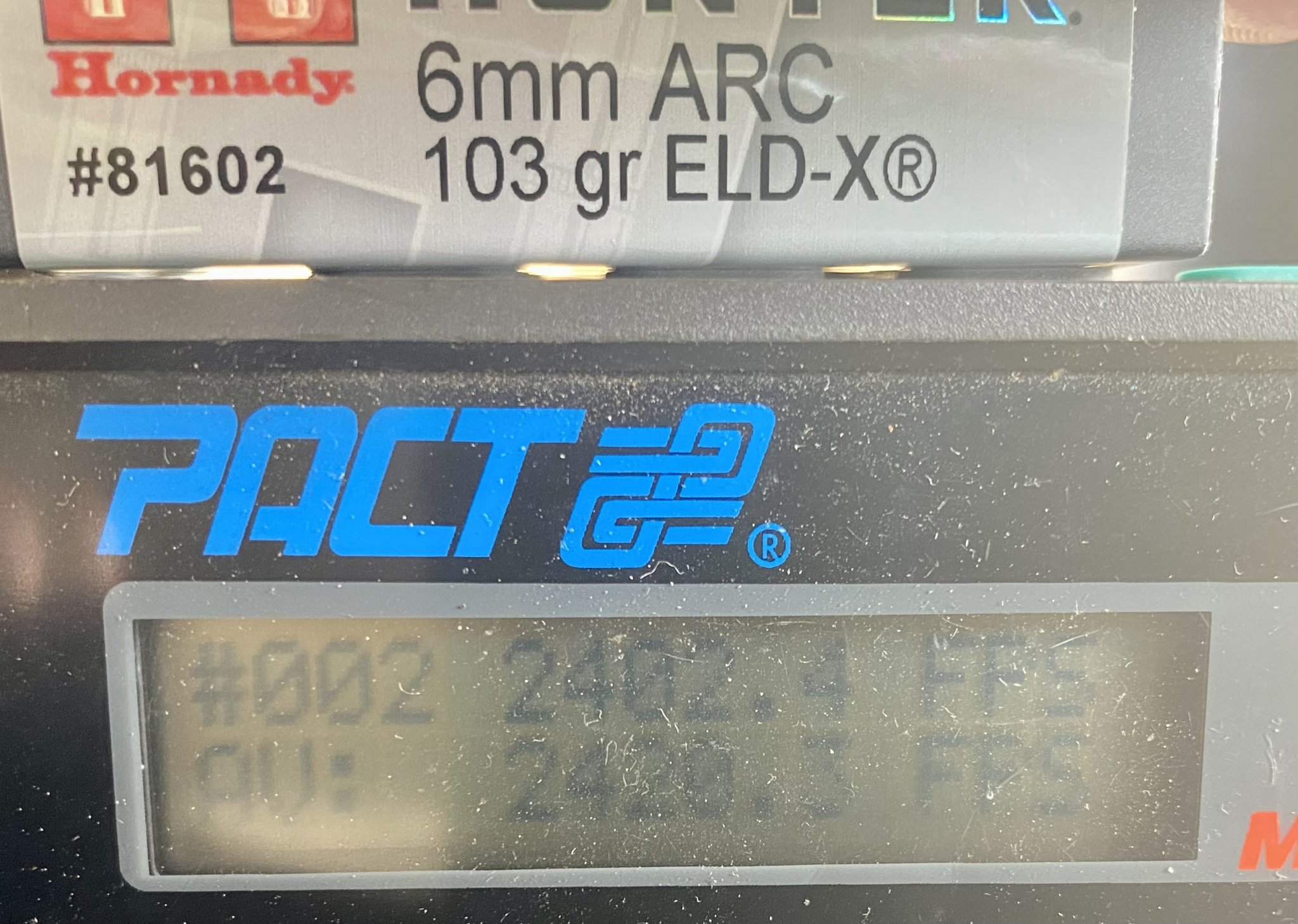

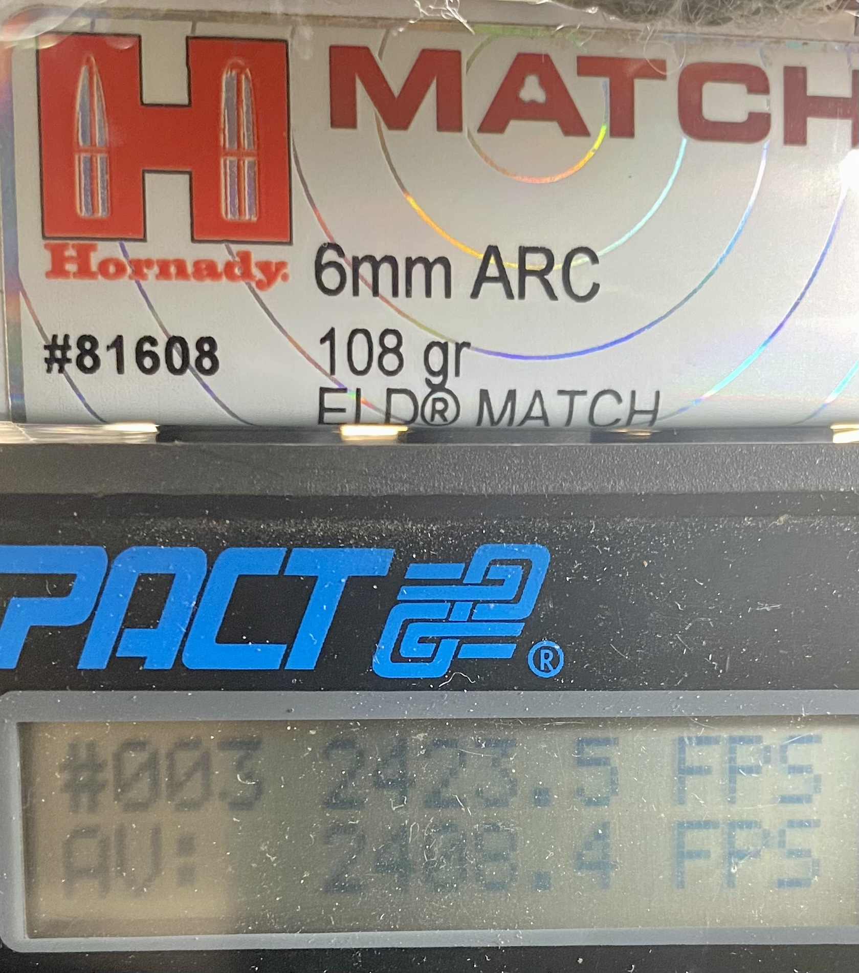

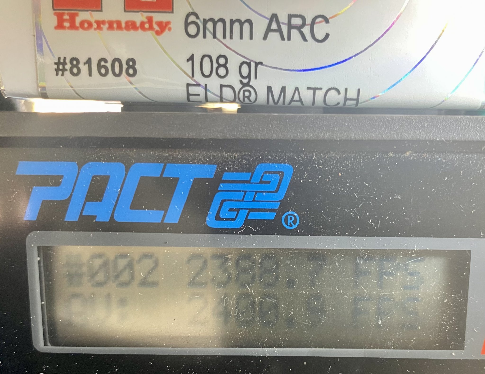

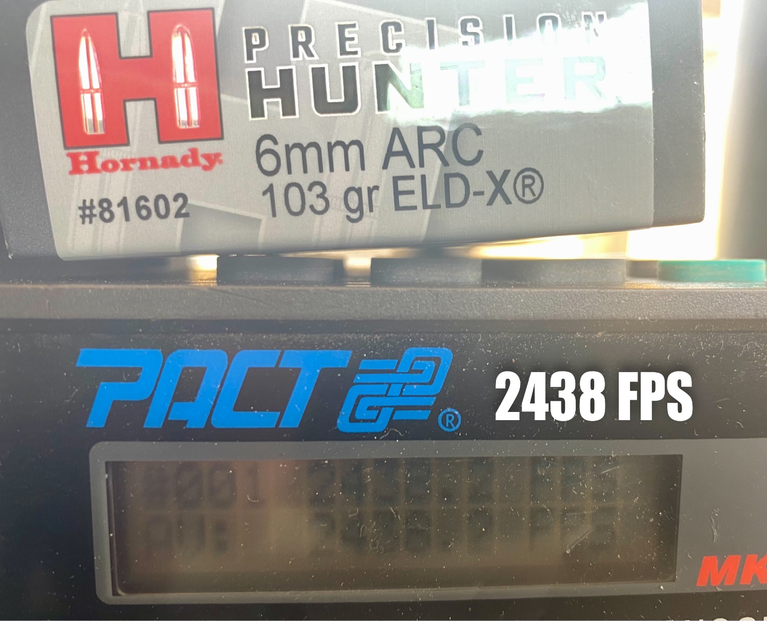

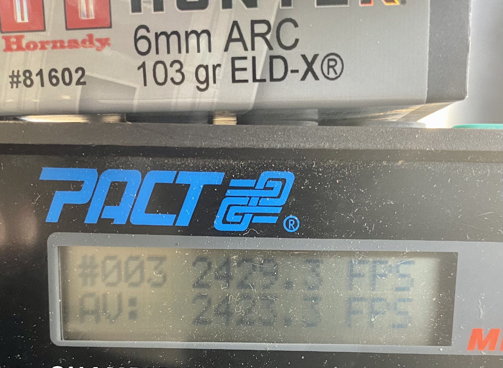

Okay, highly scientific results here with my old PACT chrono and a grand total of three rounds per. But at least it’s something. Good day for it, bright but heavy overcast.
I thought I had a couple BLACK rounds left but it was the HUNT instead.

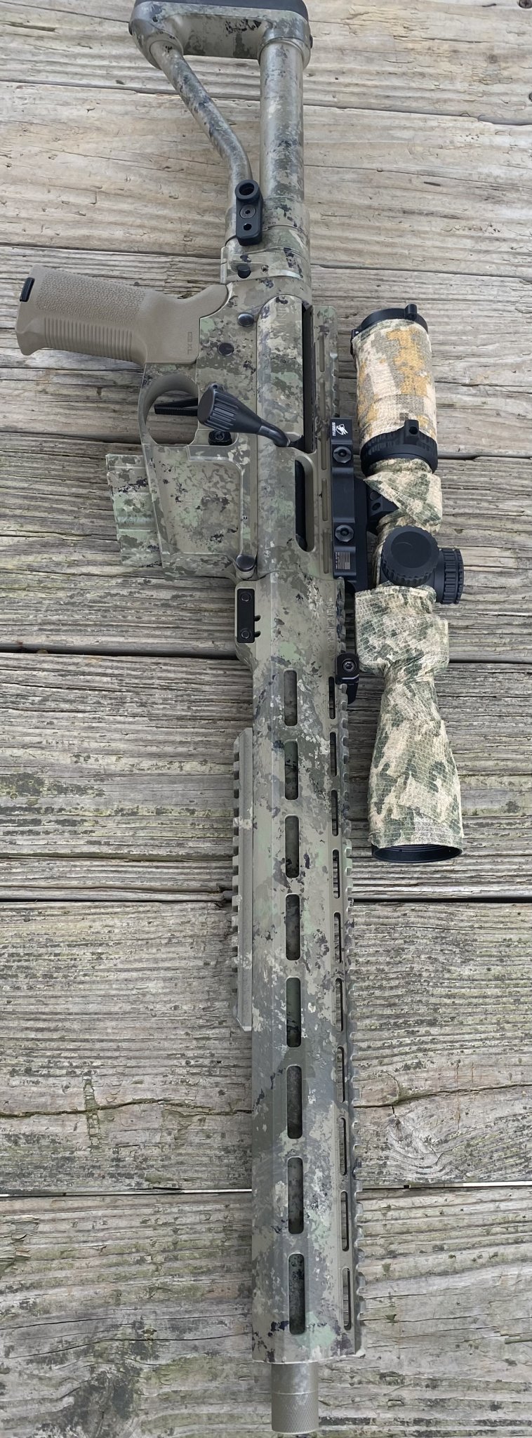

16" inch Uintah upper
Reactions: Bravo6niner
16" Uintah Precision (MGM 3 groove barrel IIRC)

I've not chrono'd any handloads with it, or even tried too many loads. Certainly haven't worked up any loads. I went 16" because portability / pack-ability was what I was after, and why I put the folder on it.
I've owned it a while now and I'm still on the fence about it.
