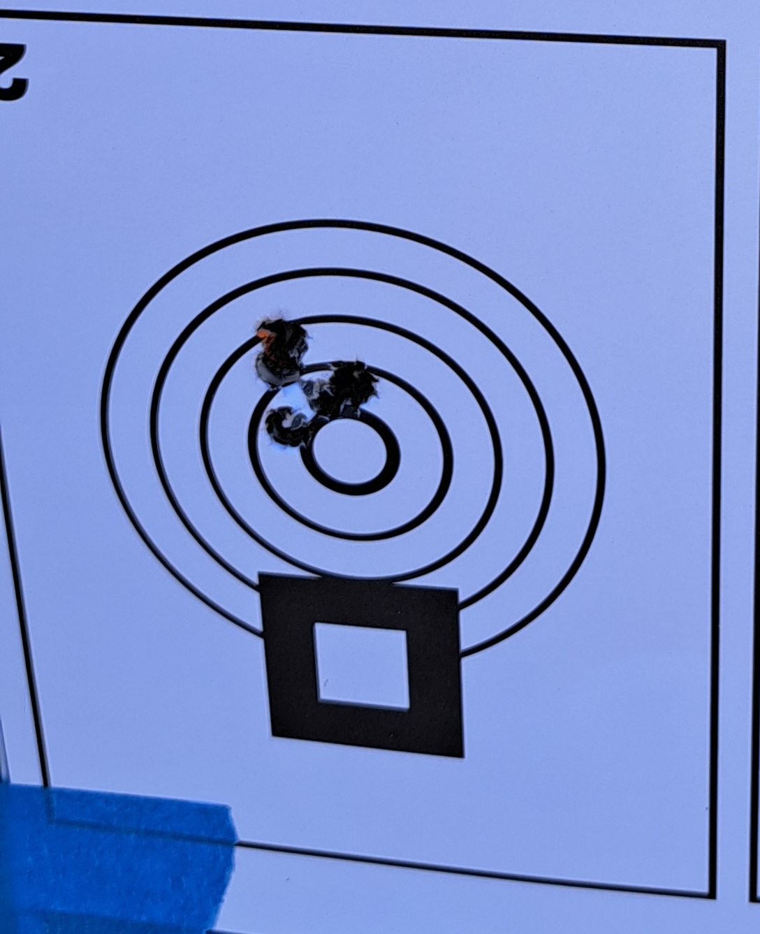

    I have a barrel with 5290 rounds on it. To reach the lands, the 112 Barnes won't fit in my MDT BR mag.
    The 105s will though.
    It does feed extremely well in the 5 round plastic Magpul mag.
    From a rickety-assed wooden bench, it'll still do this, so I'm gonna keep using it until it completely dies off.
    I should probably try it from a concrete bench or prone to see what it is still capable of.
