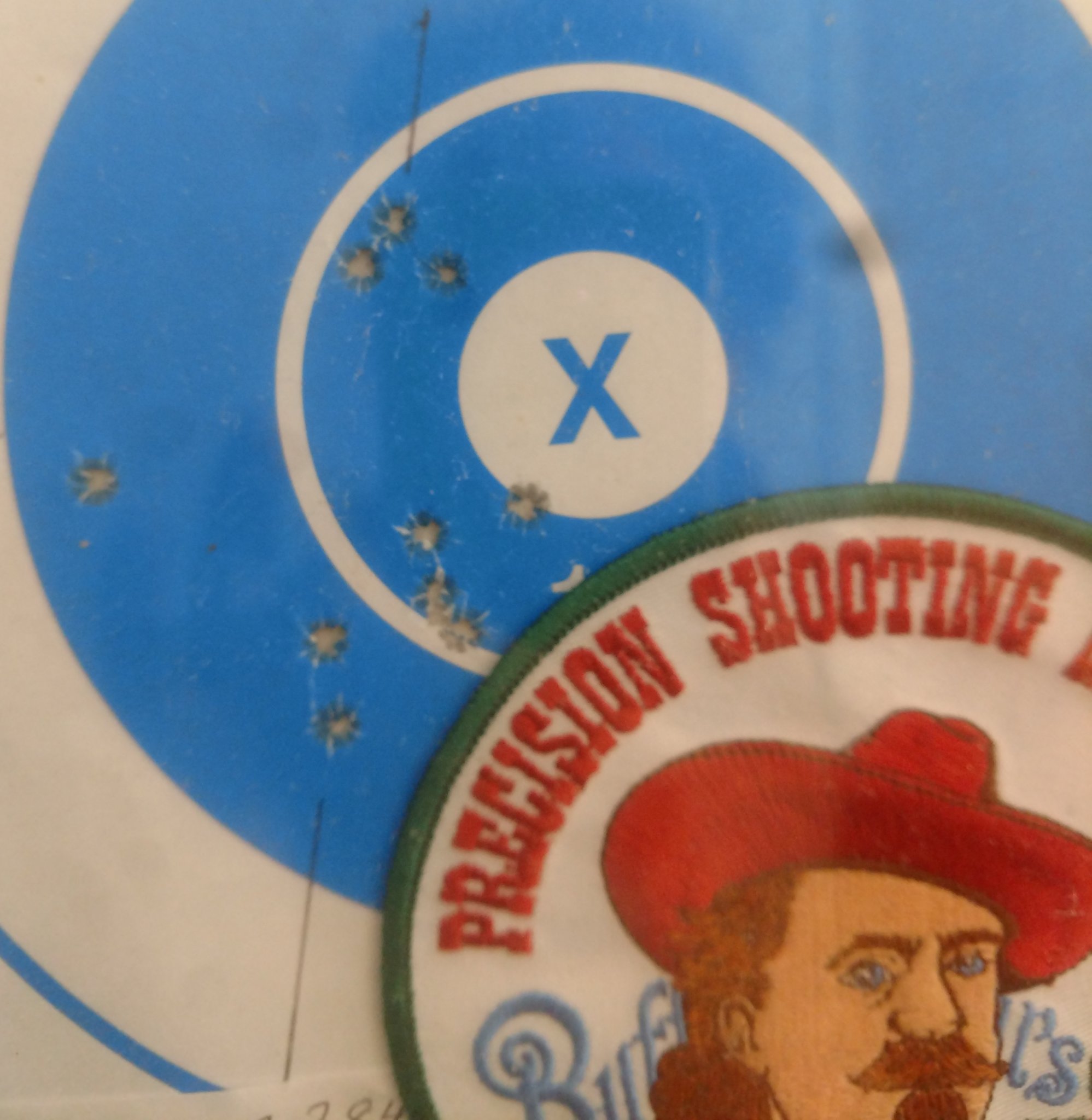

    I ran RE15 into many 6 Dashers with a 0.268 neck and 0.104 freebore.
    A touch over 33 grains will get you world class accuracy with a 103-108 class bullet. The 10 shot group pictured was at 600 yard NBRSA match and was an official screamer group.

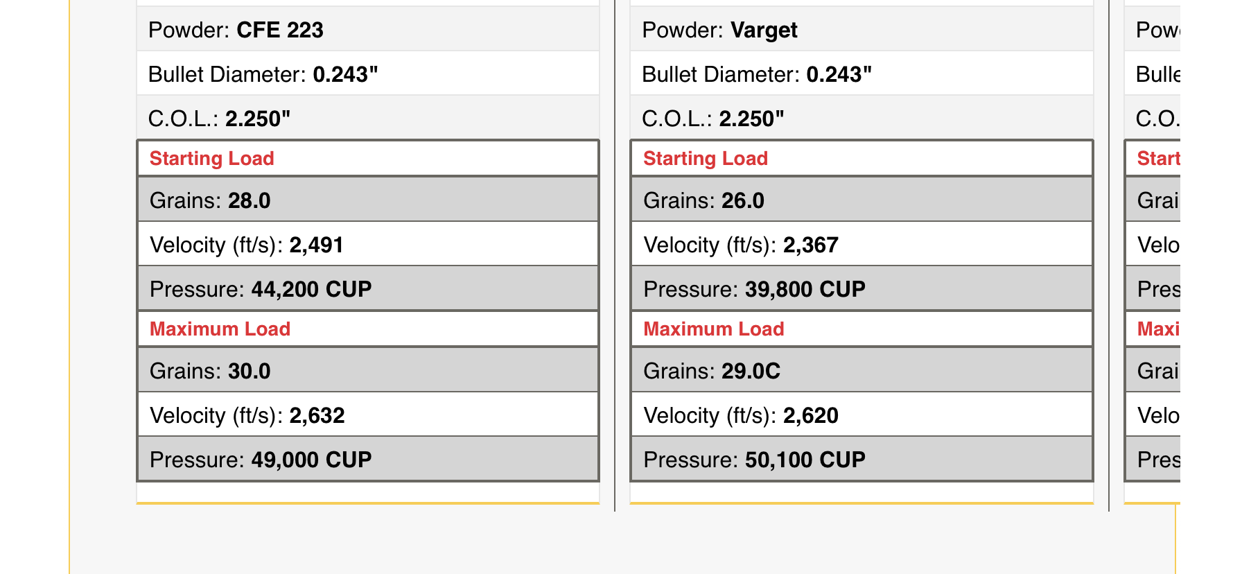

    Just keep in mind it has a faster burn rate than Varget and you may not get the same speeds and find pressure signs sooner.
    When I first started using it I couldn't find it on any burn rate charts so I used the 68spc with a 20" barrel as a test round and confirmed for myself that it is indeed faster burn rate than Varget.
    I know powders don't allways behave in a linear fashion due to bore to case ratio from caliber to caliber but in the 68spc the answer was definitive as there was no way to get enough Varget in the case to see pressure or decent velocity but at max fill with AR-COMP was getting respectable velocity and no pressure.

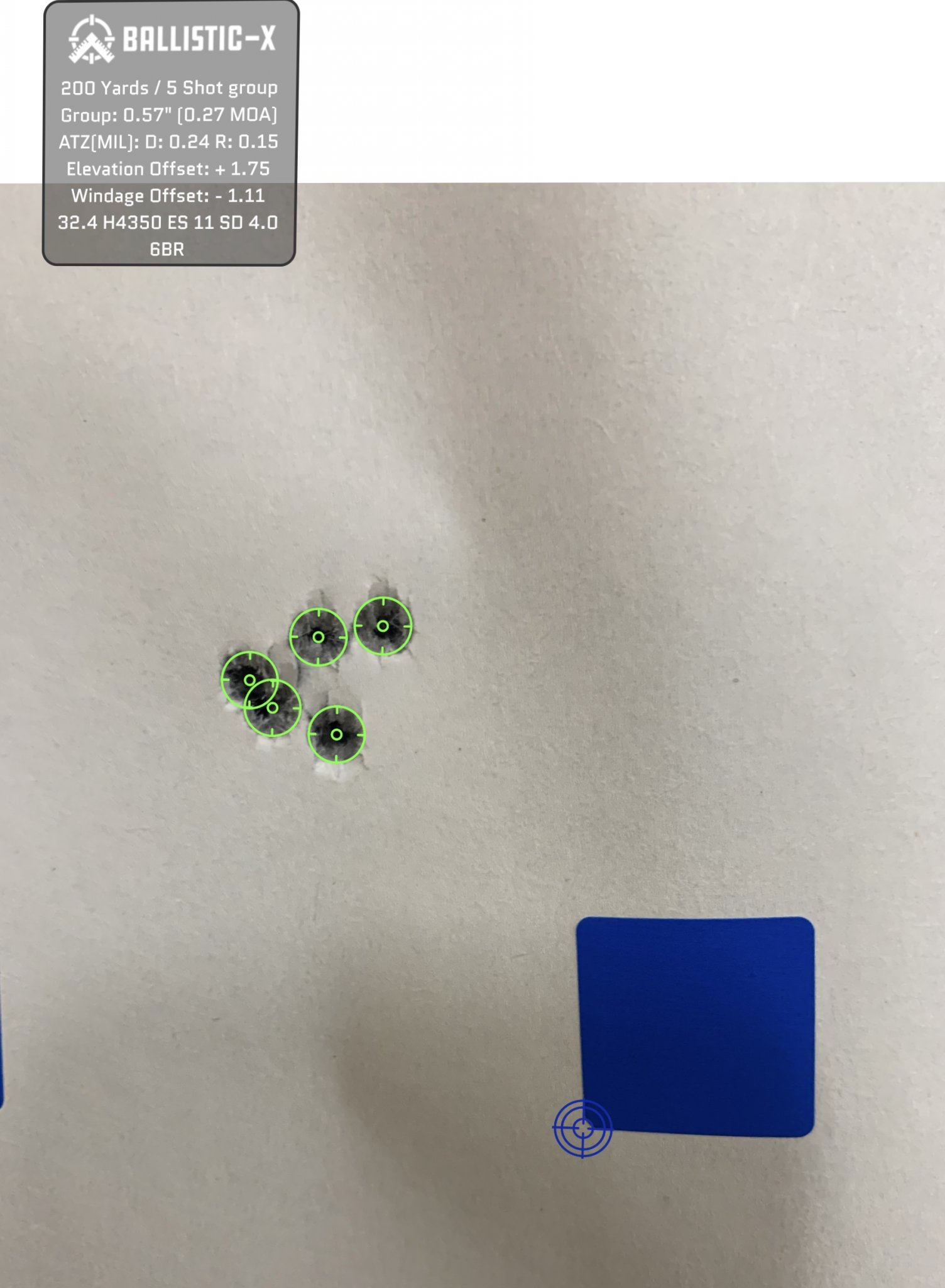

    Due to the lack of Varget, I done some development with H4350 in my straight 6BR.
    28” 1:8 Bartlein, with 456 rounds down the tube
    2300DA
    Started at 31.0g, in .2 increments up to 32.8g. Speeds went from 2644 to 2810, with a node between 32.2 (2770fps) and 32.6 (2778fps.)
    I loaded up 5 each at 32.3, 32.4 and 32.5 and shot for group size, ES and SD at 200yrds. Below is what I settled on:
    32.4g
    Avg: 2764fps
    ES: 11
    SD: 4.0
    Group size: .57” (.27 moa.)
