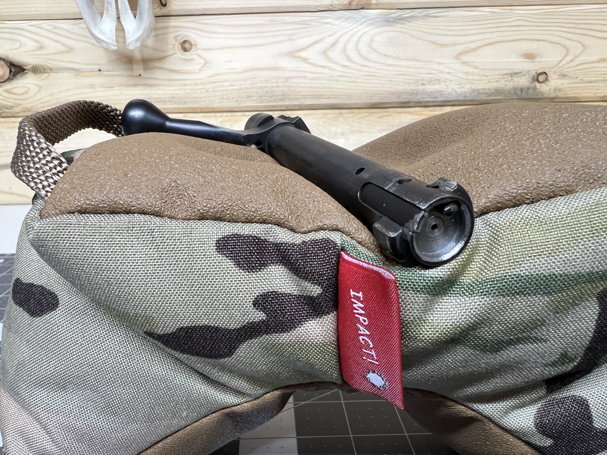

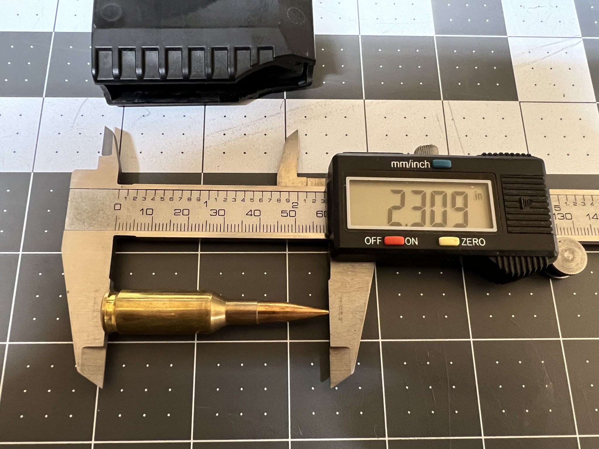

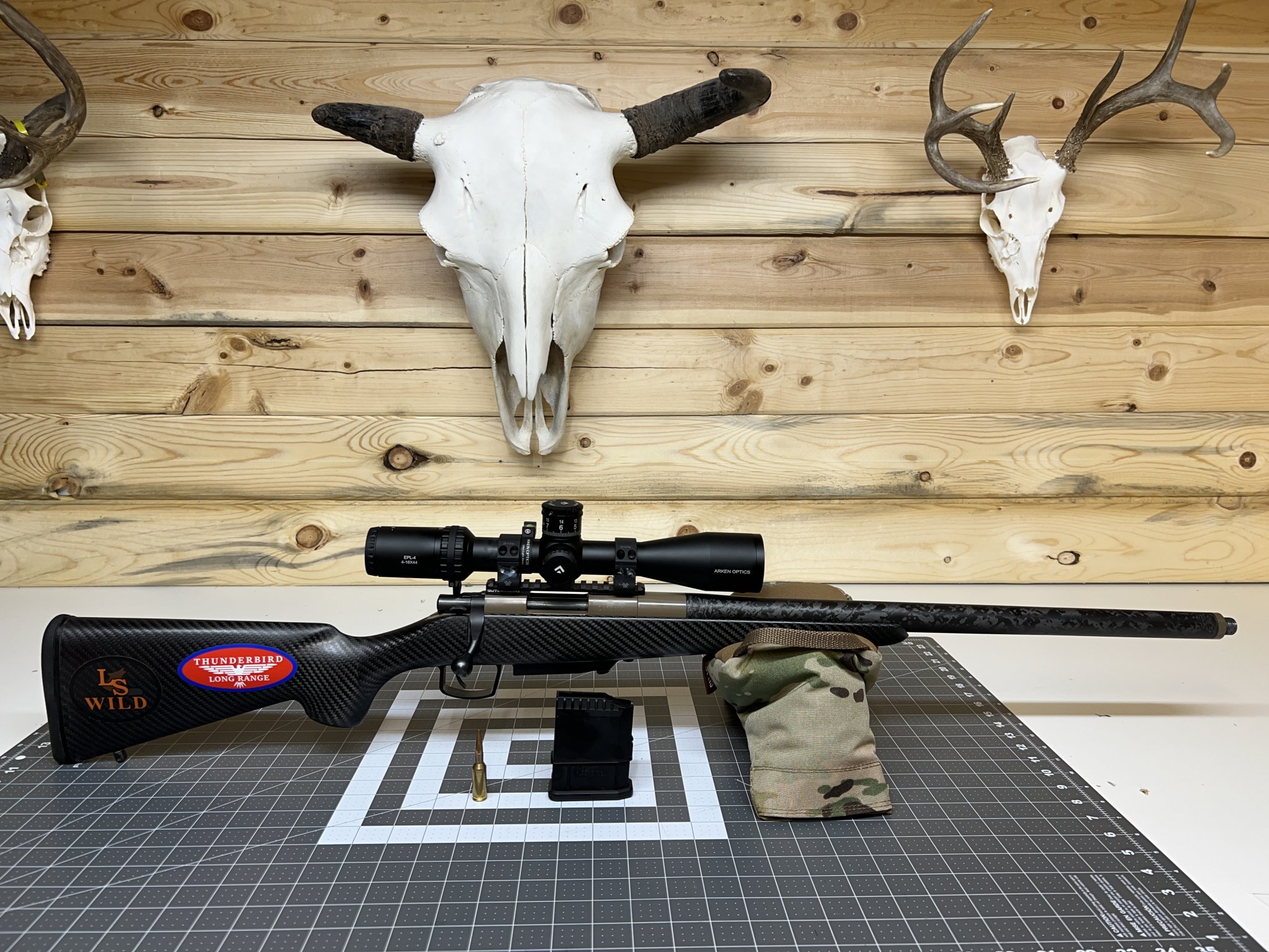

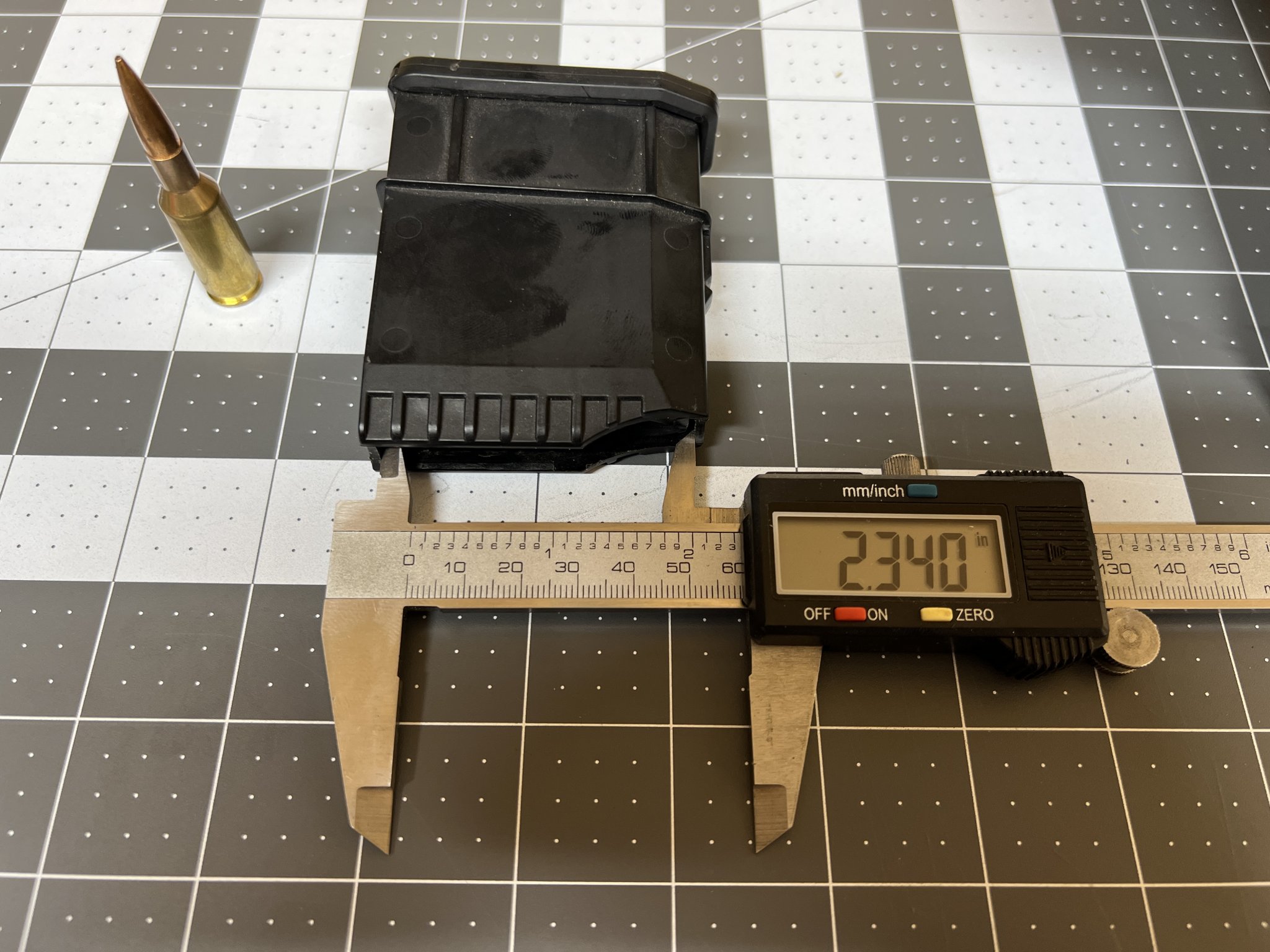

I am late to the thread, but I built a 6 BRA on a Howa Mini. I had to bush the firing pin to stop pierced primers. I was able to open the feed lips and shorten them to run the 6bra cases no problem. I am shooting 95 grain bullets. Check the over all length of your load to see if it fits in the mag. I will post pictures.
Love my little gun. I just got a Stockys VG2 for it.
They are 95 grain VLD-h

As a side point, I’m running the Jefferson hinged floor plate bottom metal in my .223 and it maxes out at 2.47.
