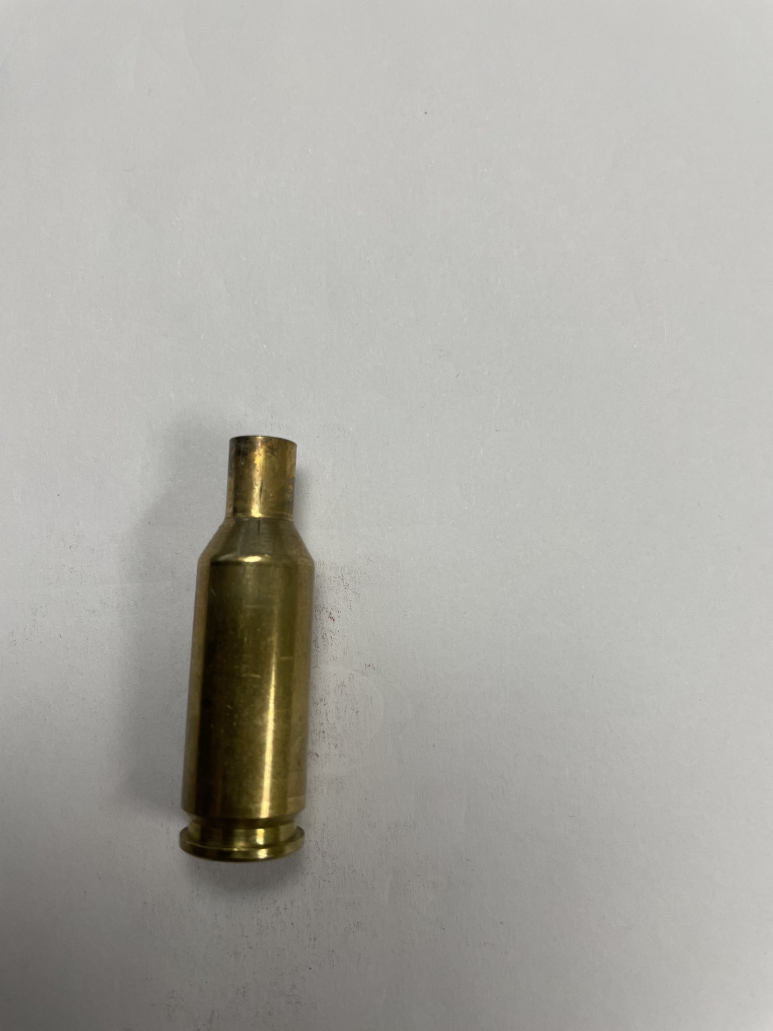

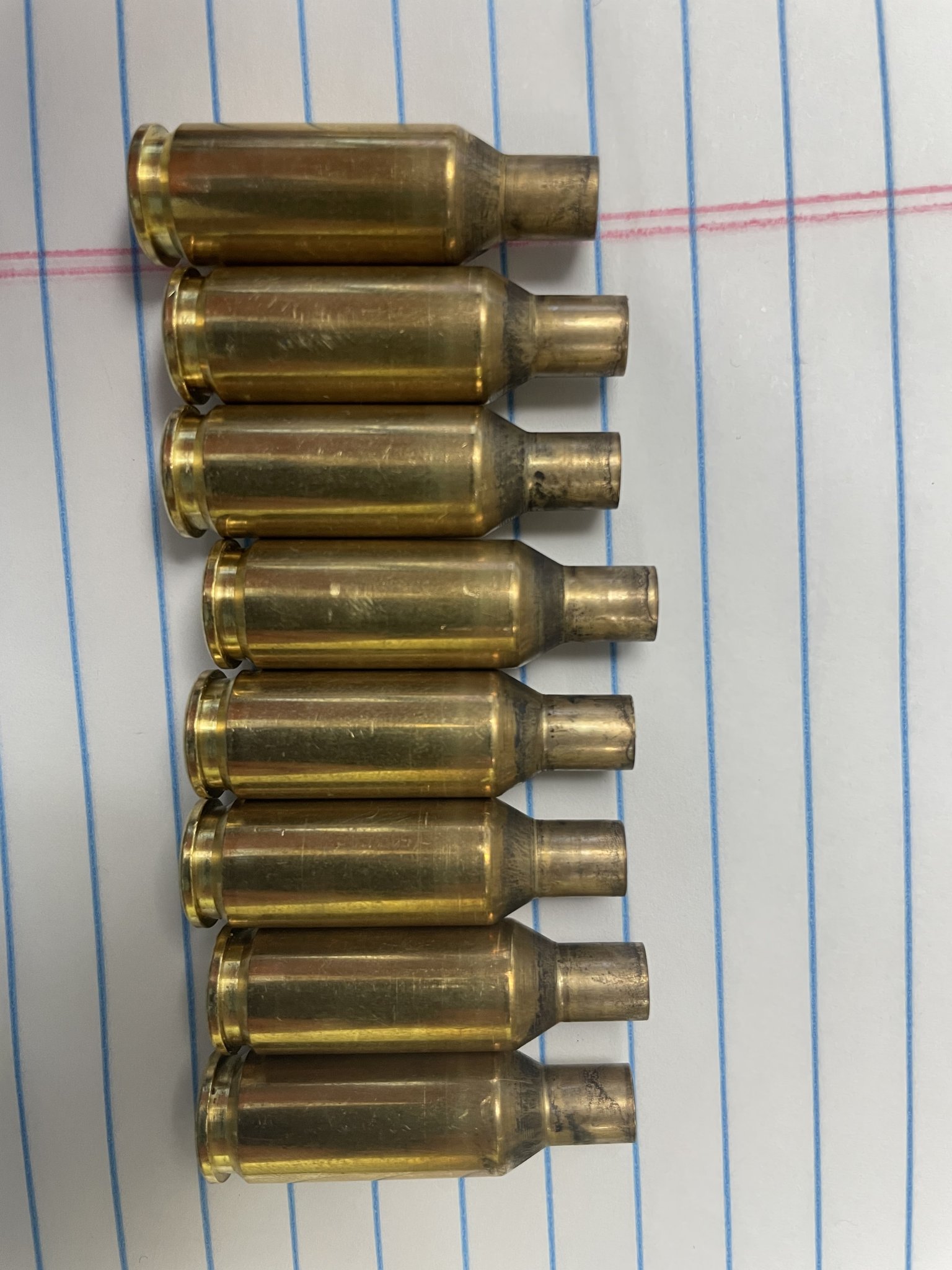

    Hello everyone, looking for advise regarding neck separation.
    These are the specifics:
    -Lapua Brass, 27 inch barrel
    -3-4 firings, no annealing
    -Overall length grew by 2-3 thou, no trimming
    -30.5 gr of shooters world precision pushing 105s at 2860(barrel sped up after last match)
    Running one thou neck tension with .268 bushing
    -bumping shoulder 1-2 thou
    Seems like the split is starting from neck shoulder junction.
    Any help with this would be appreciated
    Those look oddly uniform. Along with lash’s question above, do you have any virgin brass to look at from that lot? Did this just show itself now, or did it develop from the first firing?
    While unusual from Lapua, only time ive ever seen a shape like that it was a manufacturing defect.

    Why no annealing? That's not neck separation, that's simple splitting. Only 4 things usually cause that: Pressure, work-hardened brass, cheap brass or a chamber abnormality. I doubt it's faulty Lapua brass - and Lapua is top notch. You velocity doesn't seem that crazy (although I am unfamiliar with that powder pressure curve). That leaves pressure, chamber defect and work-hardening.
    What do the spent primers/case head look like?
    How are you sizing your necks? How much does the neck reduce in the full length sizing die?
    Using a .268 bushing, in a Redding full length bushing due. I believe the fired neck measured .272. What’s odd is that second picture also shows split on the shoulder area?

    I do have some new brass I can check out later. Iam almost sure it wasn’t there in the virgin brass. I noticed it after 3 firings or so
    Annealer is on its way…never annealed 6.5 creed Lapua brass and have close to 10 firings with no issues. Spent primers look good, still have roundness to them and bolt lift seemed fine too. No ejection marks on the case head.

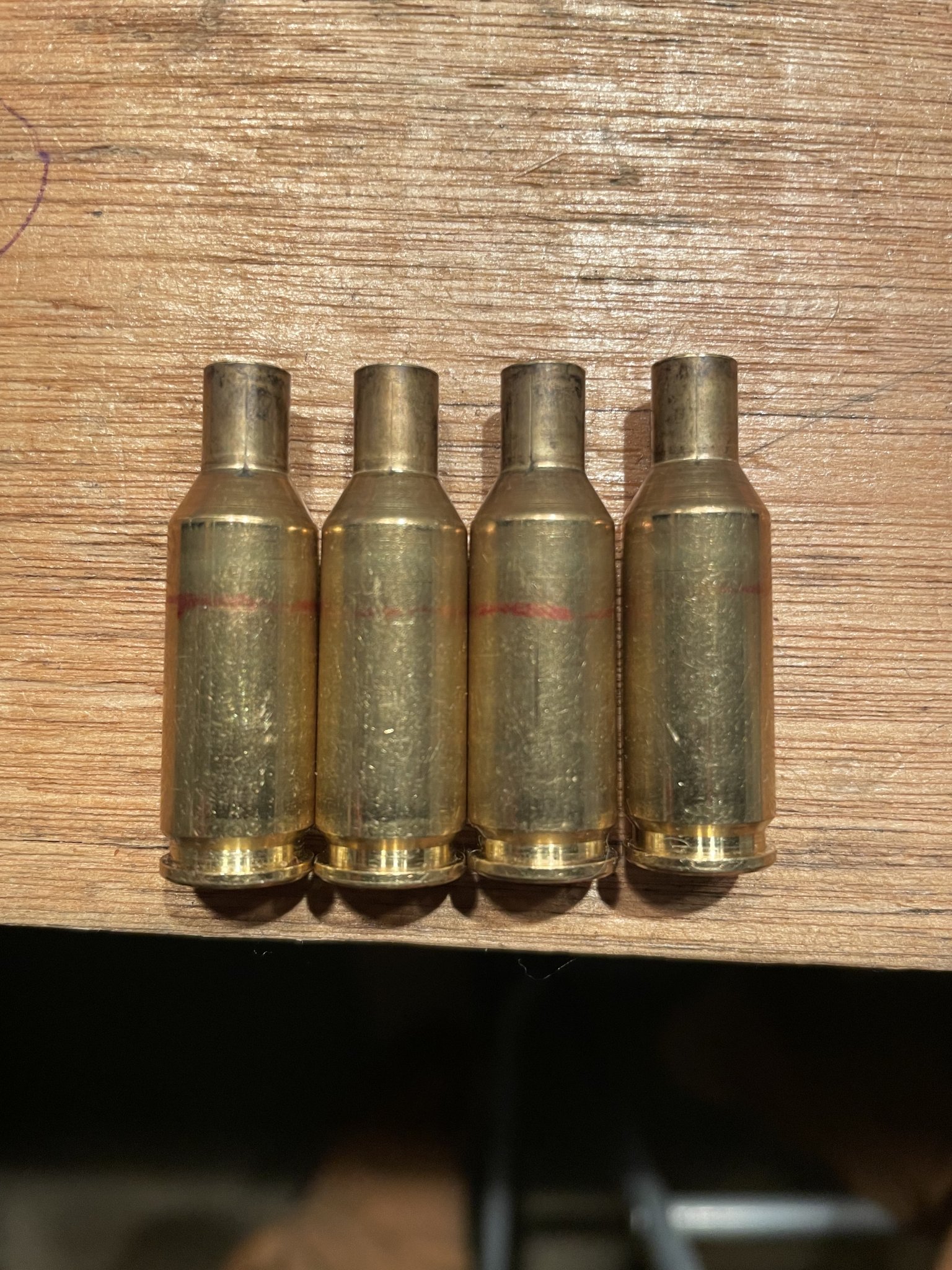

    Just to add another variable to this mystery. Iam getting a powder soot on the shoulder area after firing, maybe every third round. Not sure if it has anything to do with this, just thought I would throw it out there

    Zero. The fold is created during the process of forming the neck and shoulder. I think in your case it was concealed by the annealing discoloration and you didn’t notice it till now. It should not affect anything until it splits. And it could go on for 20 reloads like someone else mentioned earlier. I would monitor but not lose sleep over it.
    Reactions: Slate264
    Got you, but if you look at the second picture I posted with 1 case, it looks different and there is a split already on the neck and shoulder. Confused..I’ll keep monitoring the other ones. Thanks

    Okay. Your picture with the carbon at the shoulder is a hint in my opinion. It looks like for starters, that you are sizing those necks down 0.004”, which is too much. Combine that with the thick necks typical on Lapua brass and two things are happening. First the case neck is not expanding enough to seal the chamber, due to the 0.004” smaller dia. That is also causing the brass to be worked too much under pressure, which could cause stress cracking.
    Your sizing die should be honed out a bit to reduce the amount of neck sizing. It also sounds to me like at least this batch of brass should be annealed before sizing again.
    4-5 years ago I had a batch of 200 Lapua 6BR with several cases presenting those folds/creases. They were a little more obvious when I opened the boxes and inspected them. I just tossed them.
