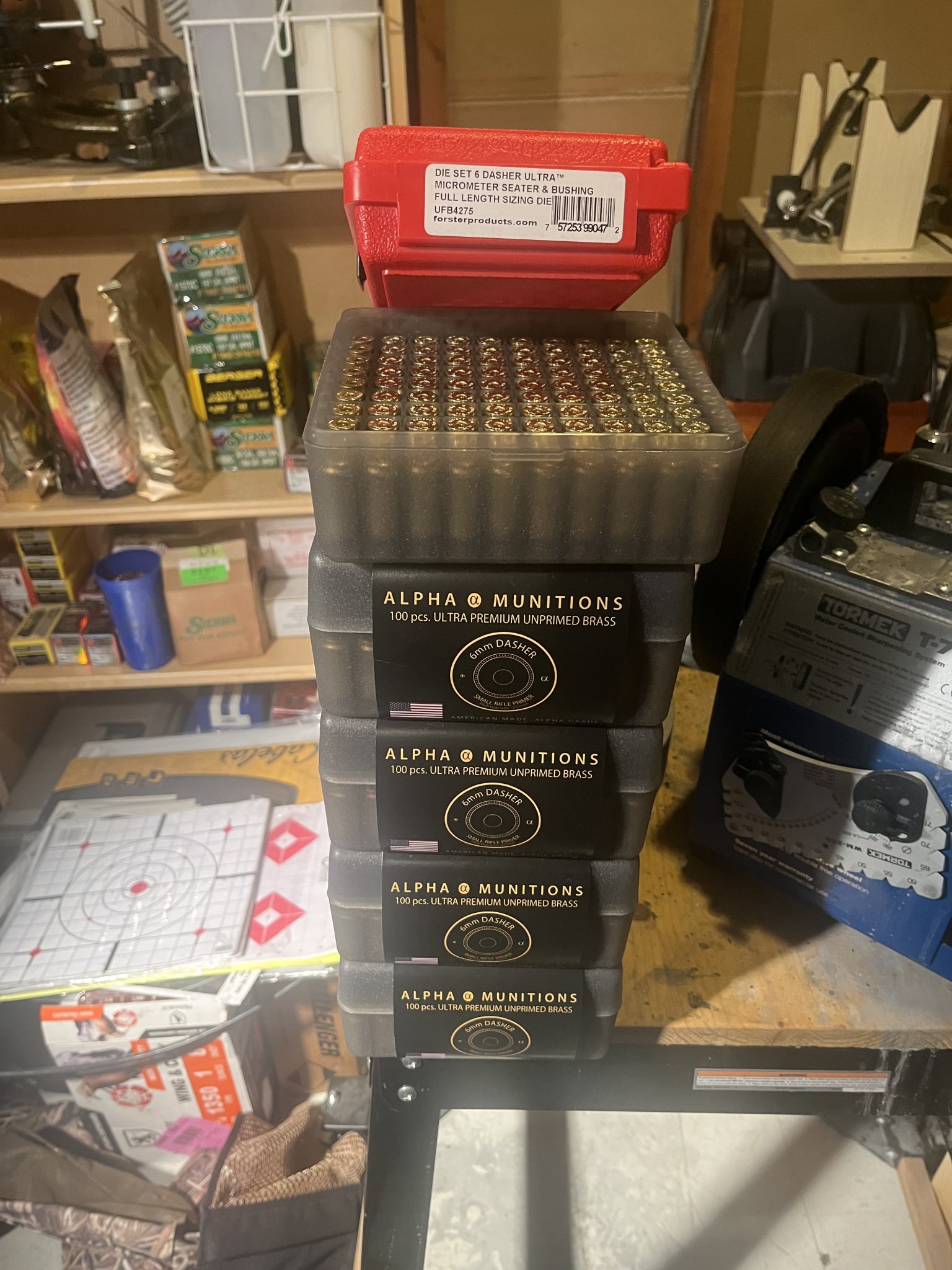

That's great news by the time I'm ready for a new barrel hopefully it will be available
Any chance you are able to share who's making the brass?
The whole buying hydro brass or using up a 200 rounds of barrel life was the only thing keeping me from
a Dasher. Instead been very happy with the 6br. But if you could give us a small clue as to who it might
be than I would get a barrel chambered for a Dasher and have it ready for when the brass comes out.
I talked to Alpha last year and they weren't to keen on making it. To many other things going on. ( 6GT, 25 Creed)
Lapua said they were looking at it. Petersen or ADG?

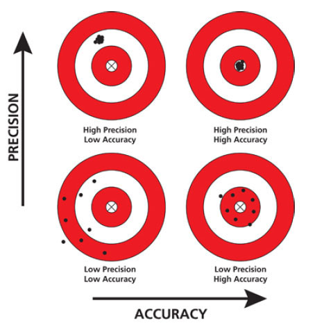

I wouldn't worry too much about barrel life if you're making 10k a day...
Accuracy is on the shooter, precision would be the term you're looking for, and I think you'd be hard pressed to objectively prove that the 6mm options you listed have greater precision than the 6.5cm. YOU will be the limiting factor by far.
The 6mm options are popular because they offer a better blend of low recoil and high BC bullets.
My dad owns a dealership, so obviously my form is impeccable. Joking aside I appreciate the response. I'm just trying to wrap my head around everything I'm reading. Seems there's reasons why F-class shooters and pros of the like lean to these 6mm cartridges because recoil management can play into your precision.
But also I've always heard it opposite to what you're describing. Accuracy is on the machine, precision is on the shooter. But tomato tomawto

Appreciate the reply, I think it's fair to say though that you have a wider margin of error on a 6.5cm though since it's a heavier bullet and thus less susceptible to wind.
But also I've always heard it opposite to what you're describing. precision is on the machine, accuracy is on the shooter. But tomato tomawto
FIFY. but the shooter and rifle still both have an effect on both parts
also maybe but not always with a 6.5 vs 6 and 'margin of error'. bullet vs speed.
This may help illustrate it for you:
Ballistic Coefficient (BC) is the number you should pay attention to not weight. There are lighter bullets that have a higher BC than a heavy bullet and will drift less in the wind. BC is also a function of velocity which is important to remember.

*sigh* I hate internet forums. Okay here goes: Yes I reload with high end equipment, yes I have a chronograph, yes I have a kestrel, yes I have a good tripod and rangefinder, yes I've shot a bees dick off at a mile (338 LM master race crew checking in), yes I have a UTV to carry my gongs 2 miles down range, yes I go shooting and drink scotch almost 30 weekends a year, yes I am new to the competitive format of shooting sports, no I'm not a poor retard.
Only a mile, eh, better practice a bit more, we expect a nat’s appendage at 2.5 miles. The bees knee is too large anyway.
On a more serious note, every 6mm ever thought off short of a .243 has been mentioned except the GT. It seems to work decently at the ranges you are thinking off, and can be store bought, and is no issue to reload. (My main gun loves 105 Bergers. The other has an affinity towards the 107 Sierras. Our son’s shoots great with the 105’s as well)
