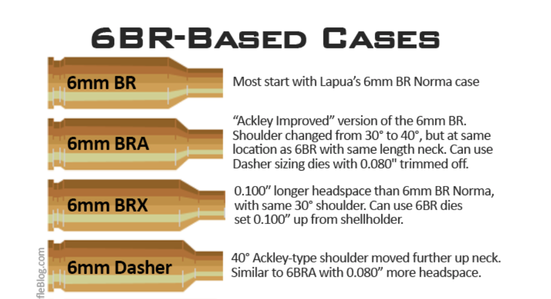

Anyways I looked for a Lee neck sizing die for 6BR or 6BRA but no luck. I did find a neck sizing die for 6mm CM & 6mm / 244 Remington. If this die is simply squeezing the neck back to 0.002" under the size of the bullet to be seated then wouldn't one of these work for 6BR / 6BRA? The fact that there are already 2 for 6mm makes me think I'm missing something.
For the Redding body die I cant find 6BR or 6BRA but they do offer a 6 Dasher. My understanding is that the 6BRA is identical to the 6 Dasher except it is 0.080" shorter so I could in theory purchase the 6 Dasher die and have 0.080" machined off to make it a 6BRA die. Is this correct?

Redding offers a body die for 6 Dasher, so if this graphic is accurate I'd simply need to have 0.080" machined off the bottom of that die to make it into a 6BRA die
