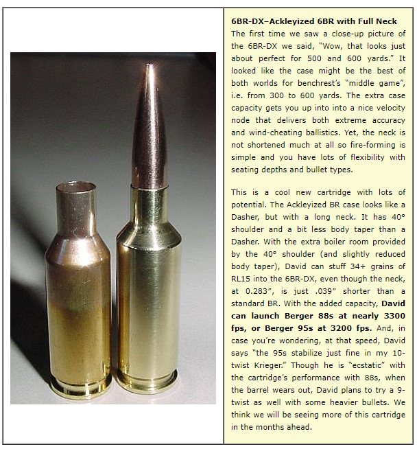

I already shoot 6xc and 6cm, so BRA was the most reasonable step down to perform inside 600ish yards. 6 Dasher didn't give anything more.
I also like the Ackley improved elements generally. Especially in the BR sized case, it gives me everything I want inside 600ish yards, and will push out reasonable to 1000.

I'm not familiar with that one. What is the difference between it and a dasher?
Looks pretty damn close to a BRA
Accurate Shooter Link
And Another
"The 6BR-DX–Specs and Load Development
The 6BR-DX is an improved version of the 6mm BR Norma cartridge, with a 40° shoulder. The shoulder is .462″ (just a couple thousandths bigger than a standard case) and the diameter at the web is .470″. 6BR-DX water capacity is about 39.5 grains. That’s about 1.5-2.0 grains more than a standard 6BR case, depending on your chamber. That extra two grains is enough to give the case performance nearly on a par with the 6mm Dasher or 6 BRX, with the 85-95 grain bullets. This case will drive those pills plenty fast. I’m able to run the Berger 95s at 3200 fps, pretty much as fast as you can push them with a Dasher.
But compared with a short-necked Dasher, fire-forming the 6BR-DX is much easier. It’s very simple in fact. After turning the necks to .262″, we simply load the cases with a good “full-power” load for a standard 6BR and fire. Creating a false shoulder or doing other tricks is not necessary."

exactly.
