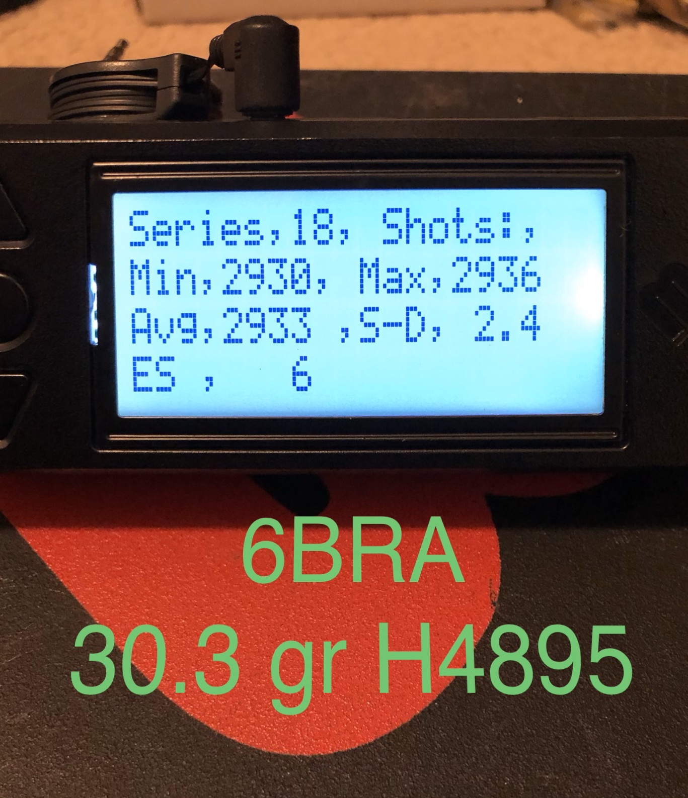

so im running a 26" bartlein 7.5 and ran up to 30.8 4895 and i think i just broke 3000 4895 did not shoot that great and was to temp sensitive for me.
that said if your going to run 4895 you need to turn that load down to about 2975ish...my suggestion would be to switch to varget now and be done....start at 30g and work up to 31.5 with a 105...look at that little tiny case...2950-2975 is plenty fast....i had 16 loads on my last 110 pcs of brass with 105s at 2975 and 109s at 2940-2950...if it dont shoot close to the lands jump them .060 plus off the lands...and/or switch to better bullets.

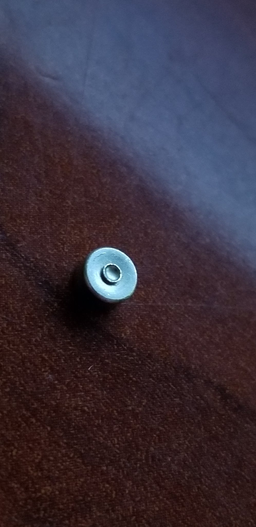

You might try changing primers to those with thicker cups like Rem 7-1/2, CCI BR4 or 450.
THIS.
Chart is old but it shows how the 400s are thin low pressure primer. Get something more capable and your premature primer pressure signs will go away.

I've attached a pic of one of the primers. Looks like the moon

I just put 2500 rounds on a 26” gain twist Bartlein. I started out with 30.4 grains of H4895 at 2930fps. it’s at 2917 now with 31.4 of Varget. Reading primers is difficult. Speed comes with pressure.
so you got 2500 rounds out of a 6BRA? good accurate rounds?
Yes it’s still shooting at 100yd. I noticed it starting to open up at distance. But not by much closer to 1 MOA at 700 yards and further. Borescoped the barrel and the throat is rough. It’s starting to firecrack but nothing like a Creedmoor at 1000 rounds. I’m thinking that is creating a wide ES on the BC of the bullet. This is an 8 shot group at 2400 rounds.
