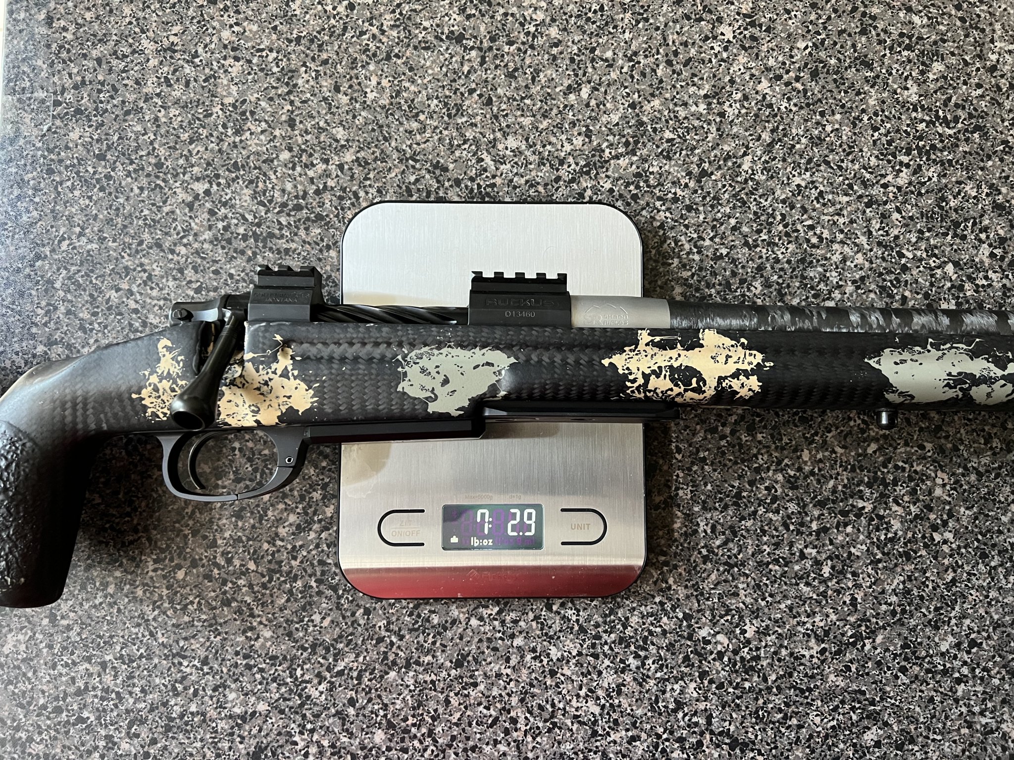

    I'm in a similar situation, but I'm building a handy/hunting rifle in 6GT not 6CM. For me, the 6GT will provide enough velocity for my purposes without being an $800 barrel burner. The carbon barrel combined with other lightweight parts will make for a really light weight and pleasant to shoot rifle that I won't mind carrying around and hiking with. I doubt the rifle will be shot a ton, and expect the barrel to last years. (3k+ rounds in my PRS barrels)

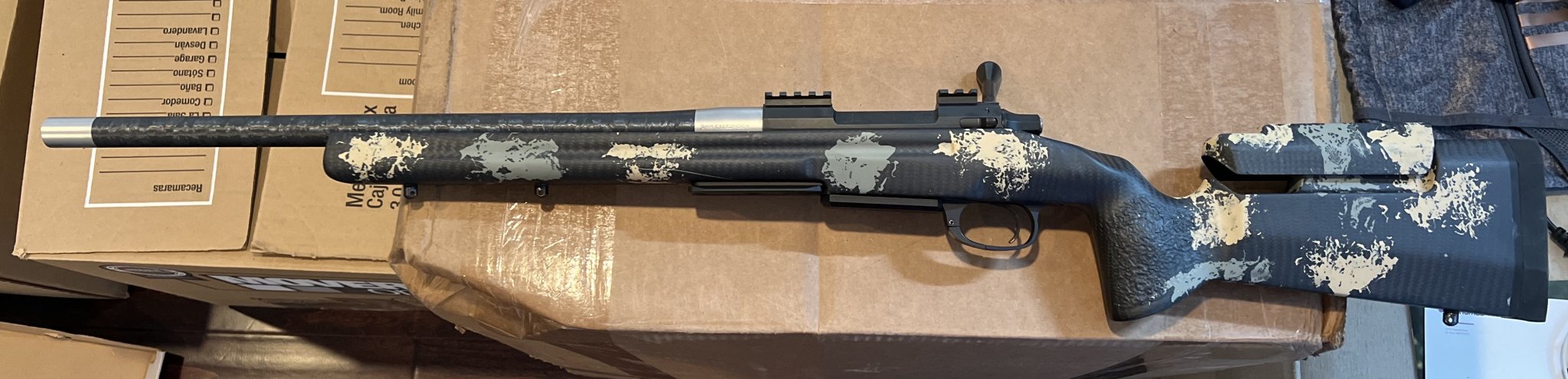

    Sorry i mistyped.
    Bart #13 CFW, 20”, 7.5 twist
    Ruckus GA Hunter
    Manners LRH
    APA RTG
    TT primary will get switched to TT Special
    TBAC ultra 7 6.5
    Smithed by @Shooter71

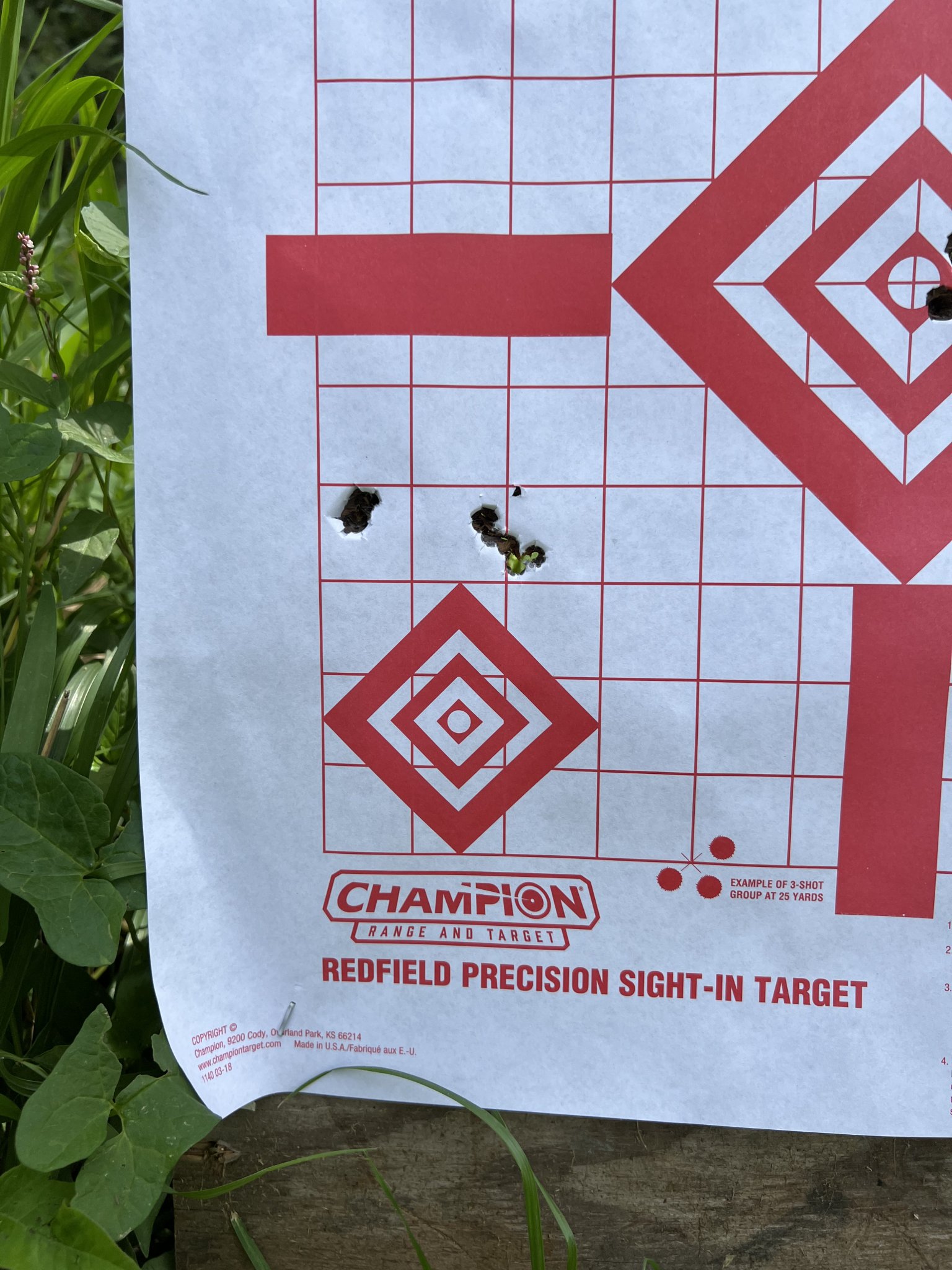

    It likes Berger factory 105 hybrid ammo
    3 shot group on left, 6 shot group on right
