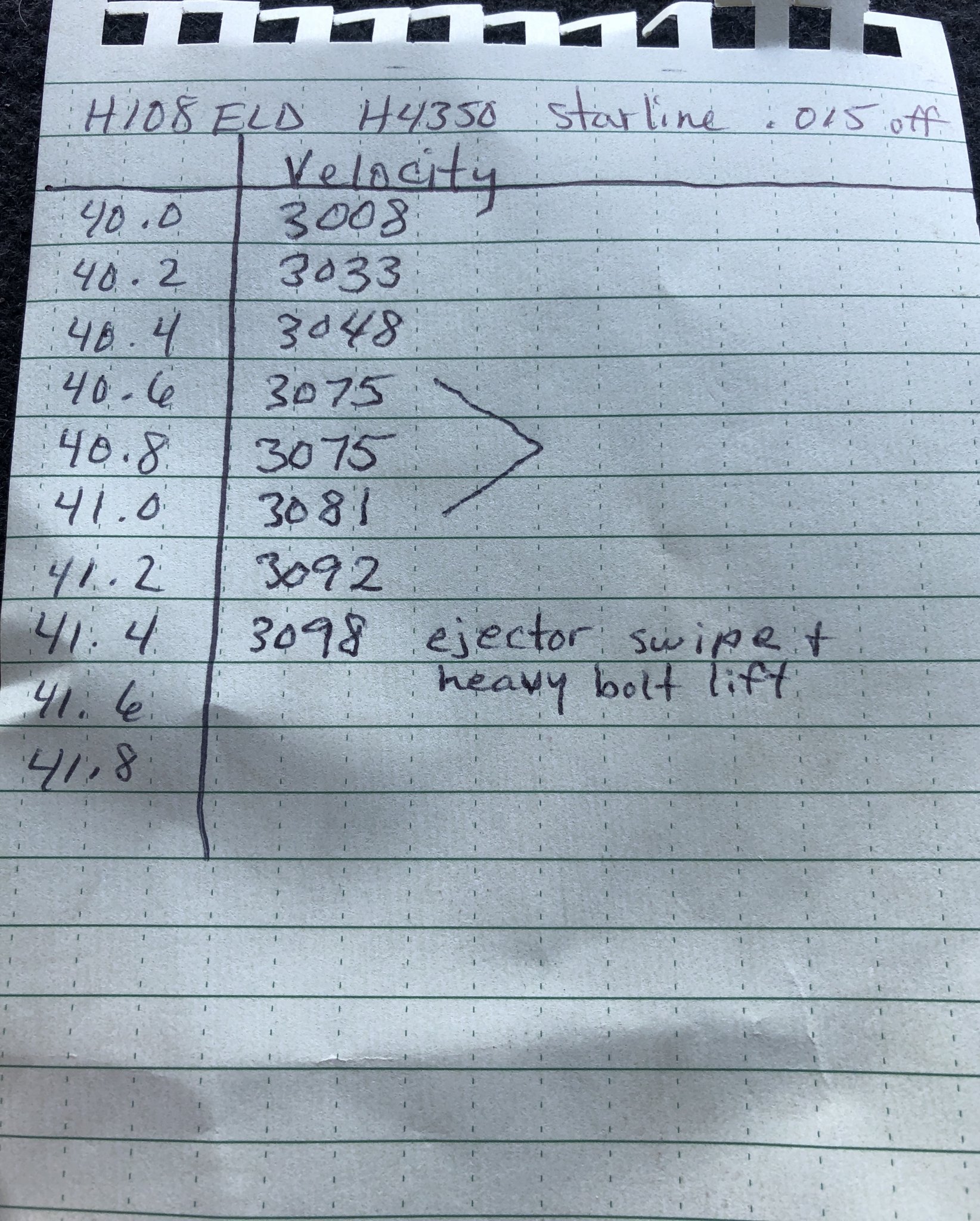

Results from today's load test. I'll probably load .6 - .9 by ones, and look for best consistency. Then play with seating depth.
What do you guys think?

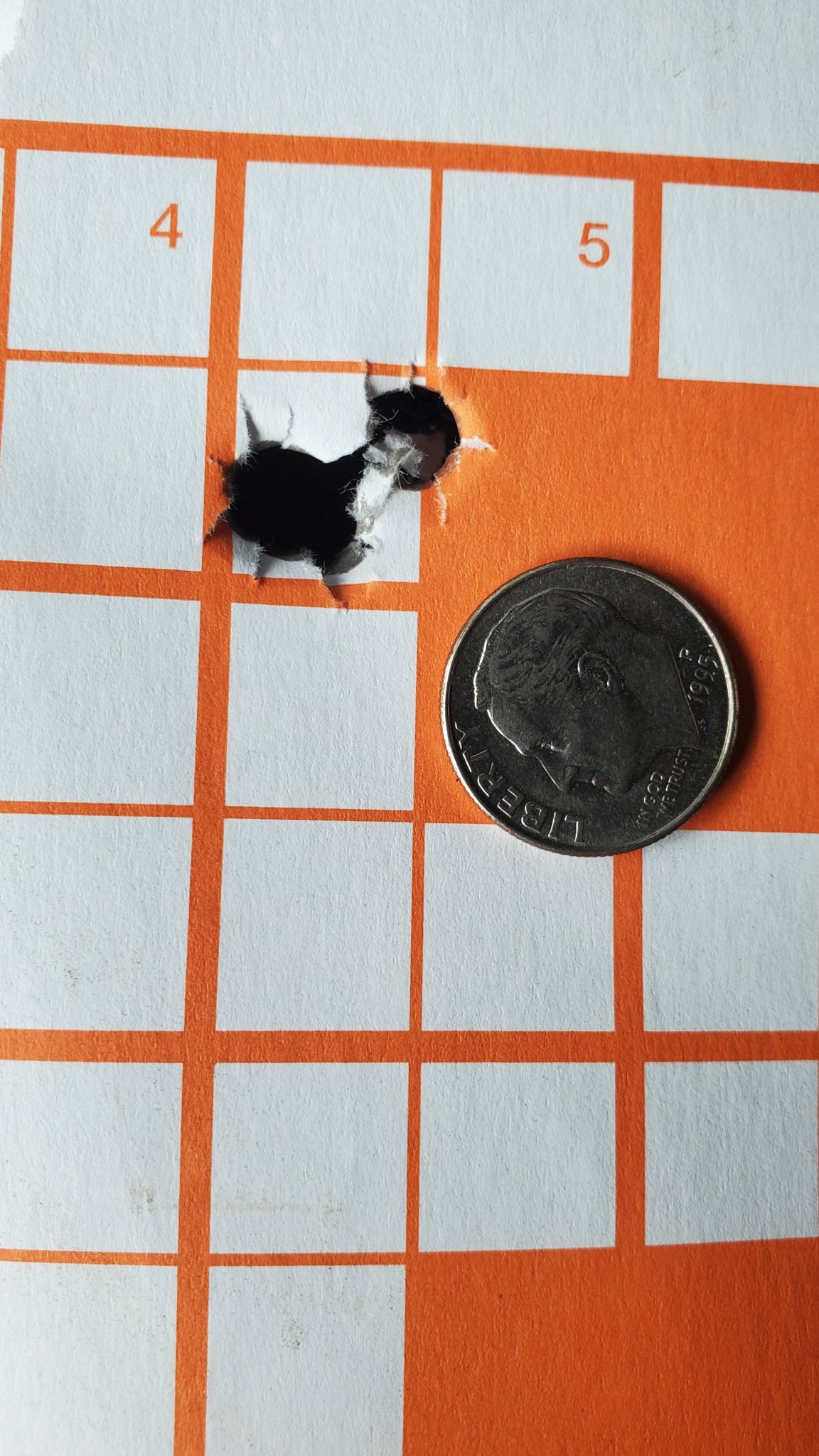

It's just a barrel, no point in having a hot rodded 383 stroker and putting a 2 barrel on it. 41.8gr h4350, lapua brass cci450 and 105hybrids were good for 3090 in a 26" criterion. 41.4 gr rl16 and same components ran 3130fps
5rds rl16 load.
