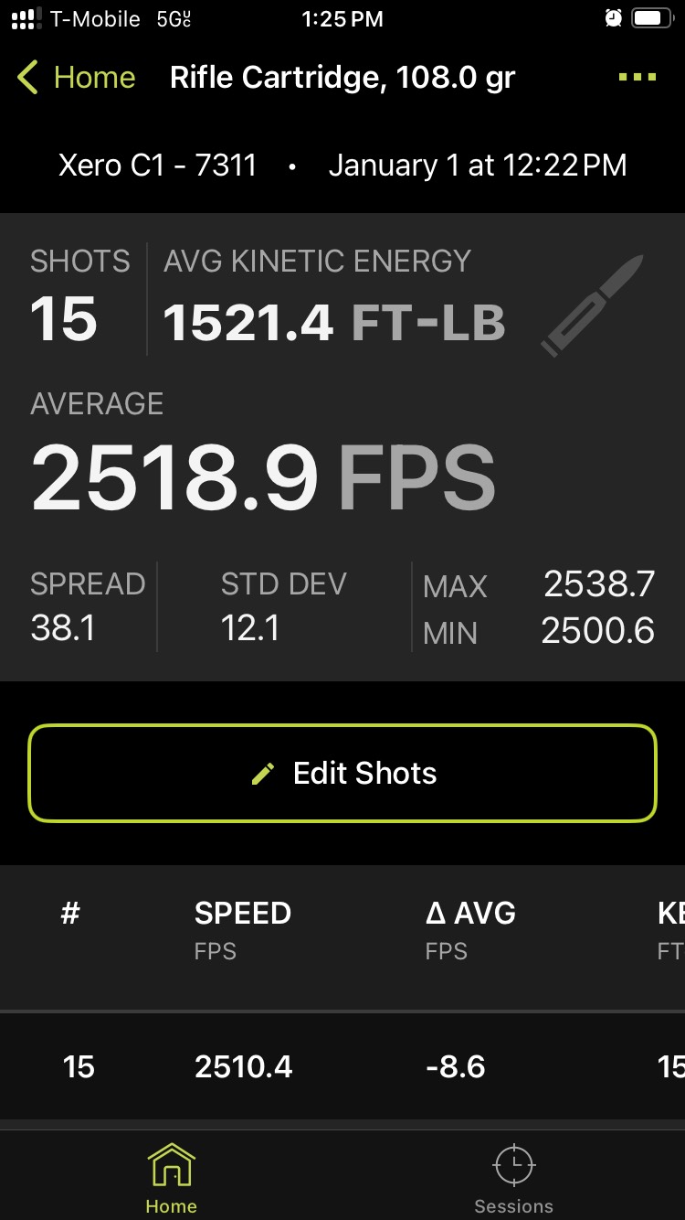

    I will leave the analysis to others that may be smarter and more experienced but here is my chronograph data for a 16" 6 ARC out of an AR with factory hornady 108 ammo
