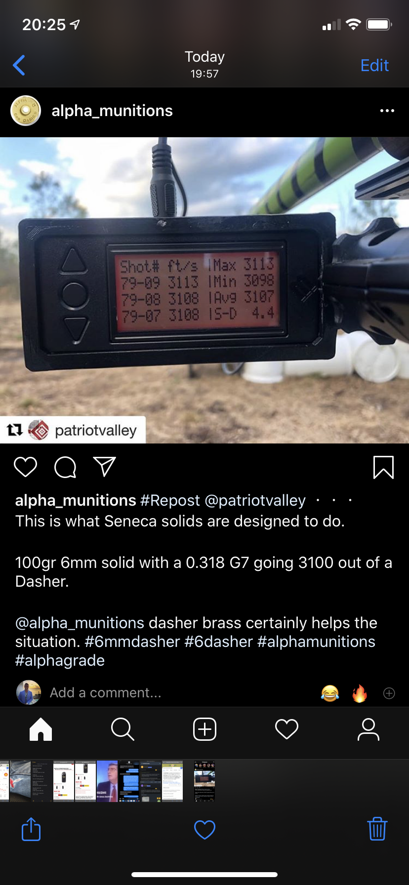

I know guys that have run dasher hot 3000ish+ and burned them in 1400-1500 rounds. Both cartridges are good choices. I ran a BR last year. BRA this year. If I was starting from scratch I’d seriously consider a dasher with alpha brass. If you plan to use lapua brass I’d go BR or BRA as there is no to extremely simple fireforming. The dasher is a little harder to fireform consistently
Reactions: Sheldon N
