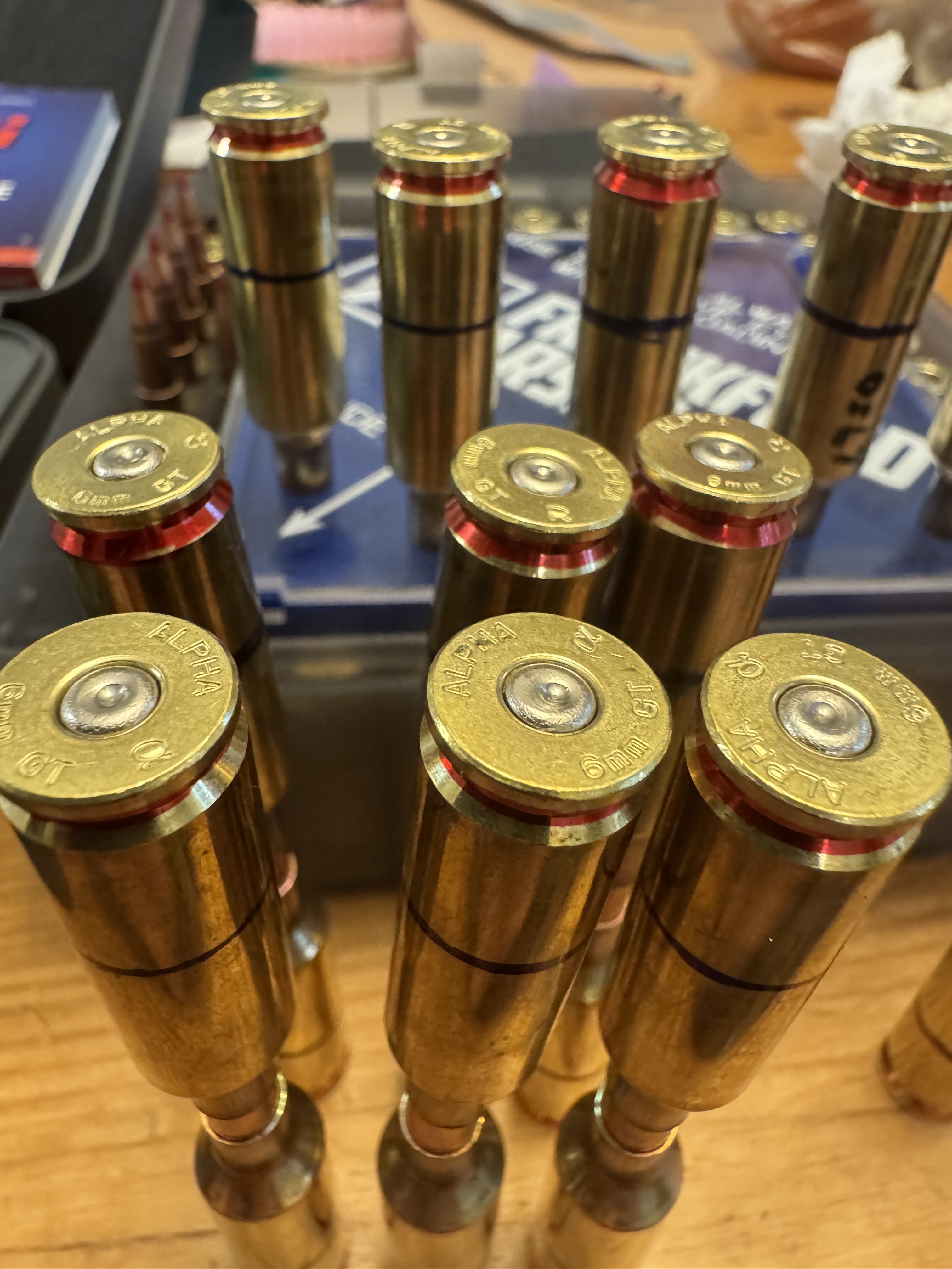

Hi all,

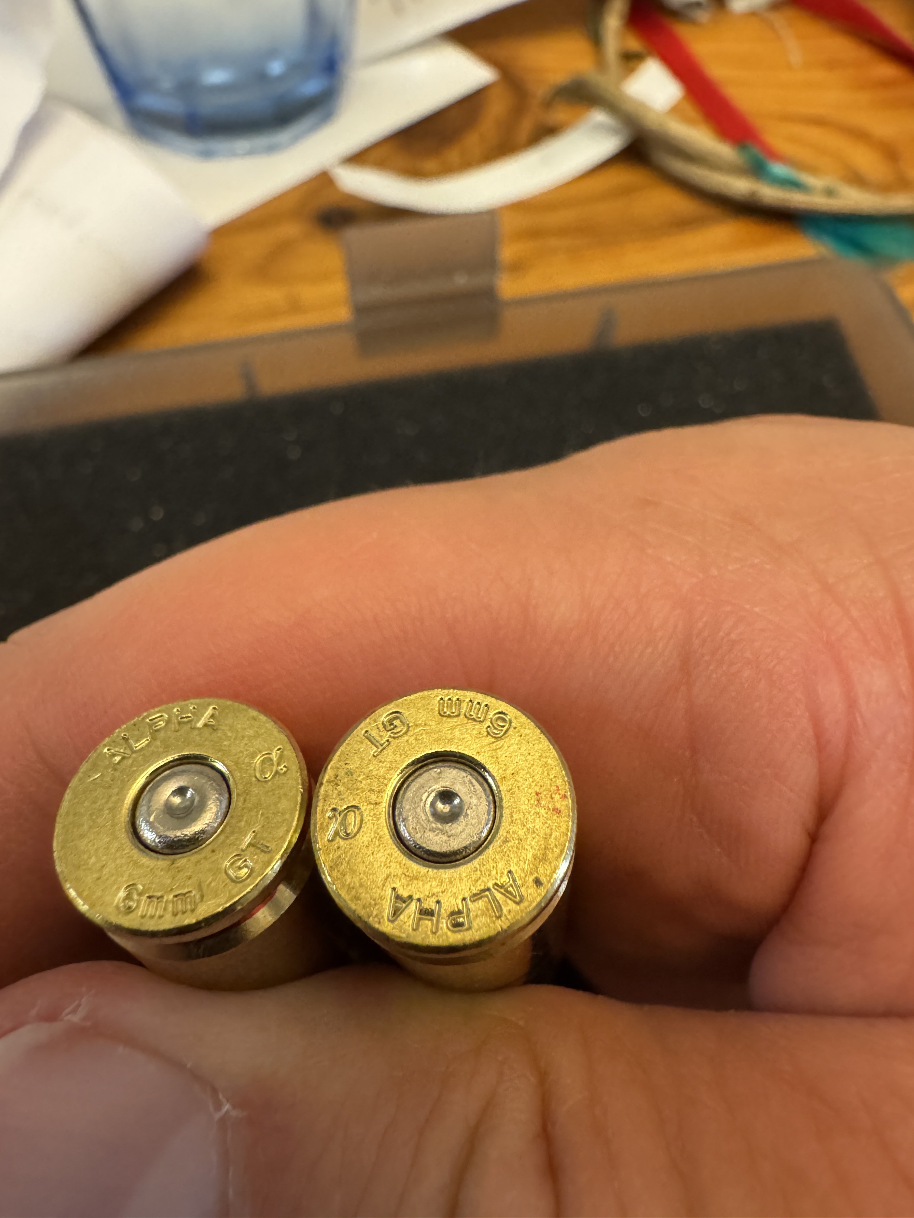

I recently broke in a new 6gt build with an ARC CDG. First 20 shots were all factory Hornady/GAP ELDMs and ran fine. My next twenty were my first reloads in 6 gt. Virgin Alpha brass with CCI 450s, 32.5 gr Varget. About 7/10 in each row failed to fire. Light primer strikes. I seated the primers with the Frankford hand primer, though they tended to catch a little on insertion. I’ve since found that i was using the larger primer keyway in the tool with the small primer “ram” piece. I’m not sure if this issue is more related to primer depth or the incorrect tool configuration or something else. Any advice? I’d like to fix my reliability issue with as few trips back and forth to the range as possible since my opportunity to test is limited.
In the picture, the round on the left did not fire, but the right did. What does the rounding on the left primer indicate?
I haven't pulled the bullet, but I can hear that there is definitely powder in the case. The sound was just the firing pin "tink". Definitely 0 ignition. I also recocked several and tried firing them multiple times, with no luck.

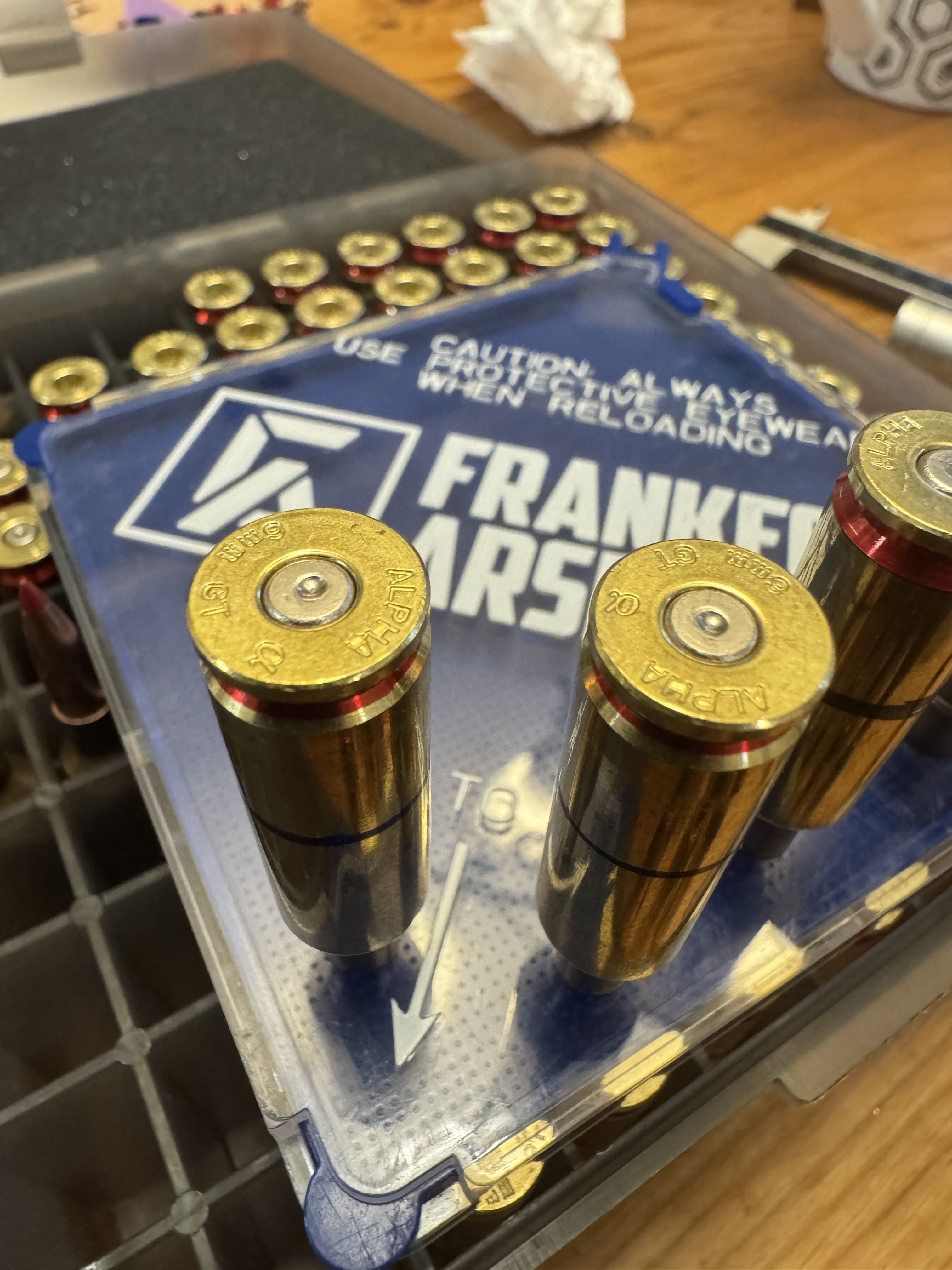

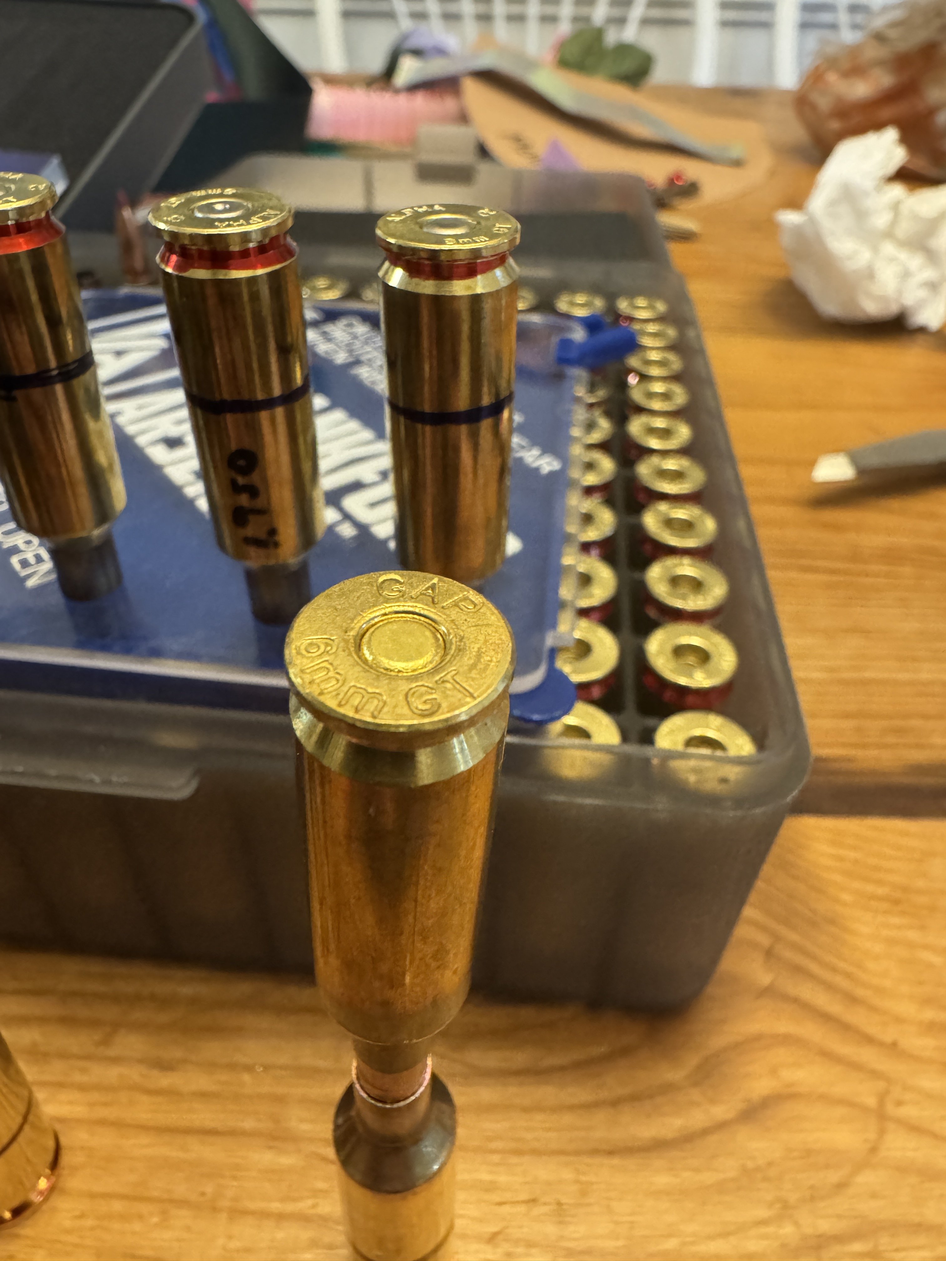

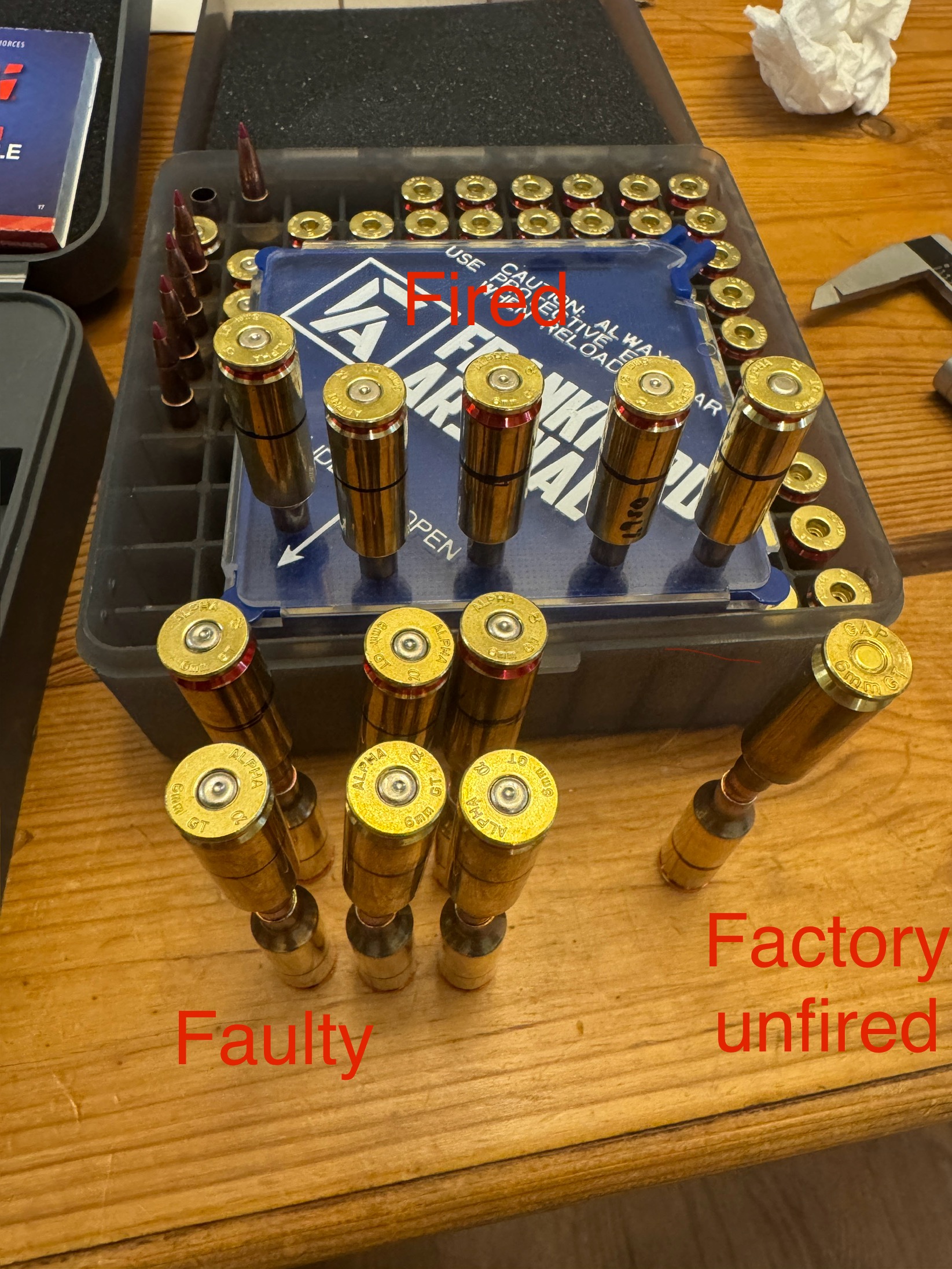

Here are some headspace measurements:
Unfired Factory ELDM: 1.3570
Fired factory ELDM: 1.3580
Faulty round: 1.3555
Virgin unloaded brass: 1.3505
Successfully fired reloads: 1.3560
So the fire formed cases are clearly 2-3 thou bigger, but then, some reloads fired with 1.3560. The virgin unloaded brass is even smaller according to my measurements - not sure if seating the bullet should change the way it measures in the comparator. If this is a headspace issue, it begs the question- how are you ever supposed to fire form virgin brass if it’s too short?
The primers on the factory rounds do appear to be 2-4 thou below flush, but this is with a different brand of brass entirely.
When I crank my priming tool to the deepest setting, I can seat 2 thou below flush by really muscling it - this puts an indent on the primer though.
Hoping it comes through in the pictures, but the primers on the faulty ones just really look different to me. Very rounded, like a donut. Whatever that is seems abnormal.
Reactions: RegionRat
It’s because they didnt make 50-60k psi blowing up to force the material back against the bolt face. You just have a little dimple from the firing pin.
The fired brass being shorter is normal, it will fill the chamber better in subsequent firings. It’s not just getting bigger length wise, it’s swelling up in diameters too. That swelling to fill the cylinder pulls some of that material back a bit, hence the not fully grown in length.
It’s not just the empty chamber space that the excess firing pin protrusion has to overcome, it’s the cartridge moving in that space over time, and it’s mass absorbing the impact force like a shock or strut, that lessens the impact on the primer. Impact being needed for it to go off.
So it important that it doesn’t have too much free space in the chamber for the case to slide forward into, off of the bolt face. It’s also important that the primer is seated to the bottom of its pocket so it also doesn’t absorb and spread the impact force over space when the firing pin seating it fully to the bottom of the pocket.

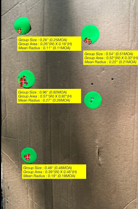

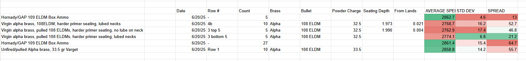

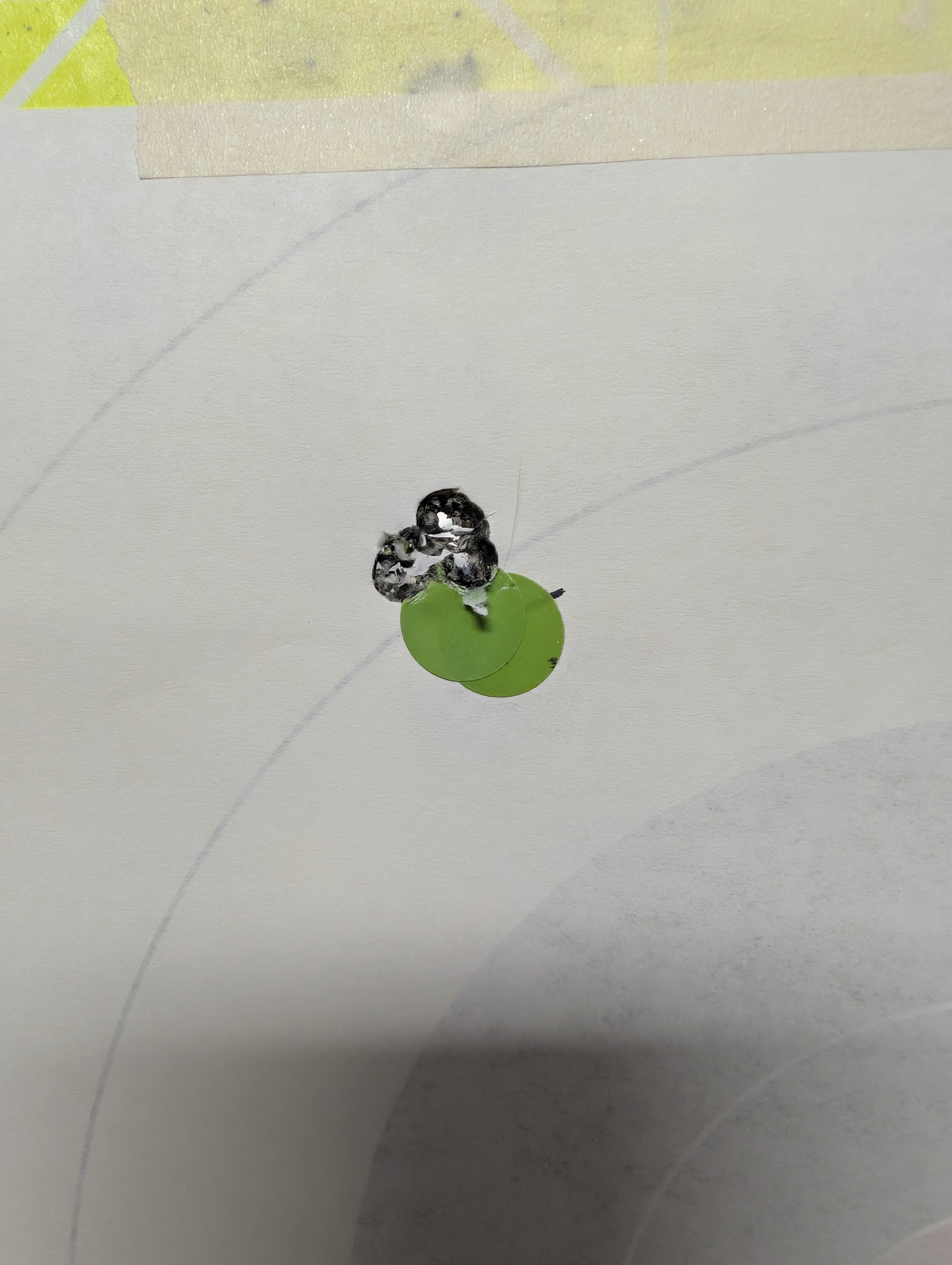

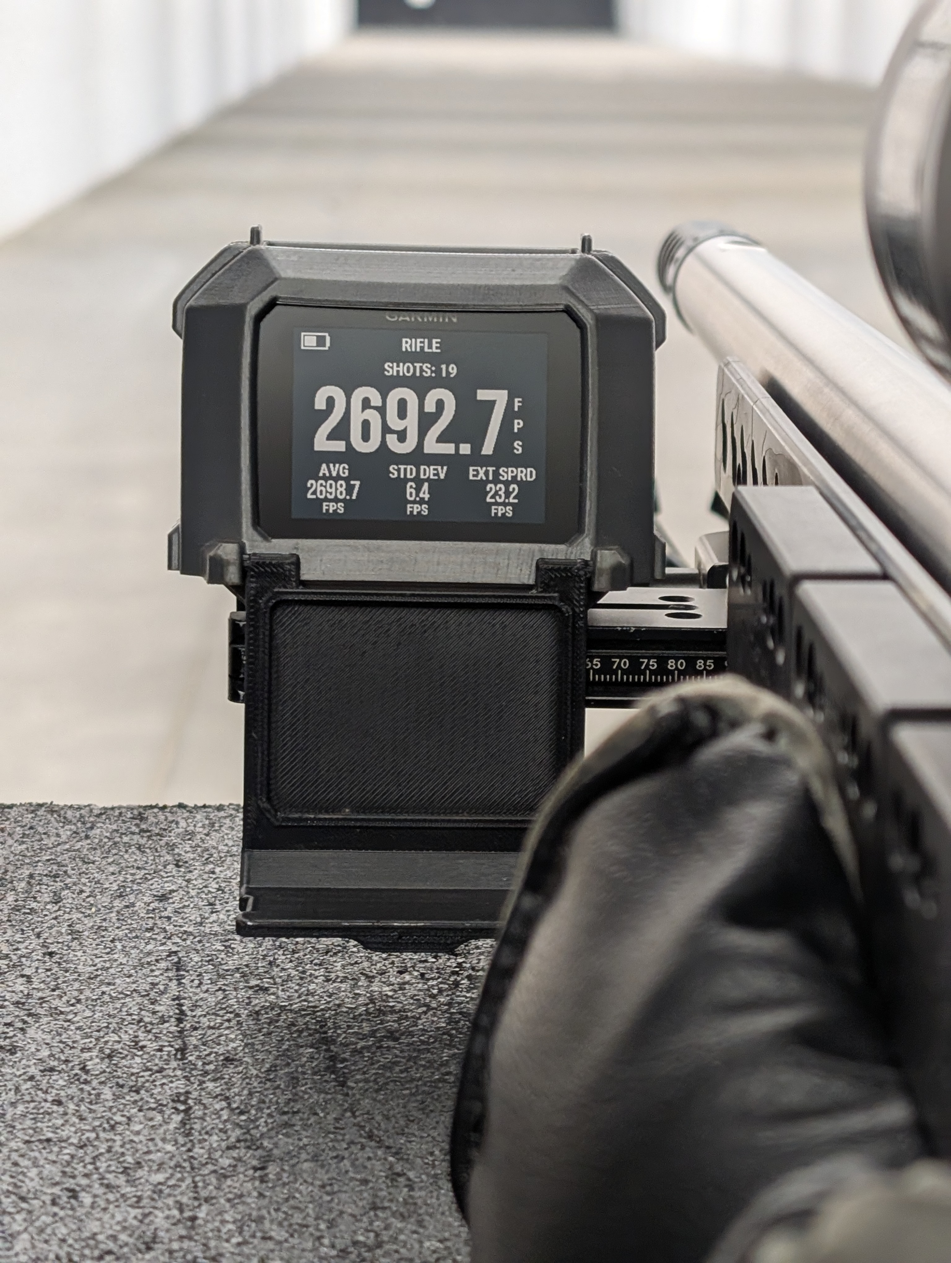

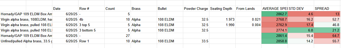

I made it out to the range today to test a few permutations and found some good news. I pulled bullets and redid all but 3 rounds. Of those ~40 I reworked, every one of them went off, with just a single round that took a recock of the bolt to go on the 2nd try. This was with my primer tool set to max depth, with the correct plunger guide, and being sure to seat the primers "hard". So that's great - my initial problem is solved!
What's interesting is that my best SD group was for some brass that was virgin, except I had pulled the bullet and reseated it after re-priming - with a light coating of lube inside the neck with a q-tip. That 5-round batch was .51 MOA, while a similar 5-round batch (except no lube) netted .25 MOA.
Granted, SD doesn't correlate that strongly to group size - the .46 MOA group I saw with 33.5 gr Varget came in at 14.2 fps SD.
All that said, I wonder if a mandrel is the way to go - I don't have a mandrel die but I do have the Forster FL bushing die. Should I assume the bushing die wouldn't accomplish the same with virgin brass? I would be nice not to have to "season" every piece of virgin brass before it's match ready. If there's a mandrel option that's cheaper than the $237 21C is charging, I might be able to swing it.

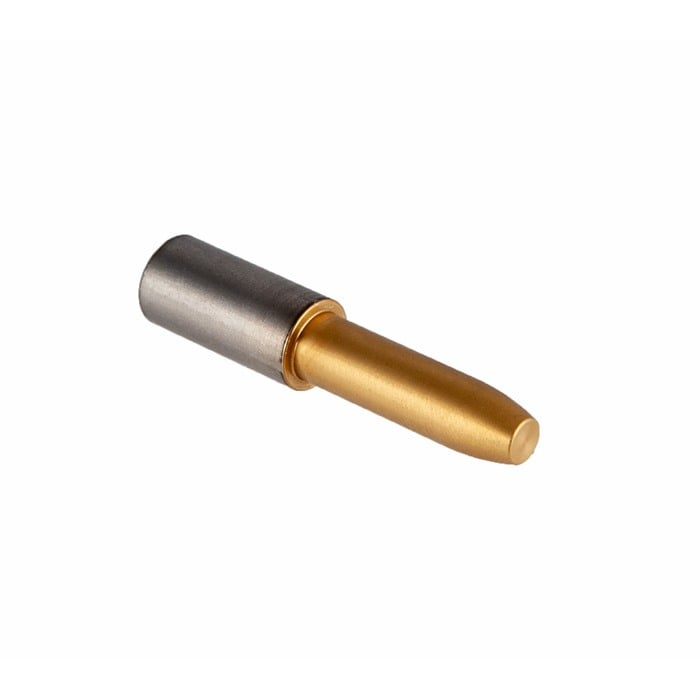

The Sinclair ones are OOS, but I see what you mean now about the 21c ones being less than I thought. So with 21c having every half-thou increment under the sun, should I get -.001, aka .242 for 6 gt? I don't really understand why people are recommending .002-.003 neck tension but -.001 mandrel sizes in various places.
And what is the difference/need for a turning arbor? Not much info on the 21c site except that they say "you can use the arbor *as* an expanding mandrel". Do I need both?
And I assume this is not a substitute for FL sizing, right? So you would FL size, then mandrel, then clean? Or if using their dry moly lube, maybe you can FL size, then clean, then mandrel?
So... if you were buying these for actual neck turning, you generally want to expand the case necks on virgin brass, and then use a mandrel that is 0.001" smaller as a pilot in the neck turner itself. For .308 Win, that would look like a 0.307 expander in the die, and a 0.306 expander as the pilot in the turner.
If you're just planning on expanding necks for reloading - not for neck turning - then it gets a lot simpler. Pick a mandrel that is 0.002 or 0.003 smaller than your nominal bullet size. Usually that's the easy-button go-forth-and-do answer. Sometimes, if you're a little bit OCD, things like brass spring back start messing with the numbers turning out *exactly* the way you want them to. If the gun shoots acceptably, don't worry about it. If you want to know more, get some pin gauges off Amazon so you can get a better read on what the neck ID is a) after F/L sizing and b) after expanding with the mandrel.
