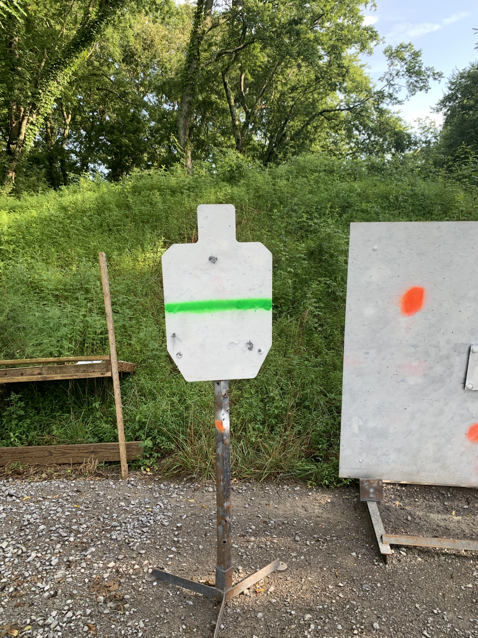

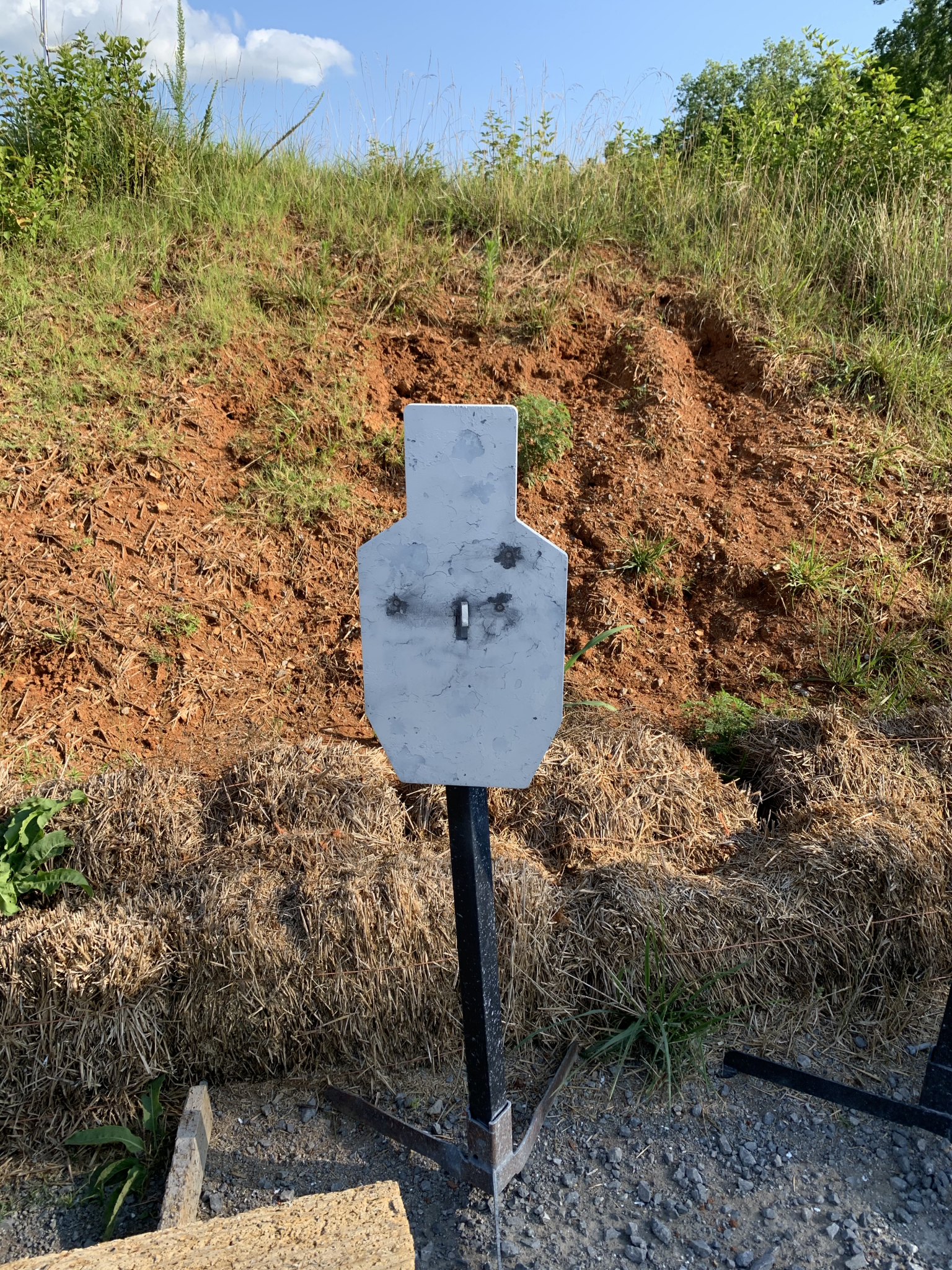

    This is at 750 yards off a tank-trap/Shmedium while sweating my balls off in wonderful TN 100% humidity between downpours:

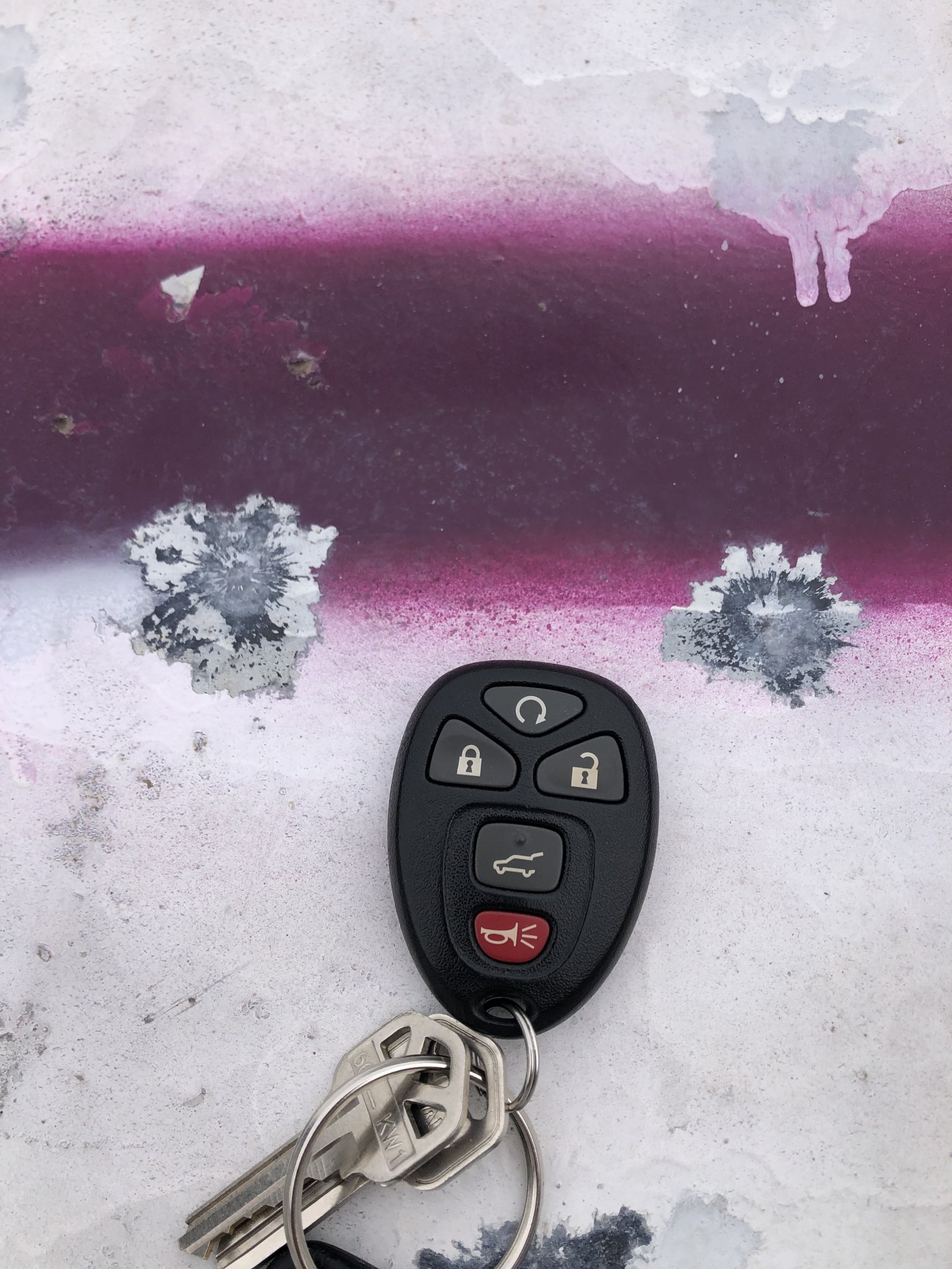

    3 shots at 1250 yards:

    View attachment 7667043View attachment 7667041View attachment 7667042
