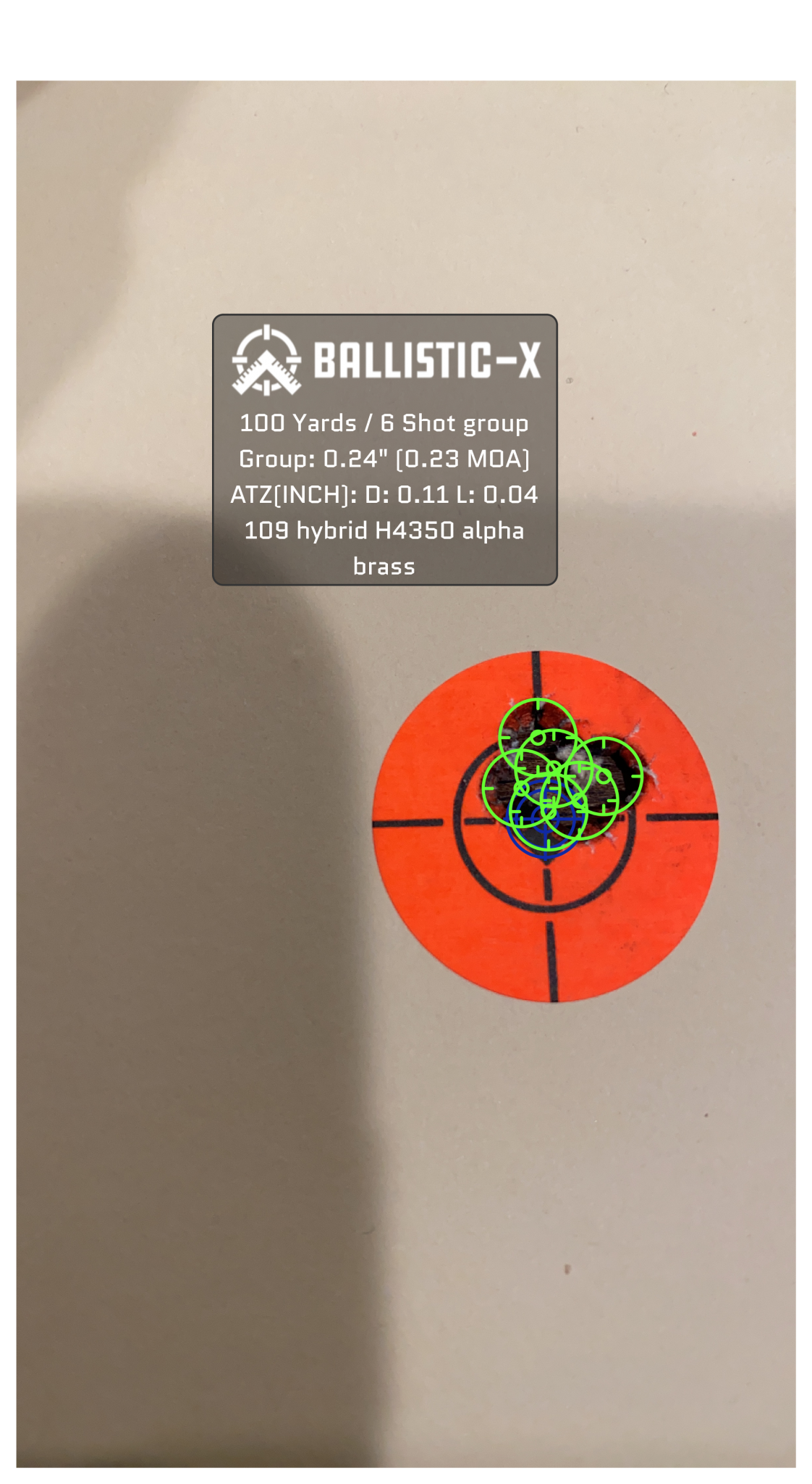

Into my second barrel spun on before JC steel
6 + firings in Hornady brass ran the 109 and the 105s primarily 2950 speed , groups well out to 1k.
Ran this same load a JC steel and it rained all
Day Saturday , wet mags, wet chamber and no signs of pressure running h4350 and Hornady brass primers pockets are still solid .
Currently running the alpha brass and running 2960 with SD in the .2s and 3s And 105 hybrids seem to be more consistent to me .
Blue collar reloading had alpha brass and GA precision has Hornady, ran both can’t go wrong either way !
Good luck

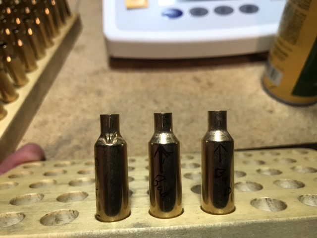

Has anyone besides myself had problems with the Hornady brass it seems like every time I buy some(400 PCs) There are cases with split necks or crushed shoulders sometimes one sometimes three or four per hundred. got 200 pieces of brass from GA Percision 100 from Swannies and 100 from Midsouth shooters all had pieces that were bad.
Damn thats no good.....I have always thought the hornady stuff was solid
saw a post from GA a few days ago that they had 6000pcs of GT hornady brass and more was coming at end of the month. i picked up 300 pcs from swannys last month went thru all, weight sorted and inspected. only one with a split mouth. have not shot any yet.
Reactions: Gaytigertango
I had that with mine. But, out of the last 500 pc
order, I had to throw out 4, lost 8, sent 10 off for someone to test sizing dies, and have 508
pcs remaining. GA sends extra, so I don't consider it a big deal.
