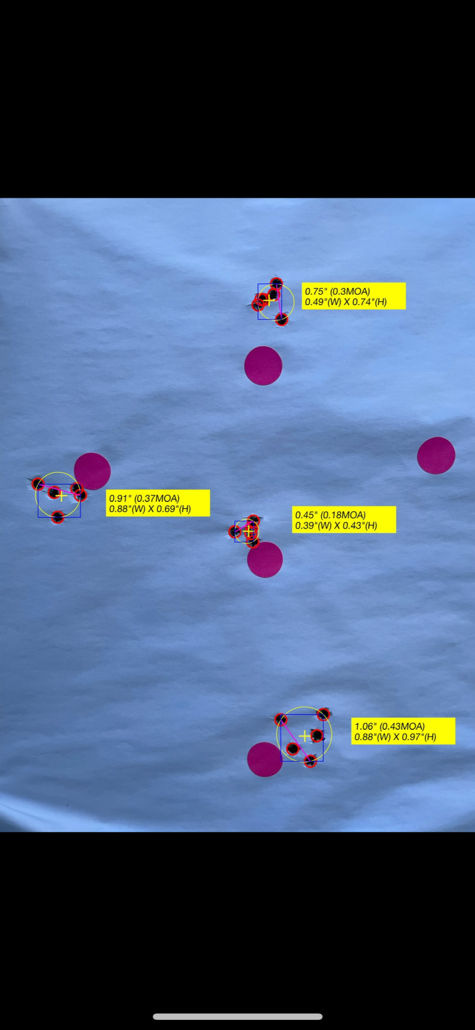

Developing a load for my new 6GT build. Proof 1:7.5 comp contour barrel, terminus Zeus action, MDT ACC, triggertech Diamond, TBAC Zeus. Have 30 rounds down it so far, posted the second two groups of 10. Berger 108 elite hunters and hornady brads. First group is 32.4gn varget and 40 thou off the lands. Second is 32.4gn varget and 60 thou off the lands. Group 1 I didn’t run the brass through my sizing die just took it straight to chamfer/deburr. Second I ran through my bushing die and expander button. Also used (I thought) better powder discipline, though I got a SD of ~13 on all 3 groups. I’m thinking from here I go back to 40 thou and try maybe bumping up 0.2gn powder. Or is it worth seeing what happens at an 80 thou jump? From what I’ve read with 6GT it’s best to go with big jumps during development. Any help is greatly appreciated!

I use varget and alpha brass. Berger 105s. Seems like you have some horizontal stringing in those groups? For sure in that last group. Shooting off bipod and bag?
Def horizontal stringing that’s why I was thinking back off to 40 again or take it further up to 80. Doesn’t seem like it’s happy at 60. Bipod and bag yes
The horizontal stringing is most likely you and not the load. Group dispersion should be circular with good fundamentals.

I’ve read that, but that’s a pretty dramatic change from one group to the other.

Thanks man. Maybe I’ll try 80 thou also. If that doesn’t run I’ll drop back to the 40 and mess with powders and fundamentals

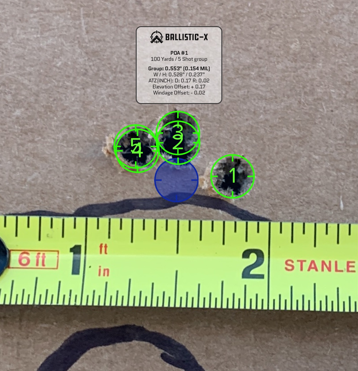

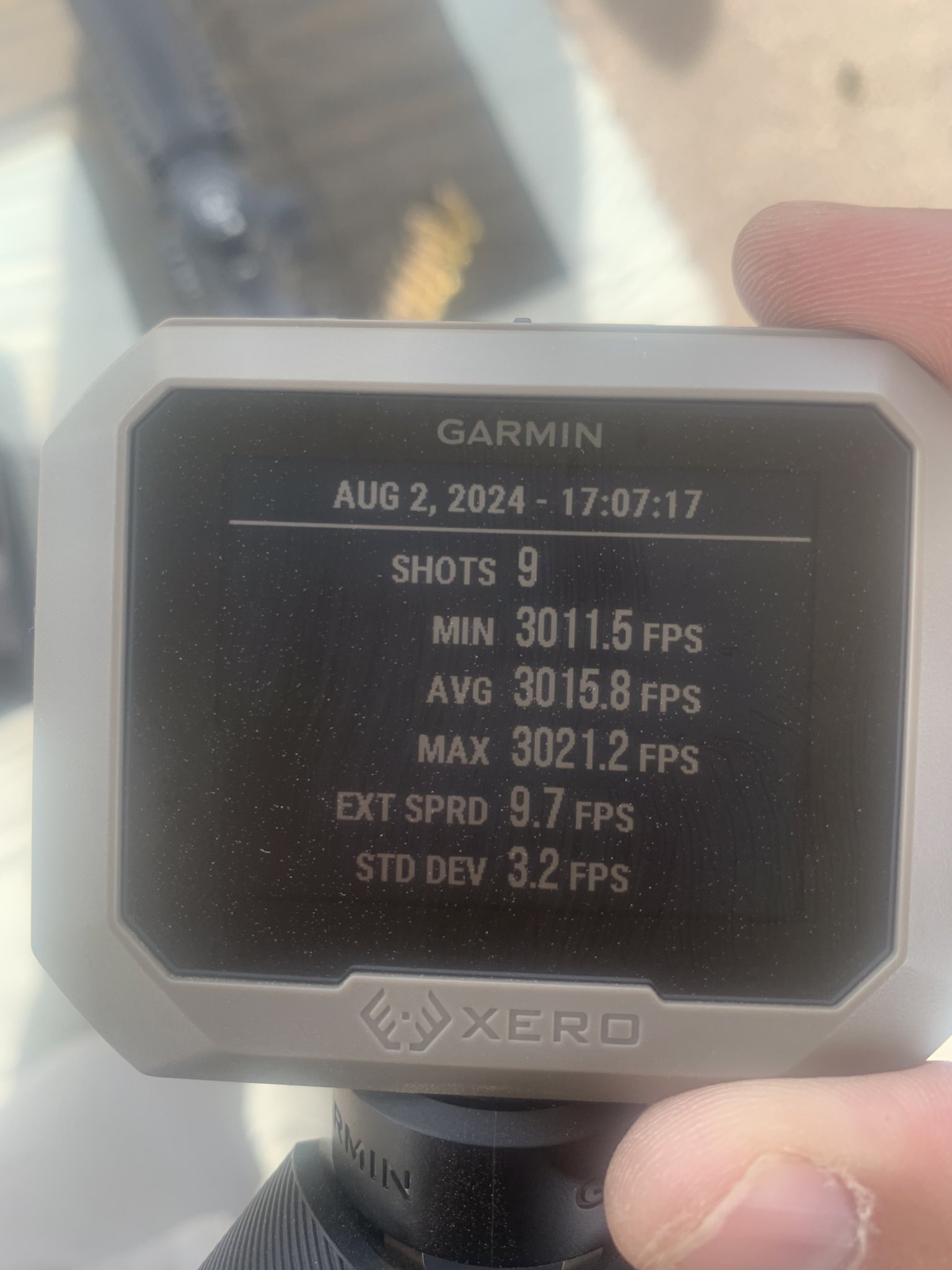

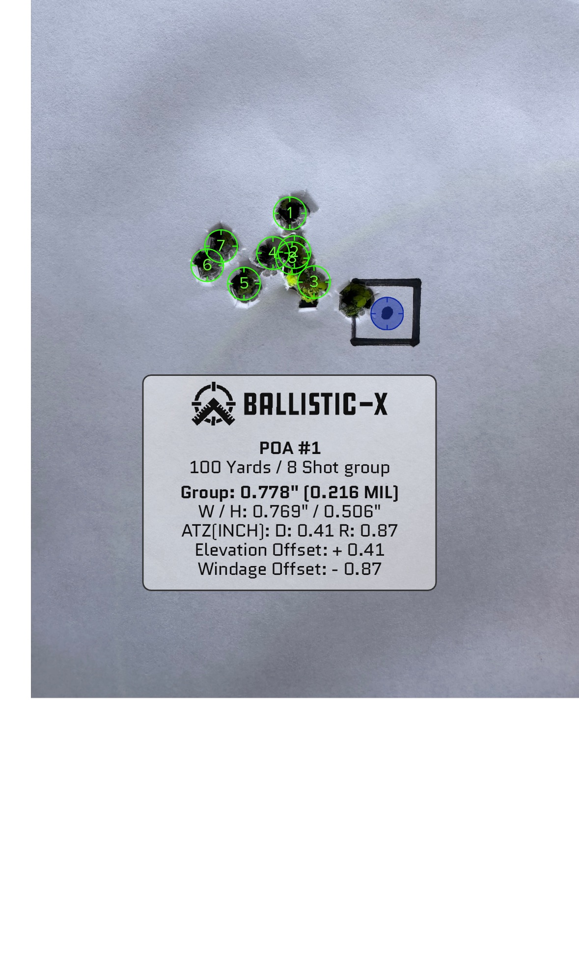

What’s your muzzle velocity, I’m running an impact with a 26” hawk hill barrel same twist as you and have great groups with 34 gr of varget, so I’m sure you can speed yours up a bit. That’s with 108 Berger vld’s.
With the same barrel on an Impact action I went with Berger 108’s and 34.3 of Varget which gave me an ES of 9fps and SD of 3fps with an average of 3015fps on once fired Alpha brass approximately .040” off of jam. For my abilities and novice reloading knowledge I was pretty happy with the results.
