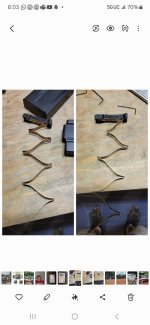

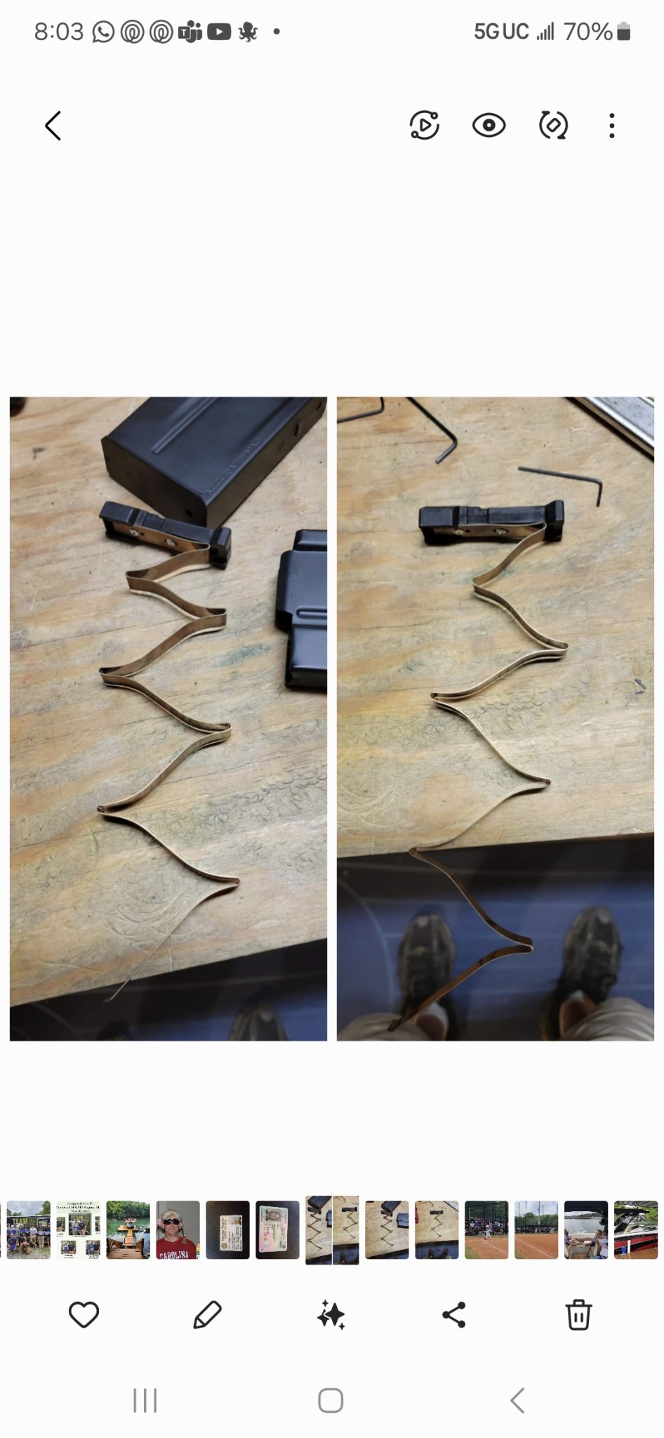

    Sorry for bringing such an old thread back from the dead.. but has MDT fixed the issues they were having with the 6GT? I have 6x MDT mags I used for 7mm-08, 308, and 6.5CM... I got my 6GT barrel and am throwing it on this weekend to go shoot in and run a bit through some positional shooting drills.... Do the 12 round MDTs work well when only loaded to 10? Seems to be the spring tension is the issue, or maybe get the extension kits and run them at 12 instead of 14? Anyway I can always steal my wife's AI and grab another so I have a couple 12 round AIs. an MPA feed lip tool I can use to mess with them a bit if I need too...
    I don't know if the did or not. The issue is the spring didn't put enough pressure on the back of the follower. I pulled the spring out and bent it to add pressure to the rear of the follower and never had another problem.
