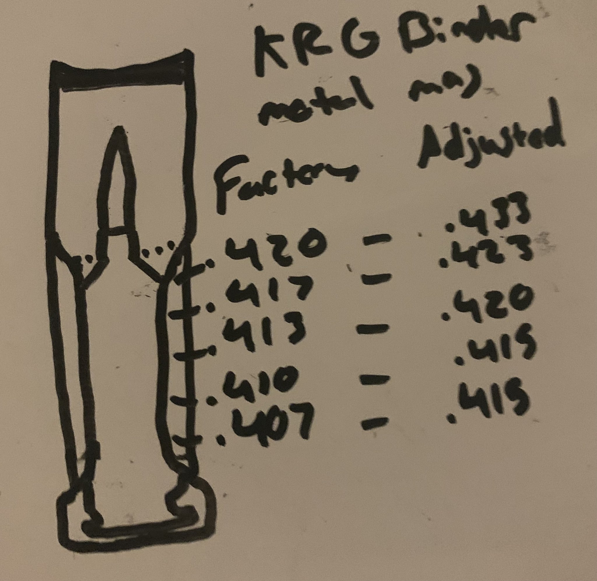

I like to knock the base plate off to empty the feeder out and get some sand paper and work on the inside of the feed lips to get ride of the shaper edge and take some bite out of em.
Then I’ll measure the widths for a baseline you can return to, bend the lips. Likely the front needs to be flared out a smidge.
