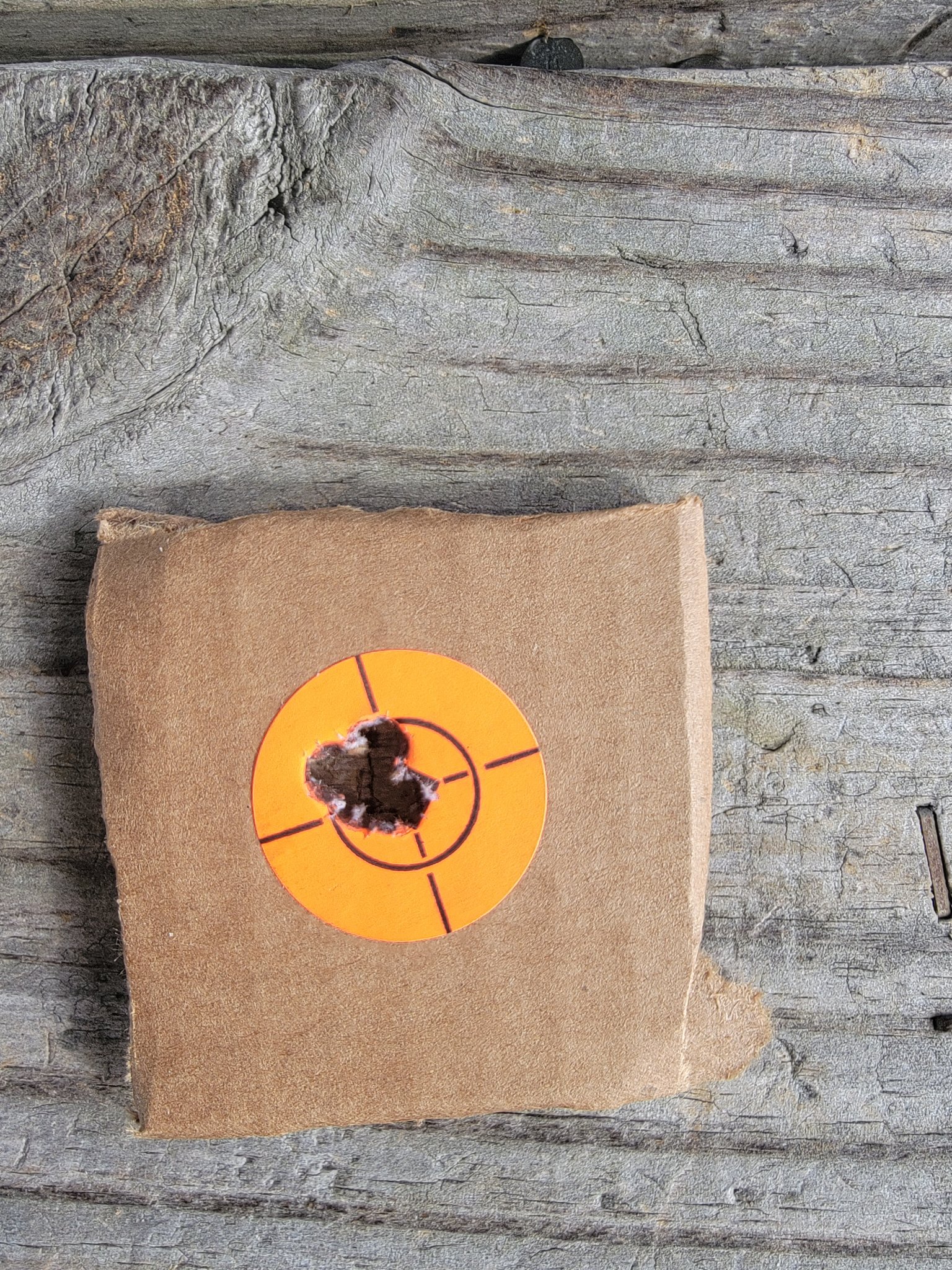

Picture is the group at 100 yards. Upper left bug hole is the 5 fastest while the lower right is the slowest. Don't know why the POI shifted. The test was to find a powder charge range and velocity only. More load development to come.

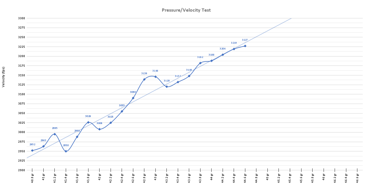

I loaded up a bunch more just to see where this all takes me. I loaded 10 straddling my velocity goal at .2gr increments. Then I kept going at .2 gr increments for another 10. Twenty total rounds 40.8 - 44.6 by .2 increment. I had scrubbed the barrel clean so I shot 5 fouling rounds first. Fastest velocity recorded was 3227'/s with the 44.6gr load. Bullet stayed together too.
Barrel seemed to be shooting a little faster today also.
Results are confusing to say the least. Velocities don't settle down till 43.3gr which is approximately 90% case fill. No pressure signs either.

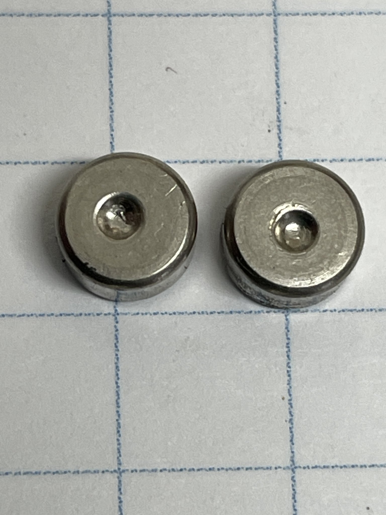

Left primer is low charge and right is 44.6gr @ 3227'/s. I faintly see minor cratering for the hotter round.
The chart shows a "wobble" around 2950'/s which is my velocity goal. I could live with 3000'/s but I don't wish to go any faster.
