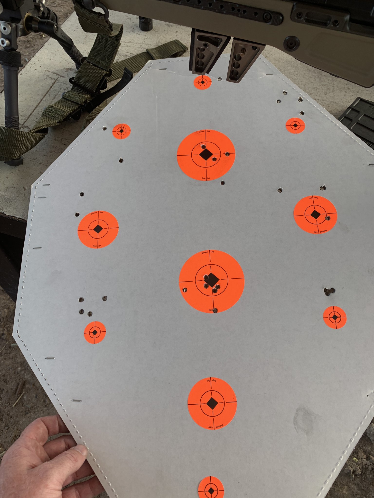

Here is a 6cm barrel target after 1100 rnds only using hornady 108eldm factory ammo.
The fire cracking was so bad even a set back didn’t help.
This was 100yds ?
This was 100yds ?
This was 100yds ?
God damn, bro... 1100 with Factory??
Out of curiosity, what barrel went out after 1,100 of factory ammo?
Bartlein.
Pretty typical of 6cm. It’s still running 3-3100 fps with factory ammo.
