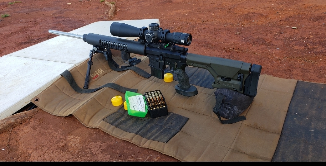

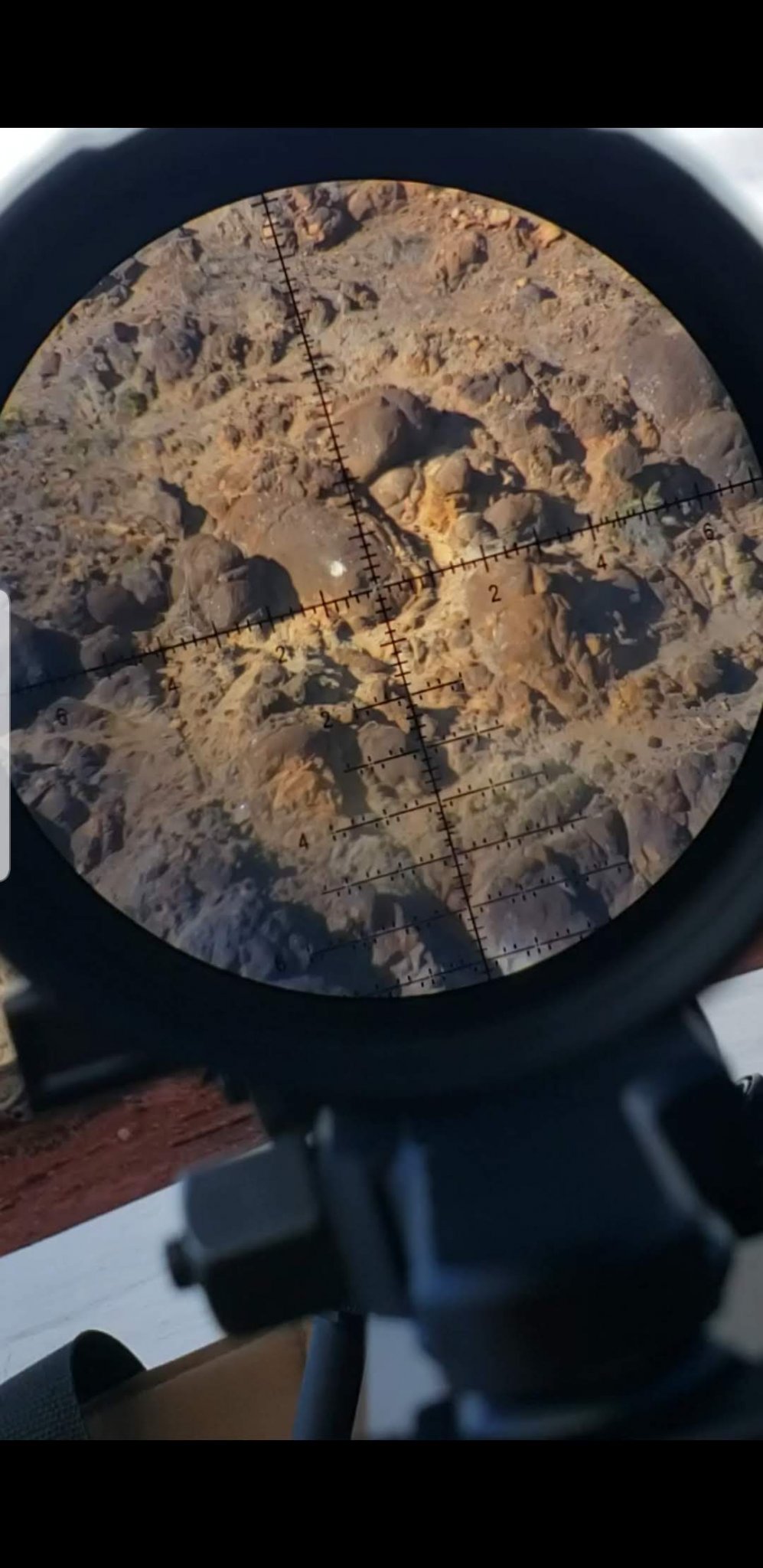

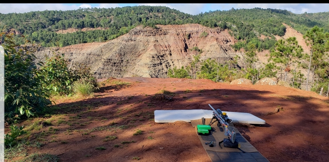

I got a 6mmAR turbo 40° with gain twist bartlein its very accurate at 600y
4 shots stack up on that 600y rock

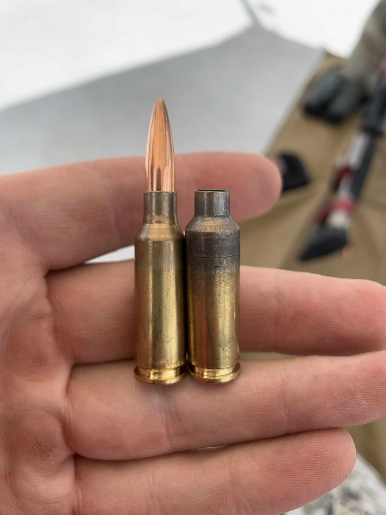

I've been shooting a Grendel and 6.8 since 2005 then several wildcats based off both. If you push anything based on Grendel brass it will swell to look like a belted magnum and the cases will not last long. IMO Norma makes the toughest brass. If you shoot a ton you will not like fireforming anything, stick with straight neck downs. Any cartridge based on the 6.8 will handle 58000psi easy. The Grendel 52-54000 without issue. 3-5000psi is worth another 100fps.
Not as much experience as you but I can’t say I’ve ever seen my lapua Grendel brass do that.

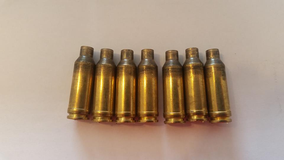

That photo actually came from the Grendel forum but I've had plenty that look like that and 1 that Ruptured in 6mmAR...don't try RL10 behind a 90gr Scenar.View attachment 7152485View attachment 7152488
Unless this brass was cooked when annealing, or defective to begin with, I can't wrap my head around why someone would push this case so hard, I'm saying there was something wrong - like using a powder not appropriate for the case ??? Looks to me like this AR was unlocking early causing the web to swell for whatever reason??? Adjustable gas block needed maybe and use of a normal pressure load.
Using common sense is all it takes when reloading, if there are pressure signs then it's time to back down, right??!!
I can honestly say this has never happened to me with 6mmART40 or FatRat.
