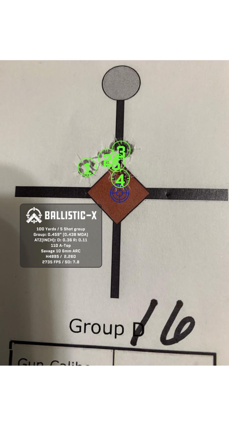

I started with the Bolt version first and now going to the Semi Auto route. In my Bolt gun: 24" Shaw 416R SS with 1-7 twist barrel. I found using H4895 for the 108 ELDM. Start at 26.6 and work up. Found a load (2770 fps with SD: 2.4) I found that H4895 for the heavier bullets worked better. Was not happy with Varget for the heavier bullets. Same results for the A-Tips.

Thanks for the input, opposite paths ending in the same place. I've used the IMR 4895 in the past but not H. Also on hand, and in the mix I plan on working with RE15, Shootersworld Precision, and Leverevolution. Lever's been pretty good in the semi, just not a big fan of ball powder.

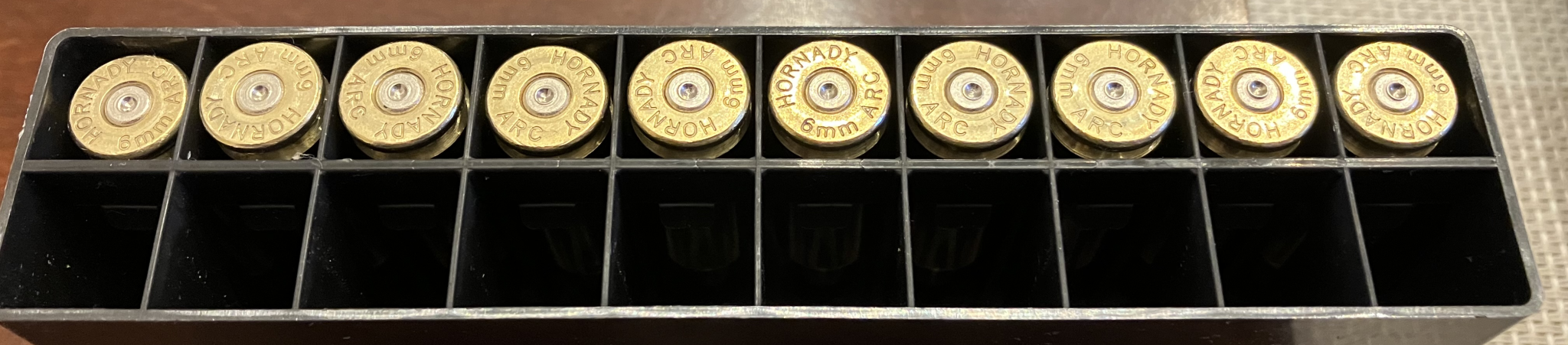

Here is the referred first work up with Varget, as stated it showed good promise. Watching them form as I was shooting, It felt like they were tightening up again at that 28 mark, maybe a little higher. Side note, brass and primer pockets were GTG at 28. Still nervous after running it through GRT

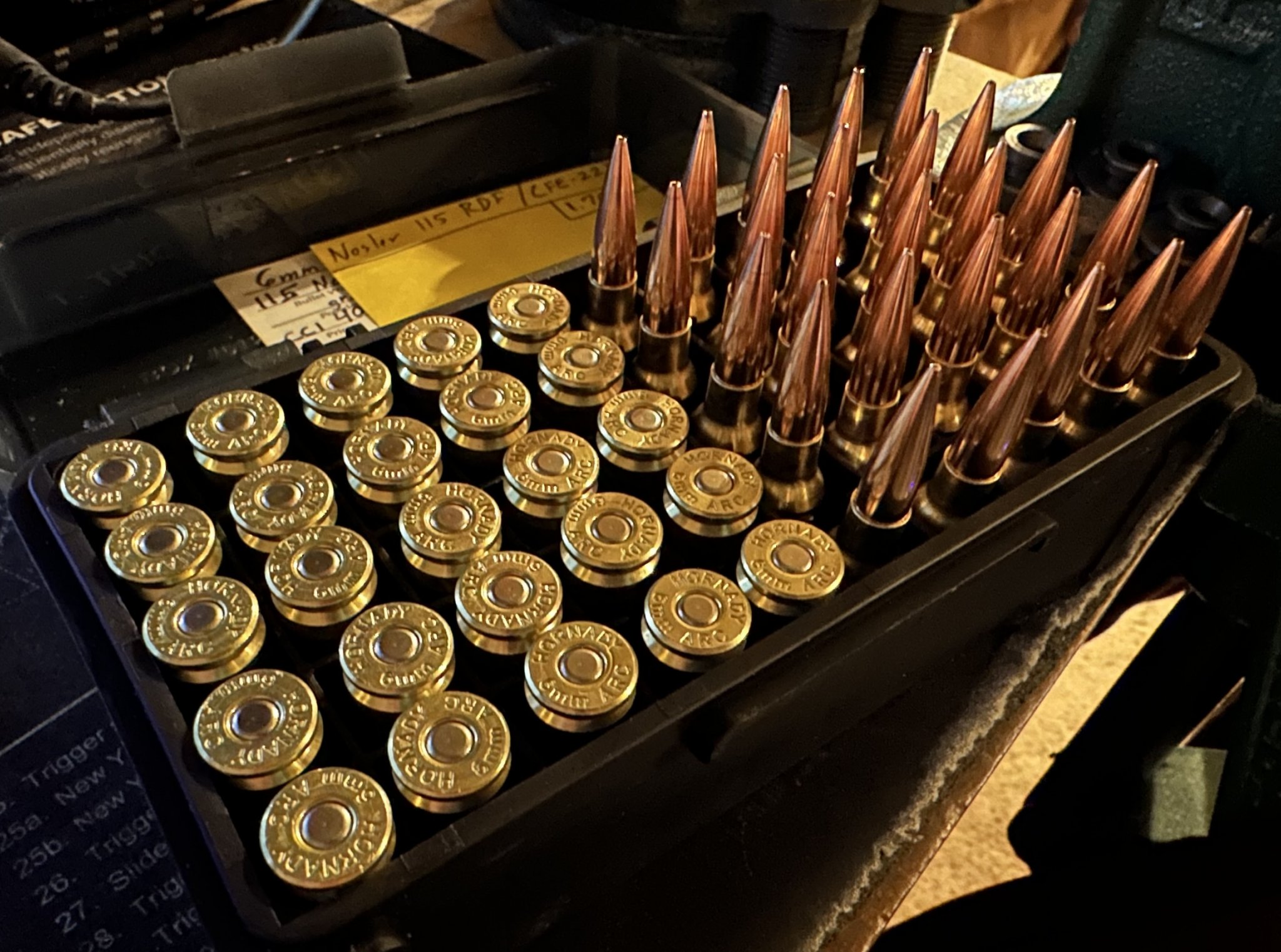

Midway came through for me, and the new (proper size) bushing showed up today. Got them all resized (again), and loaded up my first round of load development for my 16" Christensen Arms MPR. I'm running 1x fired and FL sized Hornady brass, CFE-223, CCI 400's, and Nosler 115 RDF's. I'm running all the way up to 29.0gr in 0.5 grain increments (first round of data is pressure baseline and finding a rough node pattern). I'll report back my findings.

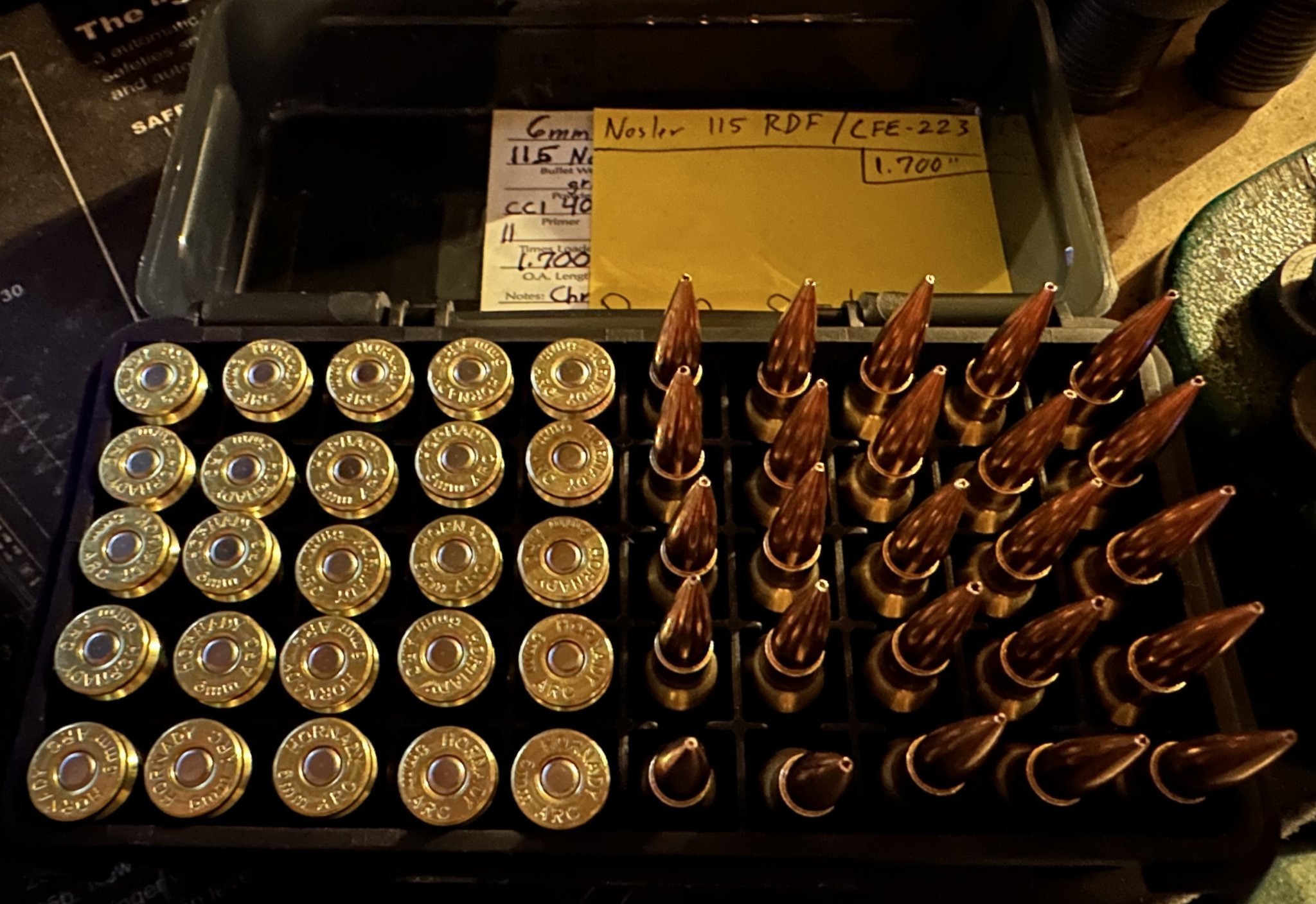

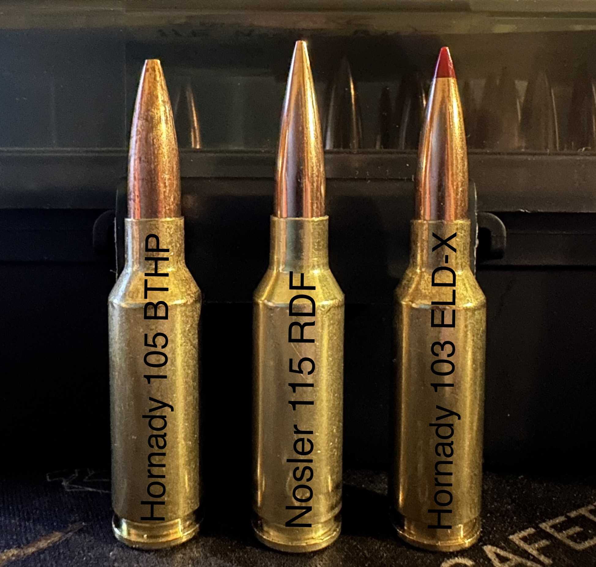

What load did you end up settling on? I figured the 115 class projectiles would be too much for the little ARC case.

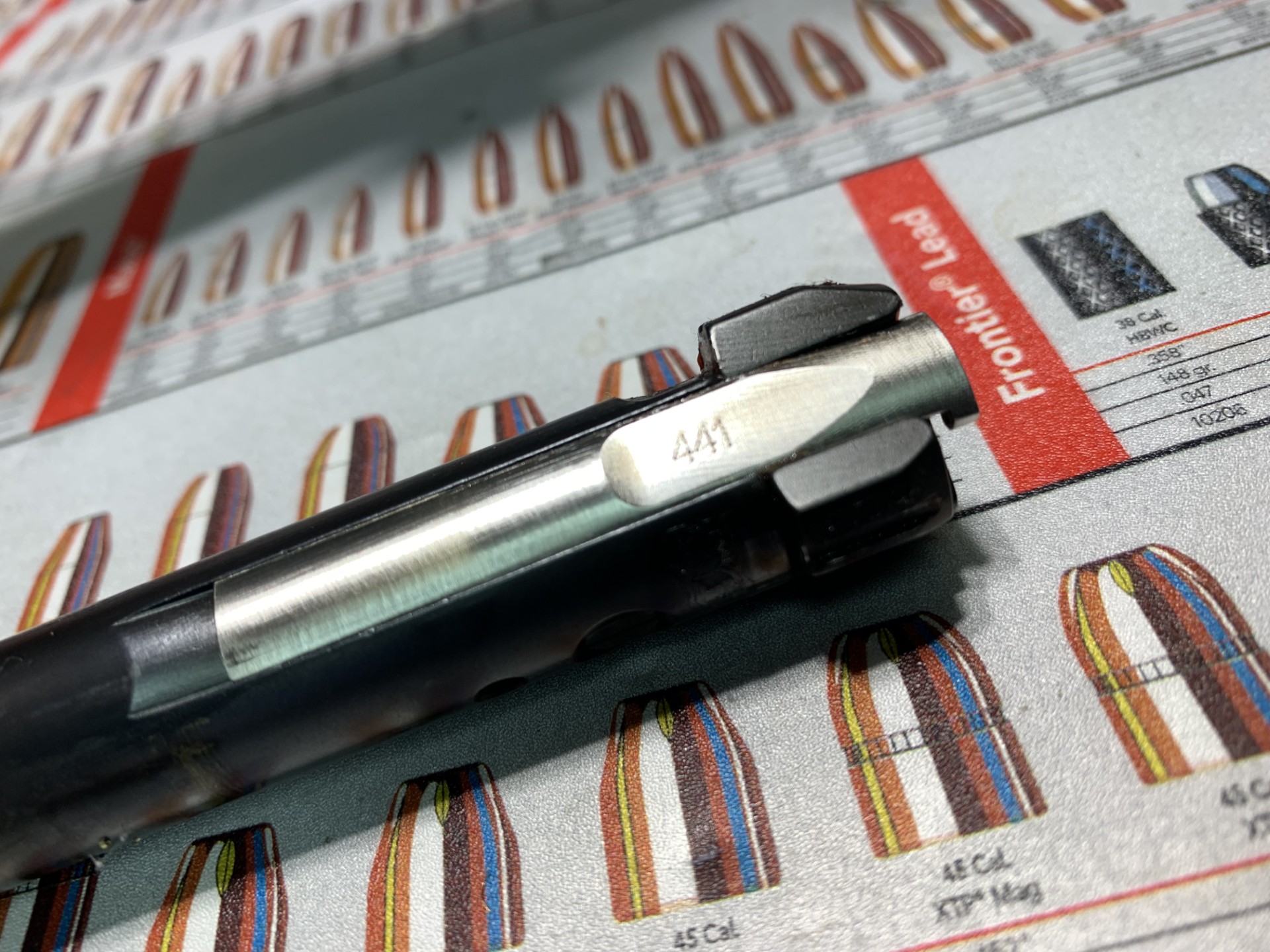

All Pre-de pictures ,but no one mentions what action you'll are using with the non normal {223 & 308} bolts
Most I know with bolt guns in 6ARC are running Zermatt Origin or TL3, Impact 737 or American Rifle Co. Coup de Grace. I went Origin.
There's a handful running Howa 1500 Mini, but those really limit chassis/stock options and you're stuck with their proprietary mag.
ARC Nucleus v2 here. With ARC and Zermatt It is quite nice having the ability to change bolt heads, also have the .384 and .473 for future caliber considerations
I run a Savage SA with the bolt head swap.
