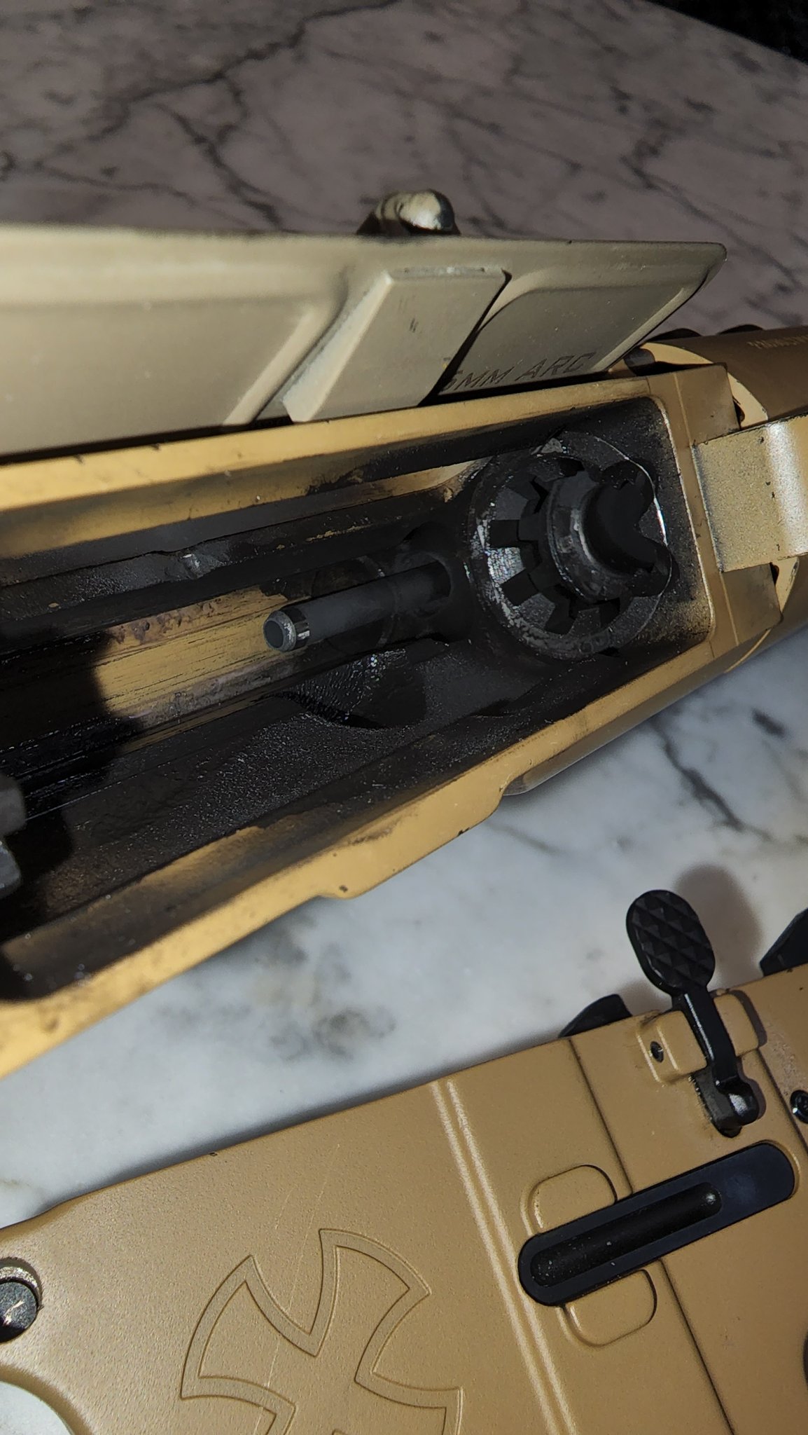

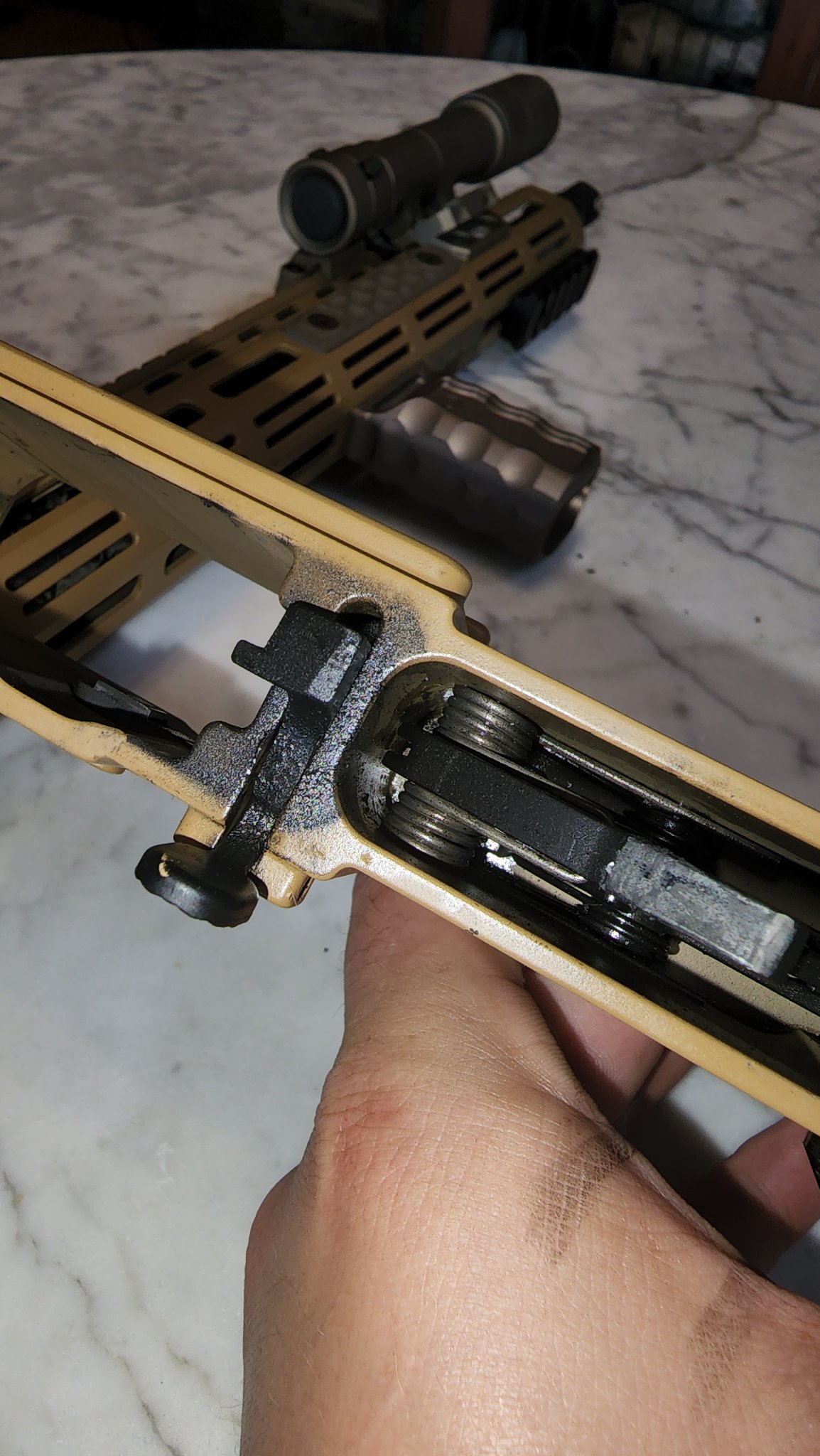

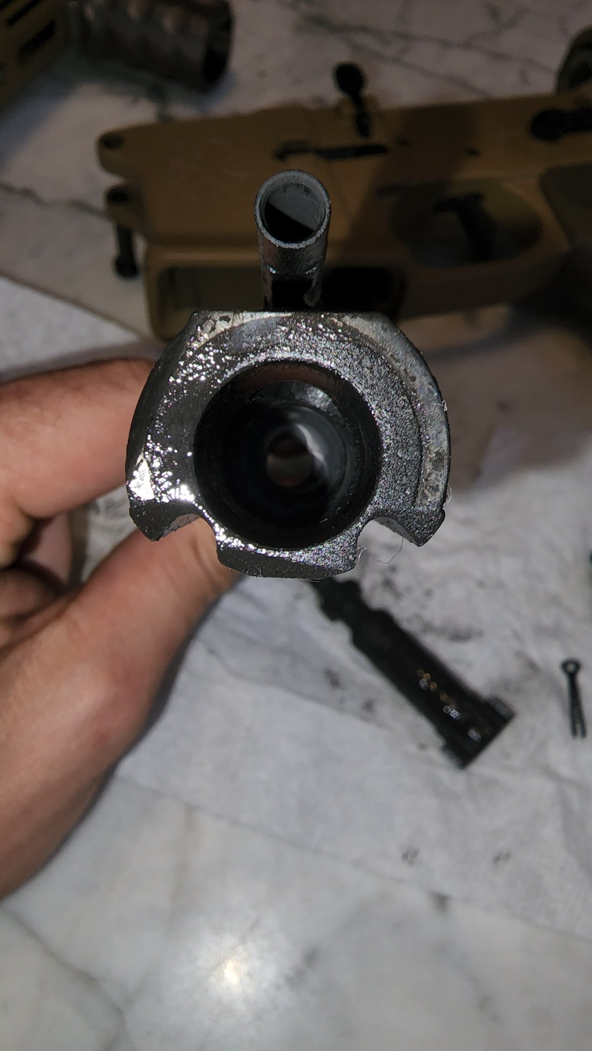

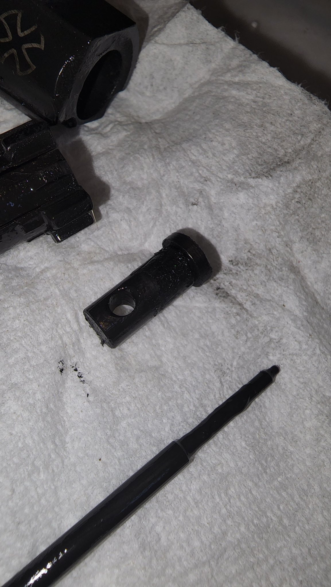

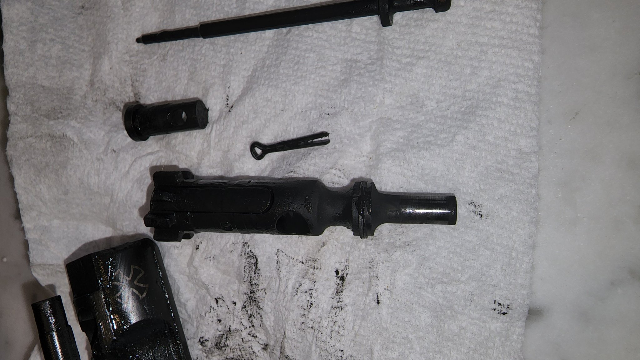

So, quick run down on the relevant parts of my setup:
- 14.5 inch Proof 6mm ARC Barrel, Intermediate Length Gas
- Superlative Arms bleed off gas block, 16 clicks (in bleed off) to run both suppressed and unsuppressed.
- Noveske Marked RCA BCG
- Geissele Super42 with H2 Weight
Gun is 100% reliable, absolutely zero malfunctions thus far. Exceptional accuracy, I truly believe the gun has 1/2 MOA in it if the guy behind it is up to snuff. Everything internally is 100% aligned. BCG, Bolt, Bartel extension, Gas key / tube, etc do not bind, snag, or anything.
All that said, this thing gets completely caked in carbon after about 50 rounds, see below:
Thoughts, experiences? I did reach out to Hornady today.

My 6mm Grendel is also quite dirty suppressed, but not nearly that bad. I think there's multiple factors here:
1. Short barrel is not burning all the powder.
2. The powder they use is on the dirtier side. -- Most of the powders that run the highest velocities in Grendel sized cases like CFE223 and LeverRevolution tend to be dirty.
3. The suppressor: back pressure shoots shit back down the barrel upon ejection.
4. Looks like you may be running it pretty wet, and some of the carbon and unburnt powder is sticking to whatever you're using instead of flying out the ejection port.
There's not going to be a great solution.
You could drop the suppressor if you're an unwashed heathen, or you could hand load using a powder that will give you are more complete and / or cleaner burn. I would also experiment with different lubes. I like Hornady One Shot in my ARs.
