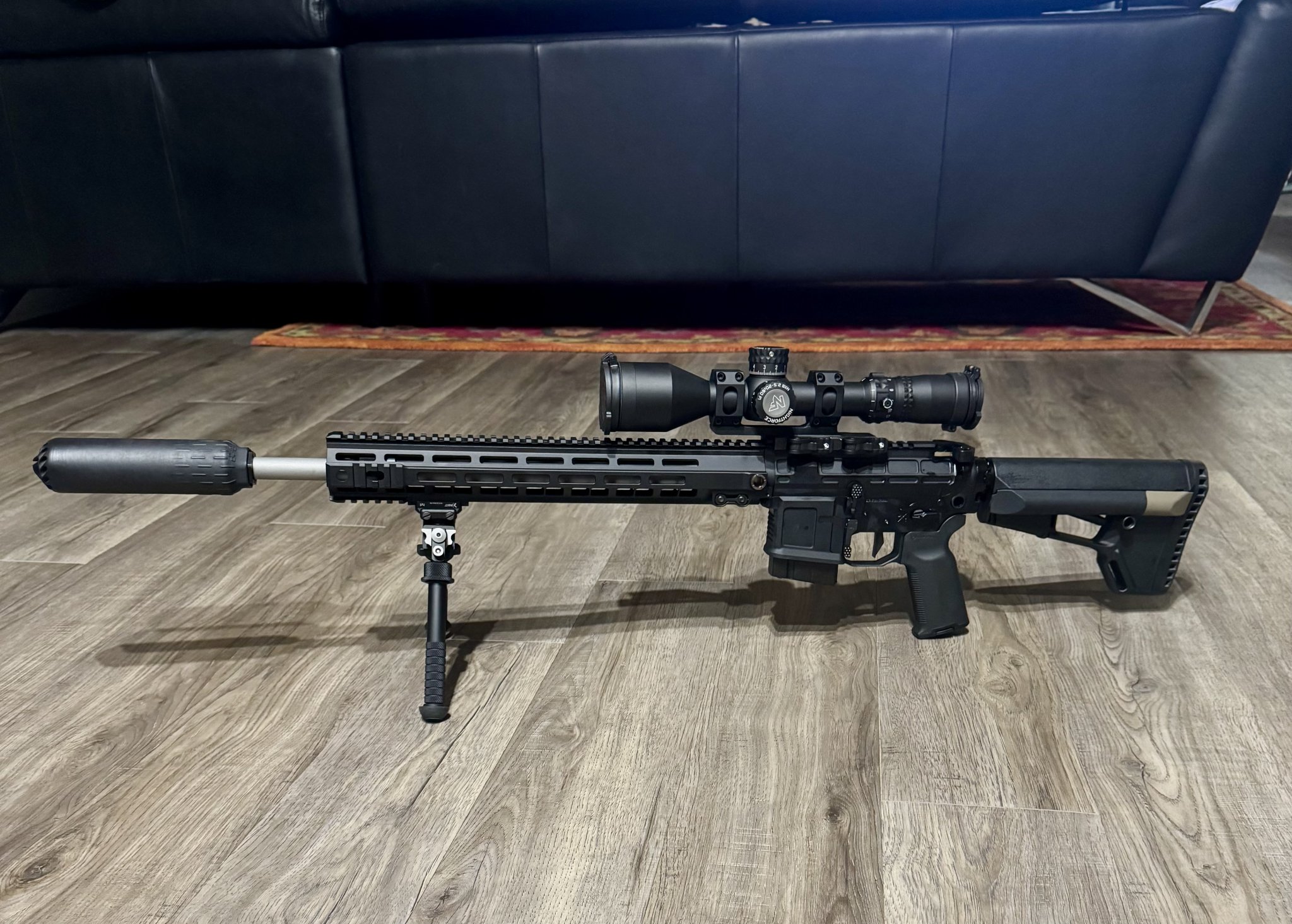

It’s been two years since I posted “I don’t see the allure of 6mm ARC”. I see the allure now. My collection is rather small but everything has a specific purpose (other than my 16” carbine gas Colt LE6920 with the MIL/LE restricted markings). I’m not really a fan, but can’t part with it or change it. I want to build another AR and I don’t have anything that is semi automatic AND ACCURATE past 1k yards. I’ve got a 16” 308 barrel for my SCAR 17, but it stays in the 13” configuration. My 14.5” piston AR definitely isn’t coming close to 1k. My MRAD especially in 338 is certainly capable, but a low recoiling AR would be so much fun. I know nothing about the caliber or who makes the best parts. So far I was thinking
Final build:
San Tan tactical receiver set
Geissele 15” MK4 rail
Craddock 18” RTR 6.5 Grendel barrel
Superlative Arms piston kit
POF roller cam pin
Geissele SDE 2 stage trigger
Magpul ACS with BCM MK2 buffer
JP enterprises rifle length spring
Fortis K2 endplate
Radian Raptor SD charging handle
Radian Talon safety
NightForce NX8 2.5-20 in an ADM mount
HUXWRX flash hider
Atlas V8 bipod
I was going to use a HUXWRW flash hider and use my Flow Ti 762 and maybe get the Flow 6mm if I end up really liking it and want to keep a can on it.

I read a couple threads and saw nothing but glowing reviews about the Craddock barrel. So I ordered everything this evening with the exception of the Superlative Arms piston system since it’s out of stock everywhere. This rifle (like all but the M82) will only be shot suppressed. I had planned to do the HUXWRX Flow 6k, but 6.5 Grendel is too big. I’ve already got a HUXWRX FLOW 762, but I leave that on the SCAR.. I’ve got a Hybrid 46 that stays with the MRAD… so I’ll need to figure out what I’m going to do with this one.. or if I’m going to start swapping cans.. maybe the HUXWRX Ventum?
Figured I’d update with the finished product. I went with the 18” Craddock RTR 6.5 Grendel. I had to heat the upper quite a bit to get the barrel fitted.
Of note, I had issues with the Superlative Arms BCG having significant friction in the upper. I lubed the BCG and upper profusely and worked the BCG about 100 times. There were some feeding issues when I took it to function check and zero the scope, but that could also be related to the newness of all of the components. I used Durham 10 round mags. After about 30 rounds it fed the last 5 appropriately and without issue. I need to put a lot more through it to determine its reliability, but it seems promising at this point. There was some denting of the brass at the shoulder, but nothing excessive. I saw numerous posts about the superlative arms piston BCG exhibiting binding in some uppers. The accuracy was excellent as you would expect from the components used. The gas piston was fully open and ejected at three o cloth with the HUXWRX Flow 762.
I updated the OP with accurate parts list.
Reactions: WeR0206
I also purchased a couple boxes of Lehigh 110 grain solid match and a couple boxes of 110 grain controlled chaos.
For break in I bought 2 boxes of 120 grain Scenar L loaded in Starline brass.
Final recap.. decided to go DI due to the BCG still having some less than ideal figment in the upper. I went with a superlative arms AGB and a T1 (I step heavier) buffer to hopefully alleviate some of the feeding malfunctions. I was surprised when the Microbest chrome BCG had worse fitnent in the upper than the SA BCG. I ended up using my Colt BCG which was smooth as butter. I also loaded all 3 10 round magazines a couple weeks ago and let them sit. The range was a total success. Not a single malfunction and all 3 five round groups were sub MOA. I’m really loving how smooth and effortless this rifle is. There is basically no recoil and you can watch the rounds hit the paper.
Unfortunately this leaves me with a SA Piston system… so I’m building my girl a clone of my 14.5” which uses the same system and is simply incredible.
So that’s the story. The SA piston system wouldn’t fit inside the DD RIS III rail on the 13.9” Grendel so that had to go DI as well so I’m waiting on new gas rings as I removed the gas rings while using the piston system.
