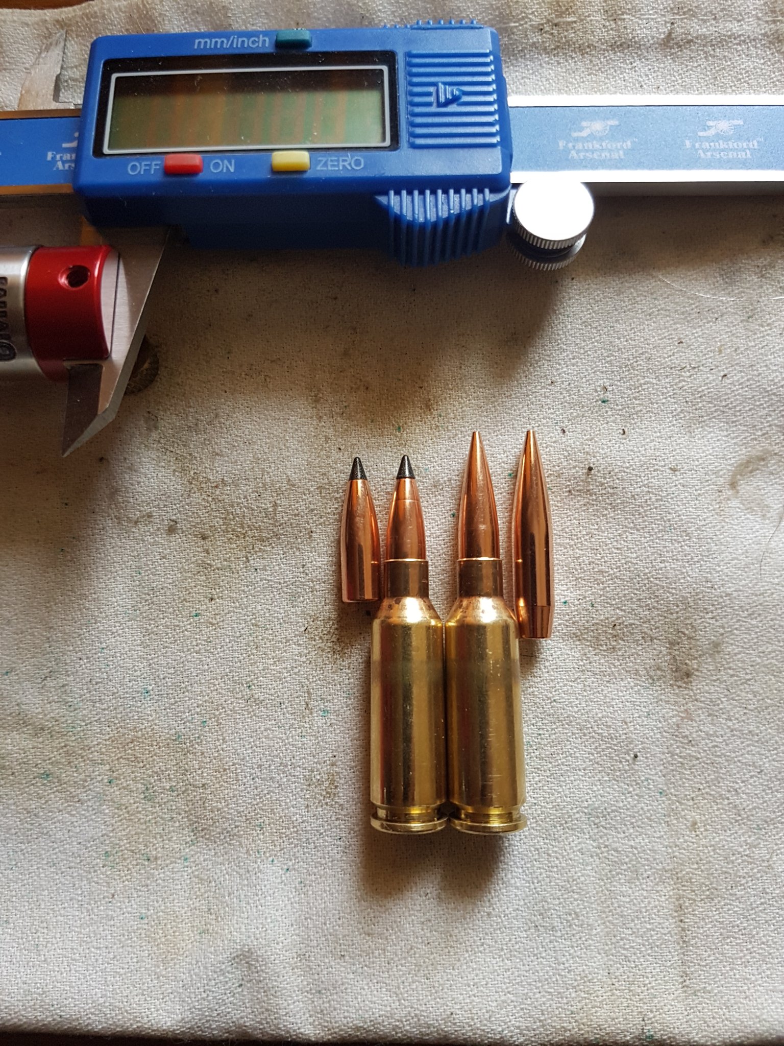

I have not shot the lightweight bullets and especially those specific ones the OP mentioned but just as an 'in general' I've shot bullets that hated jumping and I have shot bullets that LOVED jumping.
For a mag fed gun though start at the absolute longest you could possibly go while still fitting in a magazine and work your way in from there. I've had times when I was actually extremely surprised at how much jump some bullets like before they shine.
...the attached image of a Nosler 70 VG and Nosler 105 RDF shows you a relationship of their seating depths with similar CBTO measurements and their individual aspects to how much bullet is retained in the neck and intrusion into the powder stack. What CBTO measurement YOUR barrel's chamber will allow WILL BE DIFFERENT.
