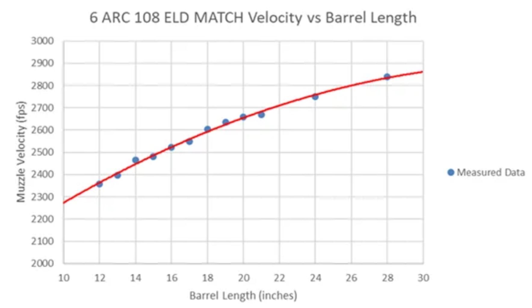

I'm not saying your wrong, but I've seen plenty of documented data showing 22" and 24" barrels with a 1:7 twist are more accurate than 18" or 20" barrels shooting at 1000 meter targets. The difference is slight, but there is a noticeable difference IMHO. Of course there are so many other factors to consider. I did see a video of a guy hitting 4" 1000 yard targets with an 20" barrel. I'm just trying to give myself the best chance to be happily successful.

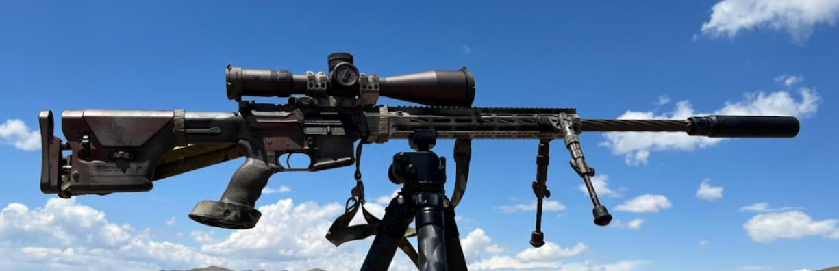

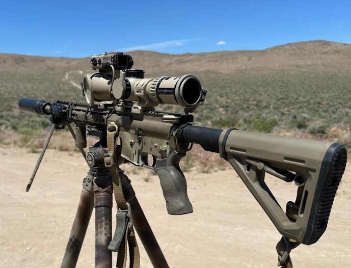

I've hit 935 yards...at night...with a 16" shooting 103 ELD-X (@SoundFx can vouch for that) It's totally doable - this cartridge is like .308WIN ballistics with .223REM recoil. The 26" barrel just surprised me because I couldn't squeeze anywhere near the velocity out of it that I had expected.
26" +2 Bartlein by Craddock
16" Proof carbon
Both are just under 1MOA rifles, but one is far more handy and versatile, while the other spends more time in the safe. A longer barrel usually gives you more velocity, but there's a limit to how long you can go and still see more velocity. With a full power 6mm Creedmoor, for example, that limit is closer to 30" but with an intermediate cartridge like the 6ARC it's probably closer to 20-22".
16" Proof carbon
Beautiful rigs! You've got me rethinking the 24". I'm starting to lean towards a 20". thank you for your advice.

Basically with my 6 ARC (24" barrel), with a suppressor the 'tuning process' was pretty much the same as tuning a suppressed shorty 10.5" to get everything running like I wanted. Again because I will not be changing uppers around on various rifles it was a non issue in the big picture. Also if I wasn't shooting suppressed (at all) I could make the regular rifle length work just fine with an adjustable gas block, but as stated before, that (for me) wasn't the case.
As far as twist rate goes, that's another thing I did. I opted for a 1:7 because from the get go I knew I would be primarily shooting heavy for caliber bullets. The thing with 6 ARC is it has a WIDE range of bullet weights that it can shoot. IF you want to shoot lighter bullets you may want to be mindful about twist rates, especially on a long barrel, IE velocity and twist rate determine RPM of the bullet. Again though, in my case I was planning from the outset to mainly shoot the heaviest bullets available. I planned from the start to 'have the option' to shoot those 115 grain bullets if I wanted to, but the opportunity to do so hasn't panned out yet (at the time the component shortage and demand was super high) so I just simply haven't bought any of those bullets yet.
If you do go with a 1:7 (with a longer barrel) you 'might' be chopping off the low end of the bullet weights from the line up depending on how hot you run everything. Anything up to I think 108 will be totally fine in a 1:8 or so barrel. Keep in mind that you should do your own research and figure up the RPMs of various bullet weights at which velocities for yourself. It's been a couple of years since I did it so I am working from a little bit of foggy memory in this post.

Not to derail the thread, but I am wondering what the 'realistic' velocity range someone could get out of an 18" AR platform with 108 grain bullets (all else being the same). As you stated above squeezing the velocity out of a longer barrel doesn't always happen, especially when limited on pressure. I don't like to run super hot loads so on that basis you and I have similar experiences regarding velocity 'advantages'.
Awesome info! This will be a dedicated bench gun and I will be using my existing Spikes lower and I don't want to mess around with it if possible. I don't plan on shooting suppressed. But I definitely plan on primarily shooting the heavier bullets (105 & 108) as well. X-Caliber doesn't offer a rifle +1 option on the 24" barrel. Seem like a rifle +2 with an adjustable gas block is the way to go for my application. Lots of documented data supporting 24" with a 1:7 twist for the 6mm ARC as the best way to go for consistent long range accuracy. There are plenty folks using shorter barrels with slower twist rates and doing well at 1000 meters. Doesn't mean that is the best way to go for optimal accuracy IMHO. Any thoughts on gas block journal length? Seems like 1" is the popular consensus, although the default for the X-Caliber barrel is 1.92"
I will send you a PM in a minute so please check your in box.
If I were doing it over again I would not go 24" on the length. 20" would probably be the best of all worlds.
The best I could do with 109LRHTs out of the 26" barrel was 2718fps and that was pushing LVR pretty hard. I did get closer to 2750fps but was definitely getting pressure signs. The same load out of a 16" barrel was 2605fps - so barely 100fps lost with 10" less of barrel - that's nuts. So my guess is the ceiling for an 18" barrel with a 108gr bullet is probably close to 2630fps, which is still really damned good performance out of a small frame AR with an intermediate cartridge.

Another D. Wilson converted Proof Carbon 6 ARC user here. I have an 18" with the Rifle +1 and I think it's about perfect for lying out prone and shooting to distance. I wouldn't go any shorter than Rifle length gas system unless you're going to run a 12.5-14.5" barrel. I am getting 1/2" groups with factory Hornaday loads, the 80 VT's and 108 ELD-M's specifically. I have no intentions of hand loading for the 6 ARC.
